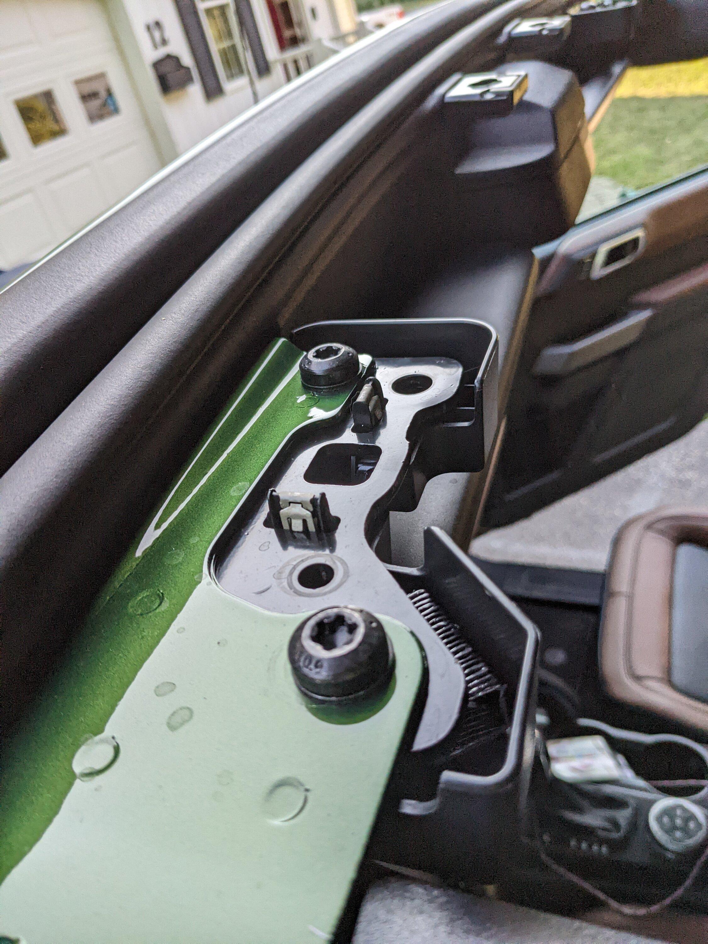

Try adjusting the brackets that are about dead center of the 2nd row windows. I've had my Bronco since November and have had it down about 20 times and never had any trouble, but it started doing the exact same thing as yours. I have the JTops mesh top and you have to remove those 2 brackets every time you install and take off the mesh. Well apparently the last time that I did it, I did not have the drivers side bracket in the correct position. The holes are slotted to allow for adjustment and my top requires them to both be in the furthest back position (the pin that comes out the side of the bracket needs to be pushed all the way to the rear of the vehicle). I messed up and had 1 all the way back and the other all the way forward. Took me several days of cussing the soft top before I realized it was my screw up. Took about a minute to slide the bracket back using the included tool kit and problem gone.

I adjusted these bolts. Loosened them, got them in place where I could open/close easily, and then tightened. Both sides are the same now
