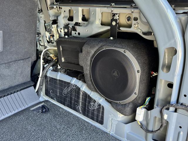

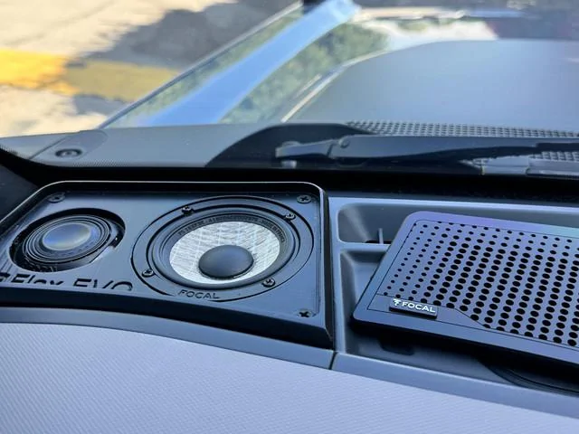

Similar for my Wildtrak, but I went with Focal Flax EVO 3-Way components, Flax EVO coaxial speakers in the rear, a JL Stealthbox, and AudioControl amplifiers because I have a much better understanding of how to use their DSP software.
Completed the installation myself. No B&O system to defeat, so integration was a bit less complicated. 6 hours for amp integration, and another 6 hours chasing and installing speaker wiring for the components.

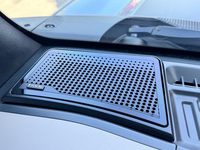

The MTI dash plates are nice, but could use some refinement, especially considering they are custom order, and not pulled off a shelf.

Great setup! Thanks for sharing. How do you feel the sound deadening affected road noise when the sound system is off? Was it worth the hassle of taking the seats out and everything?
Was the rear sound shield worth it as a standalone upgrade? I'd like to try and reduce road noise and am considering doing this before installing a drawer system, but I haven't seen anyone mention that it makes an actual difference
In my experience, it is more feel than a measurable reduction in ambient sound when in motion, and measuring decibels while in motion is part of the problem. The biggest offender in ambient sound is road and engine noise penetrating the firewall, the modular roof, and lack of aerodynamics.
Dynamat (and others) dampen the sheetmetal vibrations transferred into the vehicle from sharp potholes, rough terrain, typical city streets, etc. It dampens and transforms the sound, and changes how that sound reaches you, both audibly and physically.
Compared to the Raptor version, I doubt much (if any) engineering went into sound-proofing the Bronco as opposed to simply manufacturing it to prevent the elements (water and rain) from penetrating the cabin.
When you pull apart the rear cargo area, pull the cargo box, and find yourself looking at the rear axle, and can actually see the rear wheels on the left and right side, you know what you're working against when you start layering the sheet metal with your (insert brand) material.
In closing the tailgate and doors, you get a very nice thud instead of a slam. If you layer the flooring, it feels solid when you step into the vehicle, not metallic. Play music, instead of the sound bouncing around and partially escaping the cabin, the music completely consumes the cabin.
honestly I think it might of reduced some of the noise from the road. But removing the seats I don’t think is worth it. The trunk I went over board. I did two layers and a third layer on the back of the trunk panels. I still haven’t done the doors which I heard the sthe the most important part. Only reason I did the trunk was because of the added subs to stop vibration.
Would I do it again? No probably not it was a b****. But if I were to fix the wind noise from the crappy bronco roof then 100% I would sound proof the car and even go more overboard. The metal on the bronco is very thin.
