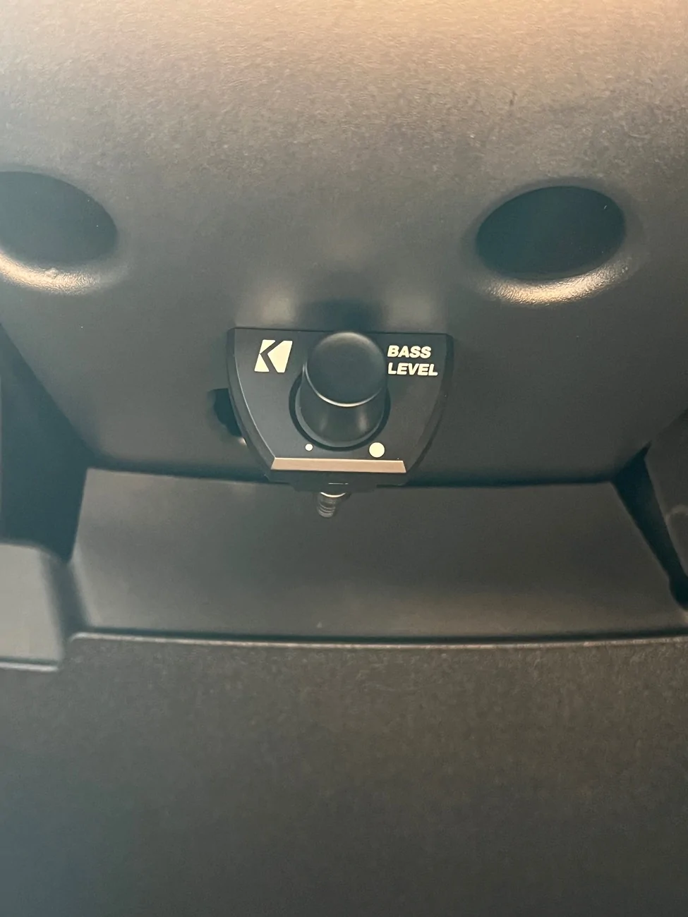

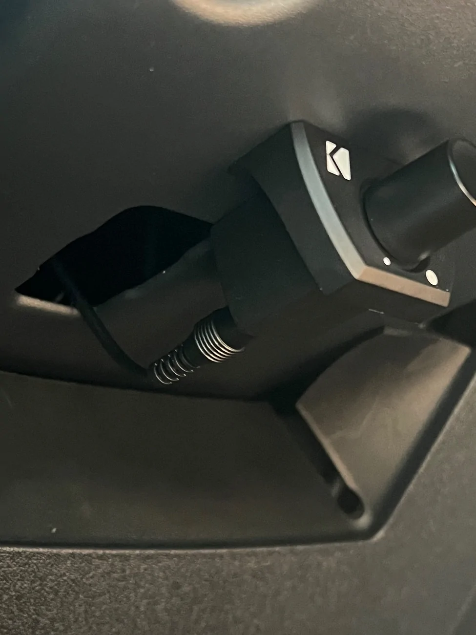

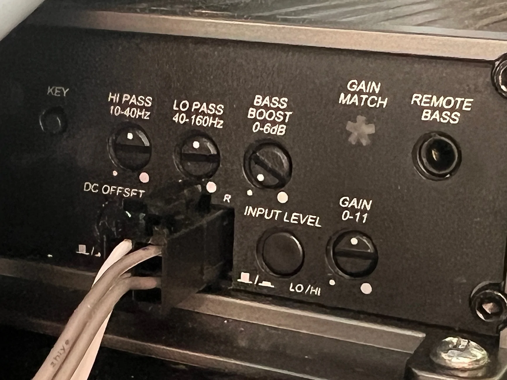

This is a picture of my amp settings using the Gearshade square L7T-8 subwoofer. I do have the bass knob which is key to this setup. It’s unplugged in this picture so you can see the gain setting. I mounted the bass knob under the steering column. There is a square cutout under the column which was perfect to run the wire and if I ever remove it, the 2 small screw holes will never be visible. The kicker key amp mounts directly on top of the Gearshade box. Pretty impressive sound I’ll admit. Takes a good 2 weeks to break in the subwoofer. Hope this helps

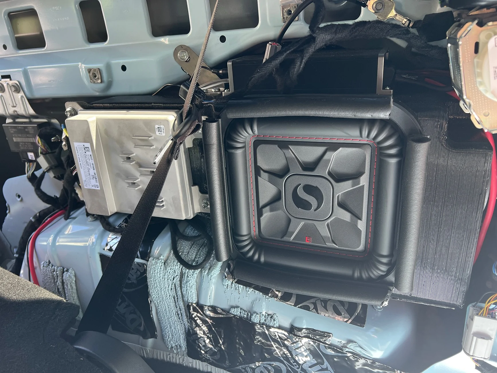

@irishmurph01 - I believe that Gearshade still has a place that mounts the B&O amp in a dedicated location on the subwoofer box that is separate from where I have the Key 500 mounted. On the box he sold me, the B&O amp mounts on the side in front of the sub in a dedicated indentation. The Key 500 mounts on the top of the box also in a dedicated location. Hoepfull that is the way his newer 10 inch sub box is designed. Sent a pic of mine where you can see the 2 amp mounting locations.

Nice ! Good to know there is space to change over to other amps at some point (should I decide to dump more money into this thing) :D
