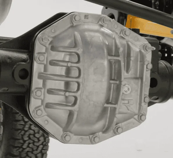

the problem i have with the vid is that he put a piece of flat lexan on to the cover and didn't account for the internal ribs or, and i am just guessing here but from watching it, it also looks like he didn't account for the actual depth of the flatback cover with the ribs.
Oh absolutely! Its typical advertising from a competitor.
Also, lets see his with a clear back.

This fully explains why I was able to get 317,000 miles out of my 2000 Explorer and 327,000 miles out of my Expedition without any differential problems with the stock covers….. In spite of what this dink says, the gear oil does flow around the ring gear quite well, in spite of the cover geometry. Sudo experts ….. Climate change anyone?????

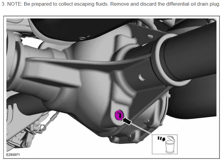

Why are you looking on the rear diff cover for the drain plug?
Typically the drain plug on Dana 220's is fore of the axle, below the drive shaft and on one side (generally the drivers side)
Via the M220 rear diff on the Ranger:
https://www.therangerstation.com/ra...ana-m220-rear-axle-fluid-change-instructions/
That simple change procedure is handy, do you happen to have the P/N available for the drain and fill plugs which the instructions say to throw away?
yup. Just google Dana M220 drain plug part number and you got yourself a dozen options for vendors.
Personally I just reanneal the plug and you'll get 2-3 uses out of it as long as you're using a rosebud or proper torch.

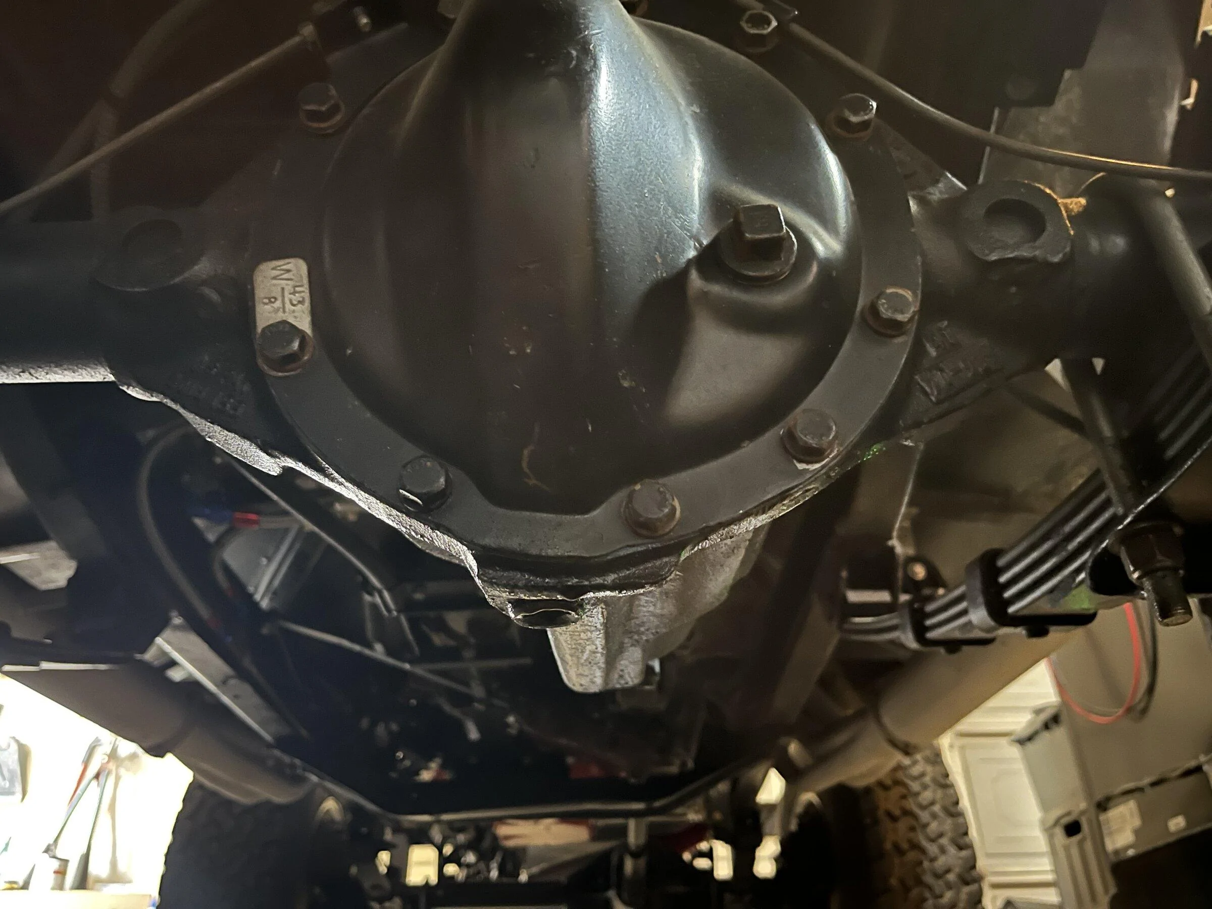

1940’s Dana technology….. A drain in the housing!!!!!
A 1/2” square socket drain plug so the rocks wouldn’t render it un-removable. And as you can see, it’s been over a LOT of rocks.
Check out the gear ratio 43:8 …. 5.375….. A good ratio for rock crawling and winning a ground war (farming?) .
