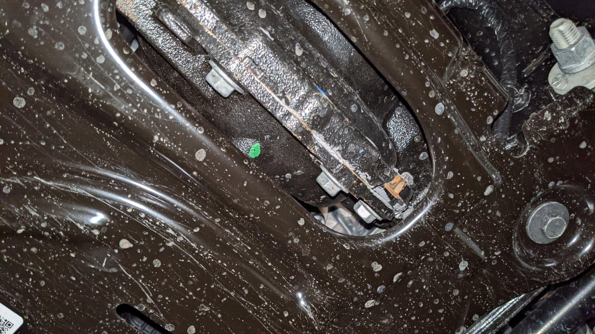

Looks like you'll have to drop the skid. There's a bit a of a cut out in the skid and you can sort of see the drain and fill ports, but doesn't seem like I can get a wrench in there with the skid on. I have a bit of green marking on the drain port but struggled to get a good pic of either.

Yeah, that's what I saw as well. I was afraid of that.
The rear differential was perfect and so was the rest of the fluids. I'm not equipped to drop the skid to check the front diff. Engine oil is good. Transfer case is good.
I'm not even sure if it needs to be checked. Don't know where the breather tube is and Ford doesn't list any maintenance needed after fording.

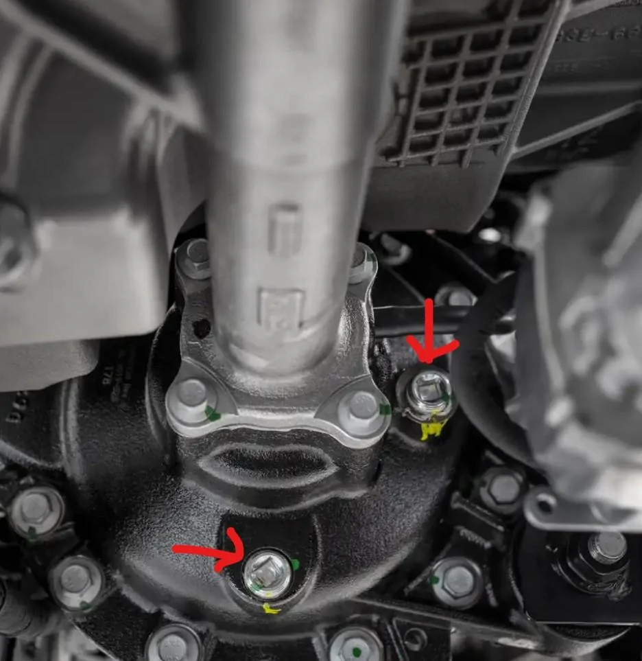

You are looking for these. Top is fill, bottom is drain.

Yeah. Entire skid plate is in the way.
The good news is no water entered anywhere. Everything was perfect. Can confirm the Bronco can handle maximum fording depth.
