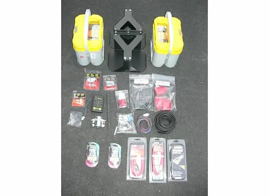

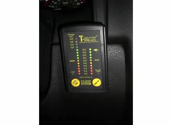

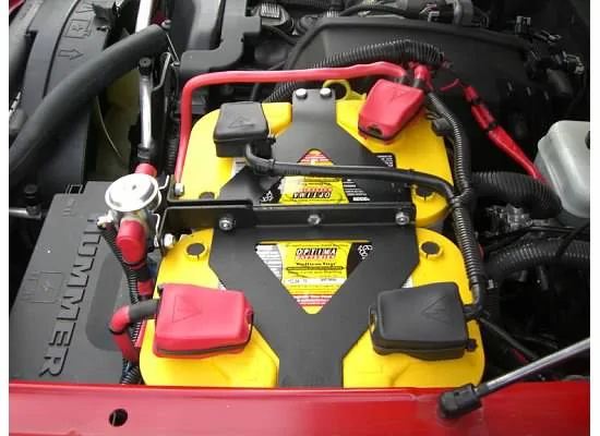

I have not even lifted the hood yet on my Bronco yet, but I did design and build one of the first dual battery set ups to shoehorn into an H3 Hummer. I kinda look forward to the challenge, but I am more then willing for others to take on the challenge and make it easy on me… LOL
