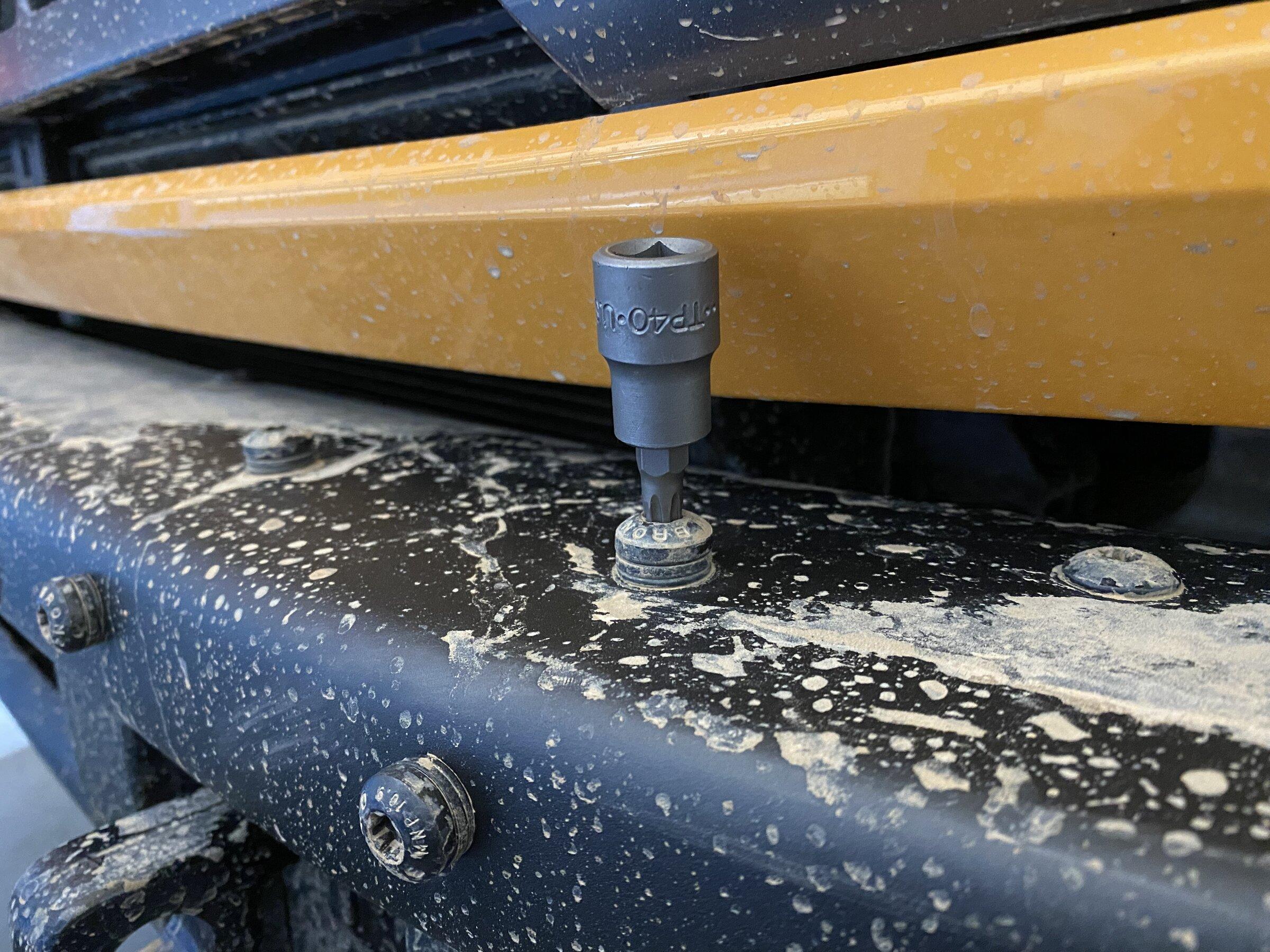

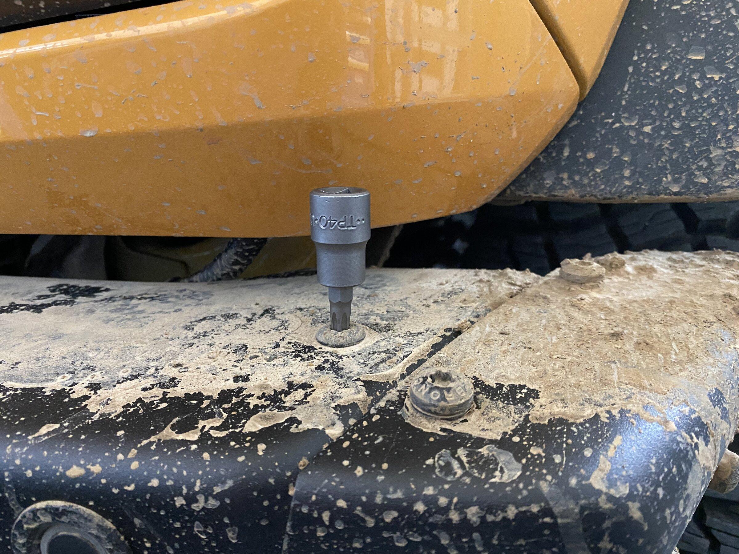

The bumpers are NOT Torx PLUS, just regular Torx!
No they are not, they are regular Torx!
Negative, my friend.
The Bronco bolts on the Heavy Duty Modular Front Bumper are TP40 (Torx Plus 40). A standard Torx 40 bit (T40) and a TP40 bit will both fit in a TP40 bolt, but the T40 will fit loosely and is more likely to cam out, so is often used in field repairs if the proper tool is not readily available. The TP40 bit fits better and should be used, if available.
The photos below confirm that the Bronco bolts are actually TP40, since a Torx Plus bit will NOT fit in a standard Torx bolt. (Apologies for all the mud.)
Ford Bronco Does the included wrench tool work on the modular bumper? C1719FE4-A2B2-4FAB-8507-7672586261D1
Ford Bronco Does the included wrench tool work on the modular bumper? 9A6FD9C0-D157-442E-AE55-AB3522A64CC9

I agree that Ford used a mixture of Torx and Torx Plus fasteners throughout the Bronco, and the correct bits for the beauty ring bolts on the Sasquatch wheels are standard T45. (I have personally used my own standard Torx T45 bit on them when I removed them.)
However, both this thread and my post above are specifically addressing the Bronco bolts on the Heavy Duty Modular Front Bumper. (Go back and read my post again, and then read the thread title again.)
If you are still in doubt, feel free to prove me wrong by posting photos of a Torx Plus TP40 bolt NOT fitting snugly in the Bronco bolts on the HD Modular Front Bumper.
