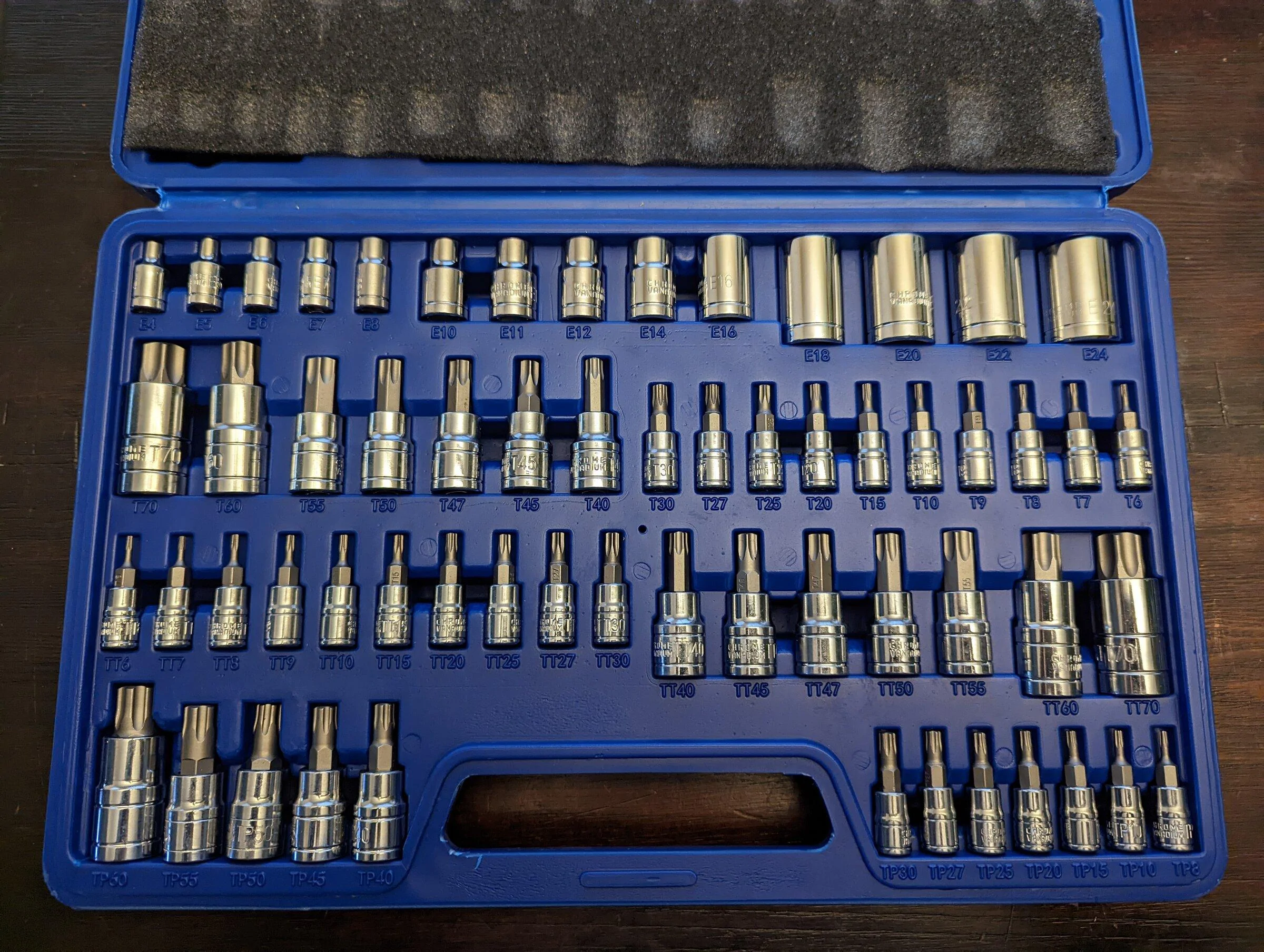

i just ordered this for my mod bumper and i can't even get the TP40 bit into the screw on my 24 wildtrak because it's either the wrong shape or too big
wtf is going on here? TP tamper is different than TP?
my bit is stamped TS40
of course this chit can't be easy. so much misinformation regarding something that should be cut/dry easy. the listing even says it's TP.
https://www.amazon.com/dp/B07TC79LVH?ref=ppx_yo2ov_dt_b_fed_asin_title&th=1
what can i even use these on with the bronco, anything?..it doesn't work on the mod bumper and i'm about to return it.
somebody else bought this for the bronci and gave it a 1 star.
they said to buy this. will this work or do i need another leap of faith?
https://www.amazon.com/Neiko-10086A-Tp8-Steel-Socket/dp/B004UC9WJE/ref=ast_sto_dp_puis?th=1

Yup.
All different. TS is probably the security bit
