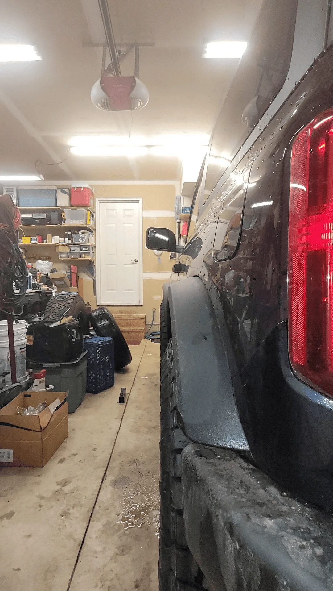

I tried, but options were non existent for a +35mm offset wheel with the proper 93.1mm bore when I was shopping for wheels. I can find +30 (Sasquatch wheels and RTR) or +25 (Icon), but +35mm is the sweet spot for my tire tread sitting just inside the edge of the non SAS fender flares while the rest of the sidewall pokes out.
You’re correct. It‘s really hard to find a nonstock wheel in a factory offset especially with the correct center bore.
Most want lots of poke.
The hubcentric adapter rings will work if they’re machined correctly……. I expect most are.
I’ll admit that I’m probably more particular than I should be on this subject.😉

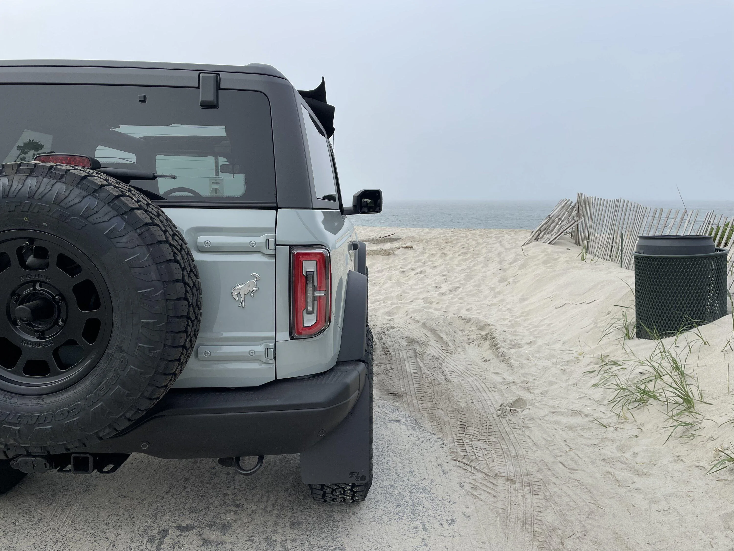

More proof.
Method 17x8.5 +35
Toyo 35 x 11.5-17
OC AT3
