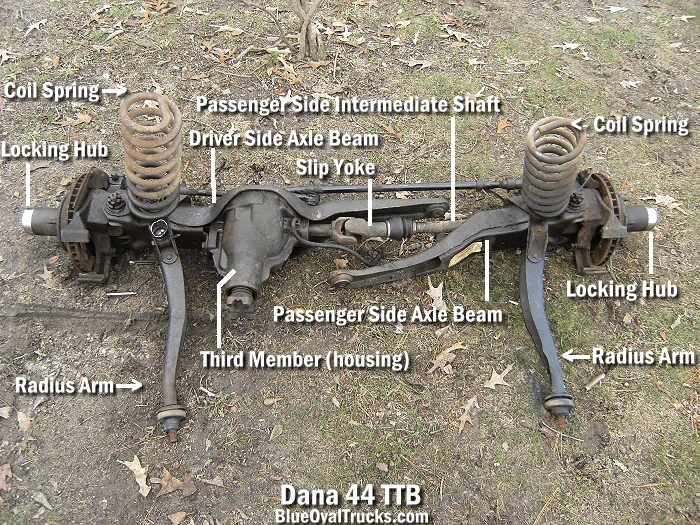

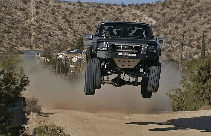

F-150 used the Twin Traction Beam suspension design through '96.
Ford Bronco Does SAS package now come with front locking hubs? 1659554241535
https://www.motortrend.com/how-to/1410-ford-bronco-long-travel-basics-dont-scrap-that-ttb/
It's a kind of independent suspension, kind of. You still have the extremely high unsprung weight of a SFA but with the added bonus of horrendous camber curves.
Look at the positive camber up front:

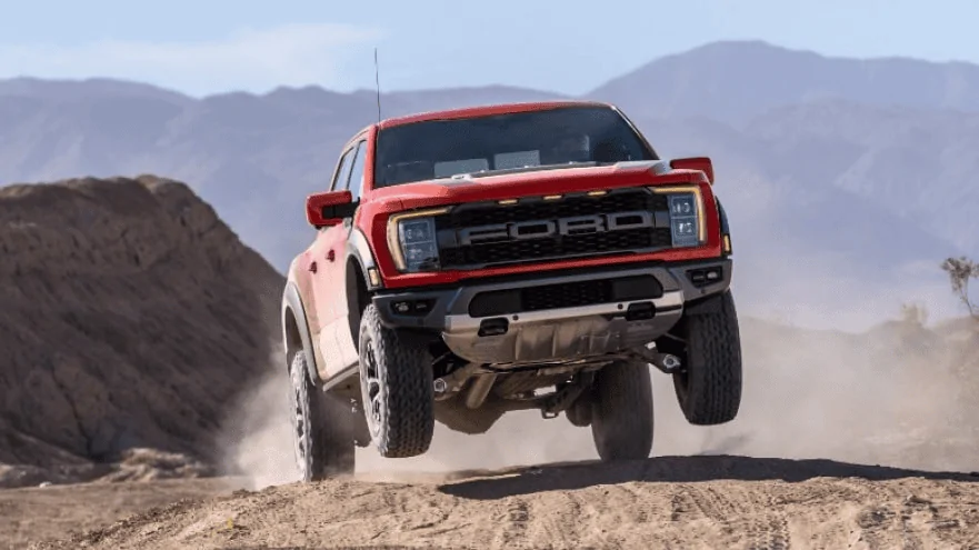

Ford Bronco Does SAS package now come with front locking hubs? 1659554451069
vs real dual-a-arm IFS:
Ford Bronco Does SAS package now come with front locking hubs? 1659554487332
Oh yeah, massive camber changes but it seemed to ride and handle well on and off road. It seemed to make the inside tire bite harder in a turn versus other ifs's, especially 2 wds. This was very similar to the twin I beam on the f series 2 wds. I still remember the tv adds driving on the 2 x4 road with a person in a chair mounted to the front fender. Sorry, but I meant the outside tire.
I shoulda posted the TTB picture... My bad.
