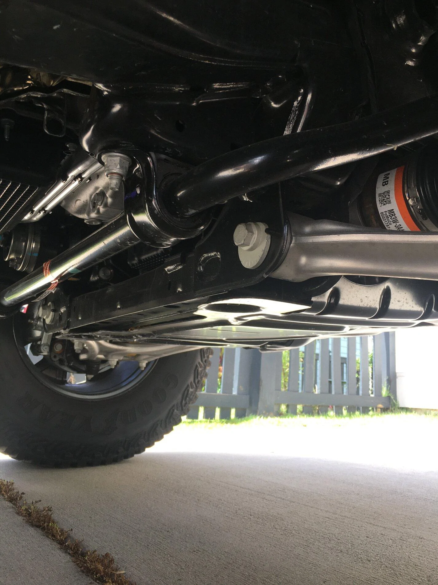

This one had the front mod bumper and I'm pretty sure the front plate was steel. It stopped at the axles and nothing past that point (from what I remember). So it seems the 2 door comes with a gas tank skid and the 4 door does not. Mod bumper gets the front steel skid for both.
Just saying that my 2 door Modular bumper came with all that is shown in the Ford Accessory kit less the transfer plate. The front plates seem to be about 14 to 12 gauge. Maybe less at the fuel tank.

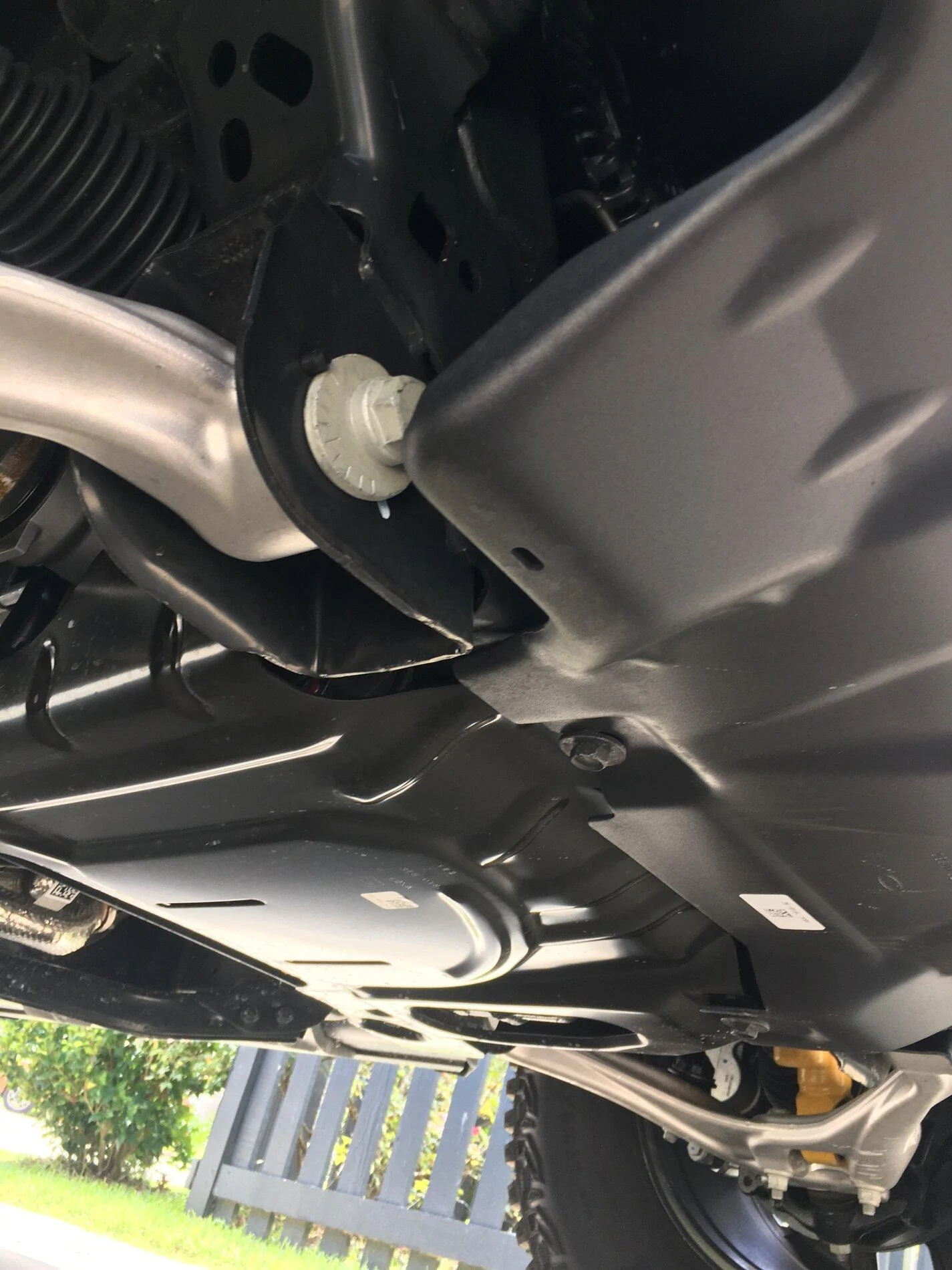

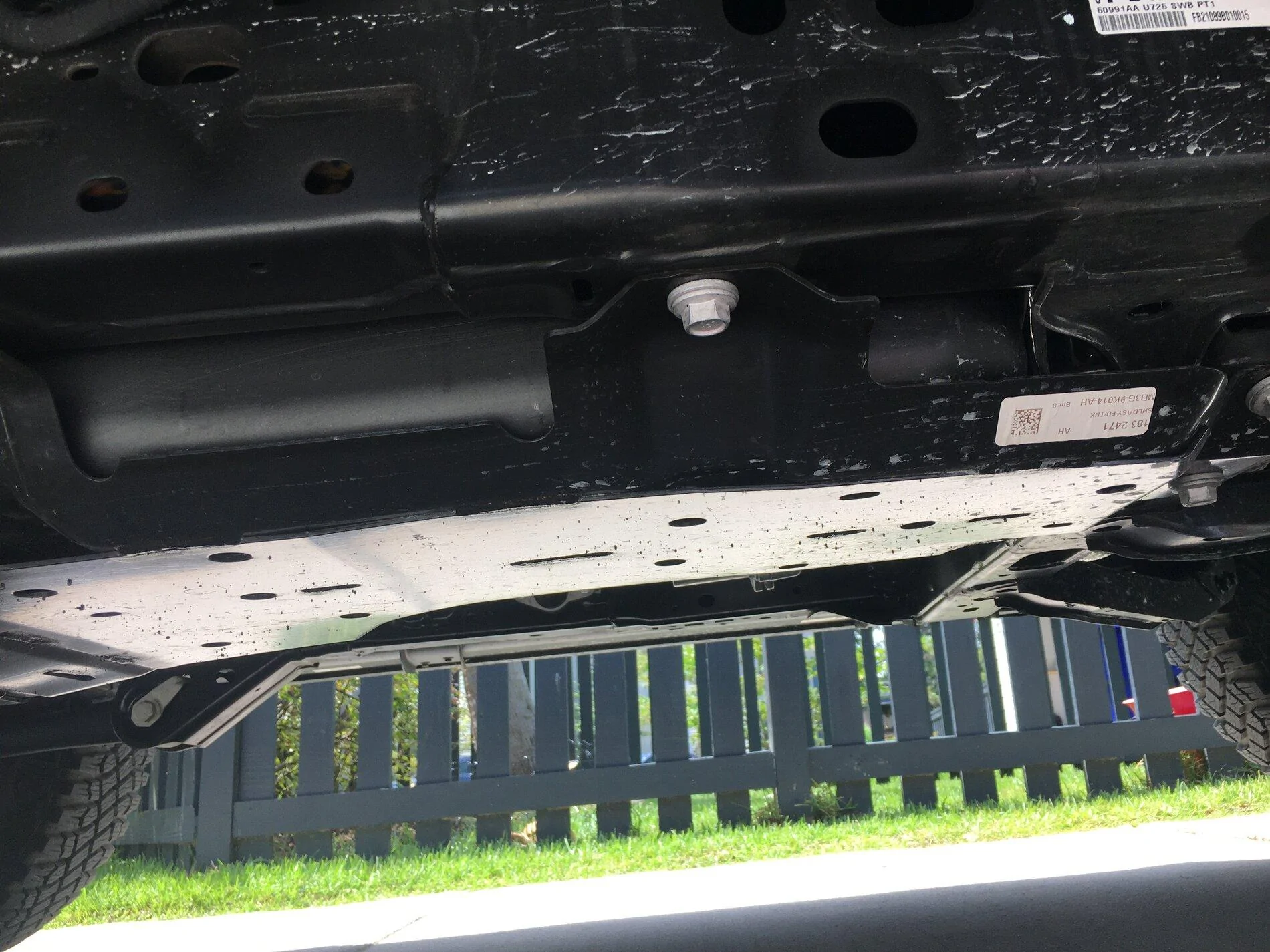

You got it. The 4 door tank bottom must be higher and deemed "not needed" by Ford. Maybe we can get some 2 door pictures to compare.
First is looking front to back- front bash is to the right- engine plate to the left
Second is the engine plate looking to the front
Third is the fuel tank plate
All 2 door
