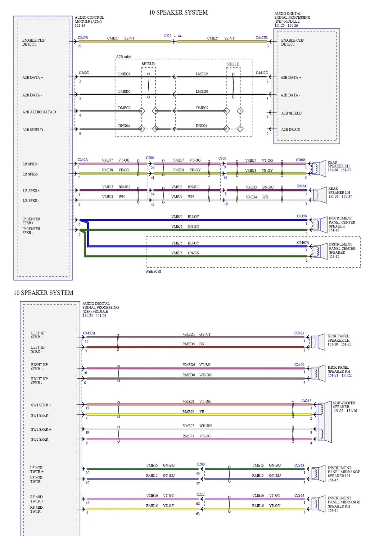

My guess is no. Looking at the schematic the IP right/left, kick panel and subwoofer are out of dsp/amp while center and rear pods are out of head unit. Most likely are crossed over in dsp with a high pass filter on tweeter of coaxial IP speakers. Hopefully will know soon as the EDD clock started today!
