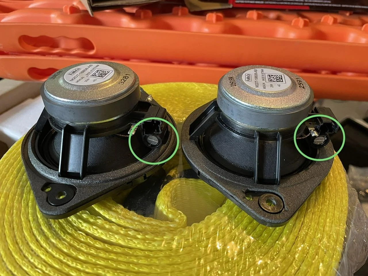

@Karl_in_Chicago front dash and rear pods on my ‘22 are the same part number (M2DT-18808-AB) and both have capacitors
Thanks for the research! Makes sense that they'd source the same units, simpler BOM/co$t and all, just wasn't certain. So anyone "unlocking" the rears on the standard head unit via Forscan needn't be concerned with if they need BB's on the rears - they are already there! Now quality of the signal and ability of the speaker to process it . . . that's why we're all here. 😉
