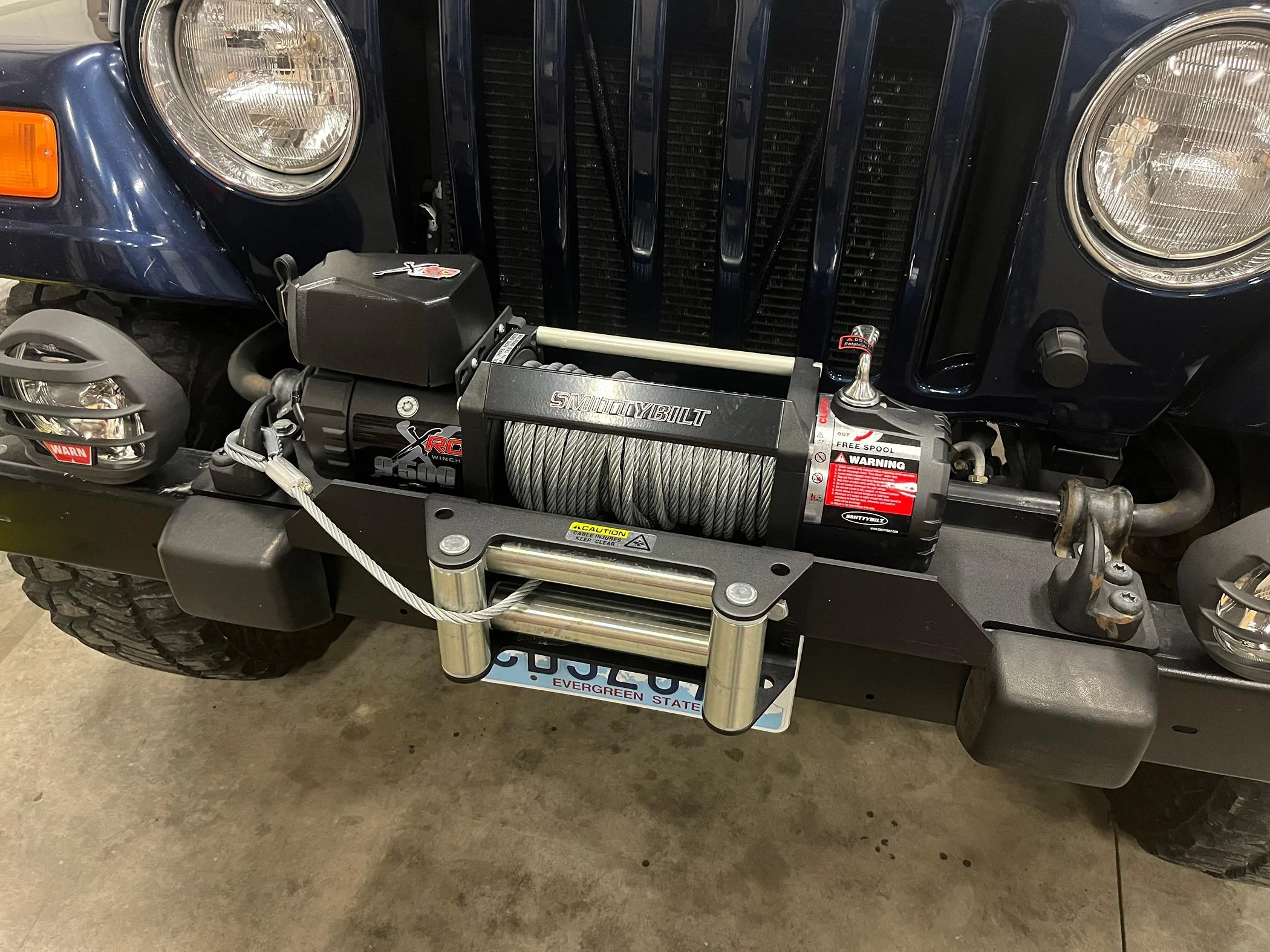

The winch baseplate started life as a generic unit for an 87-06 Jeep Wrangler. I had it leftover after building a new bumper for my '05 LJ:

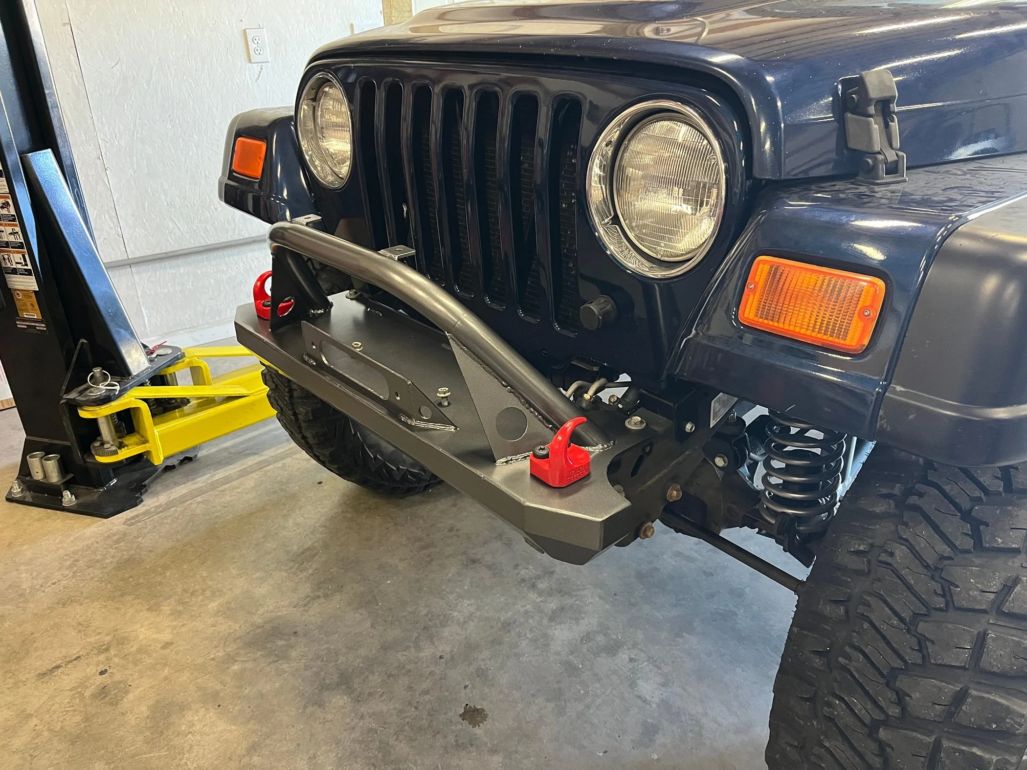

Looks similar to this one:
https://www.offroadwarehouse.com/product/jeep-winch-mounting-plate-8706-wrangler-yjtj-1189
Thanks! Bumper came out great, you have a tube bender too or welded on a pre fab tube?

I believe that RC Jeep winch plate is exactly the same one I started with; I picked it up off Amazon several years ago.
Yes, I have a tube bender.

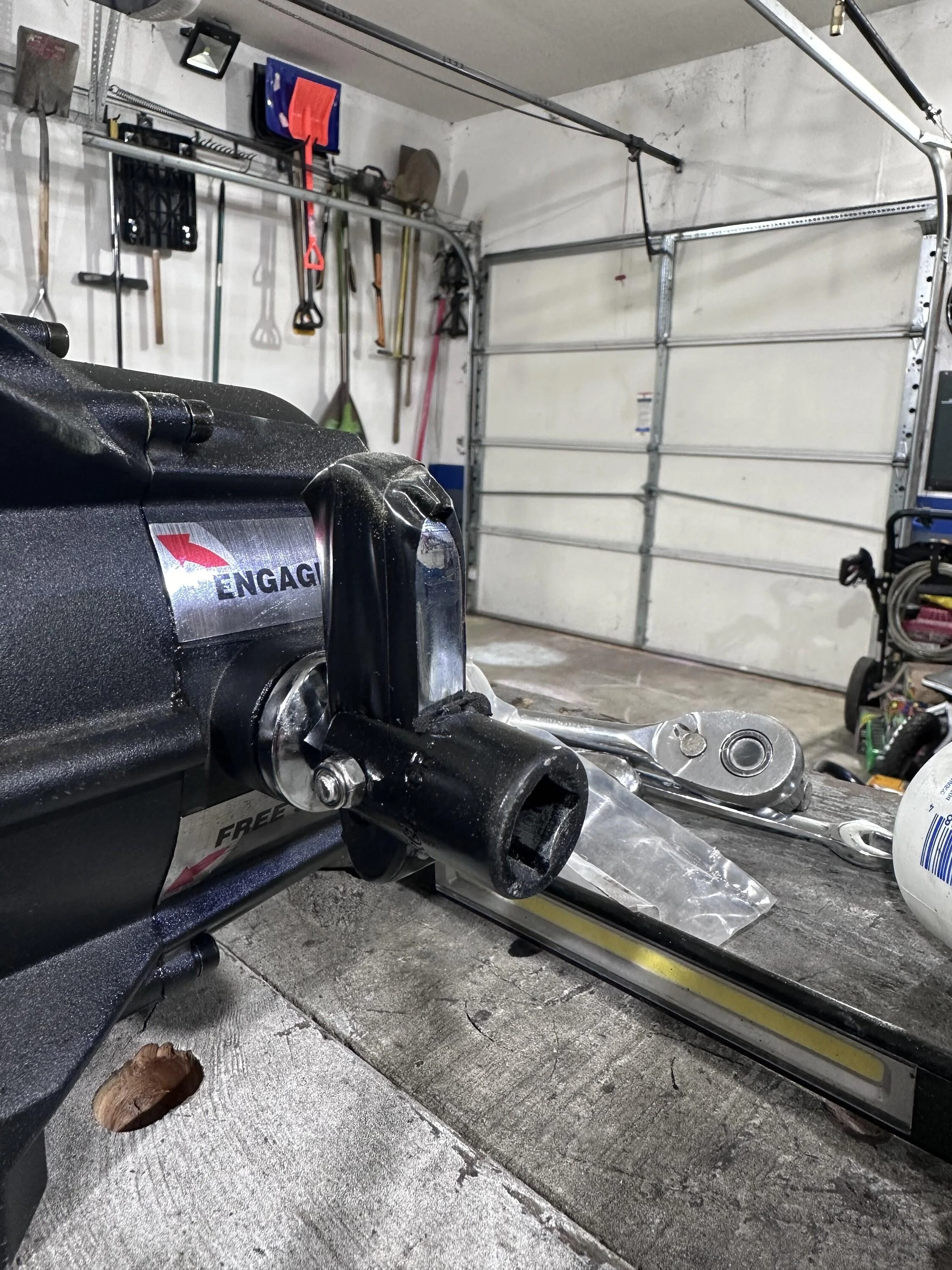

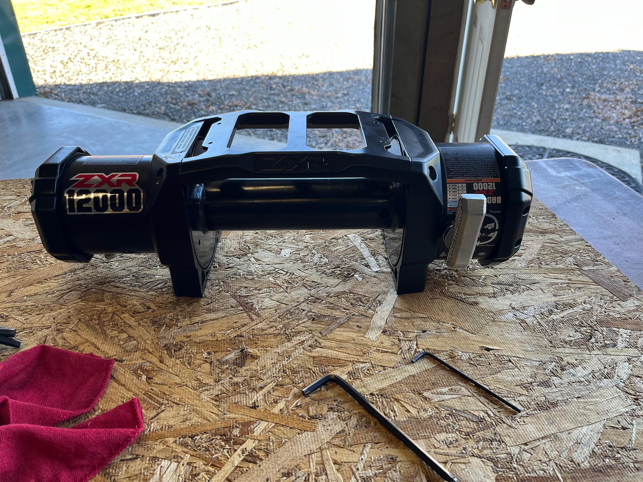

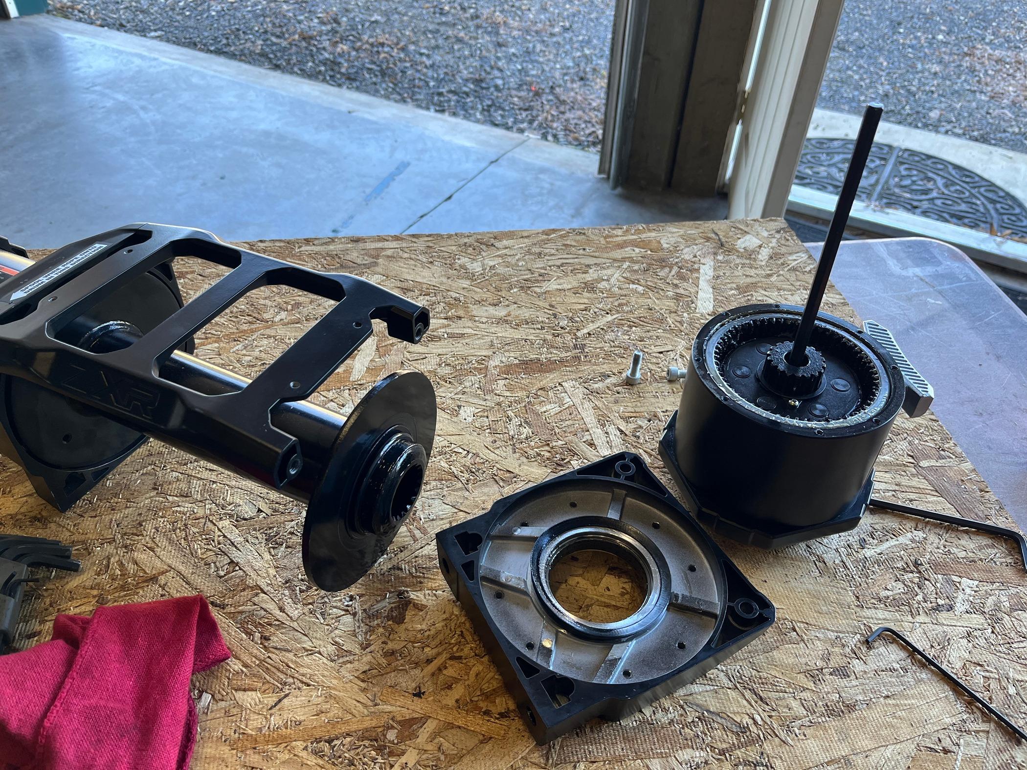

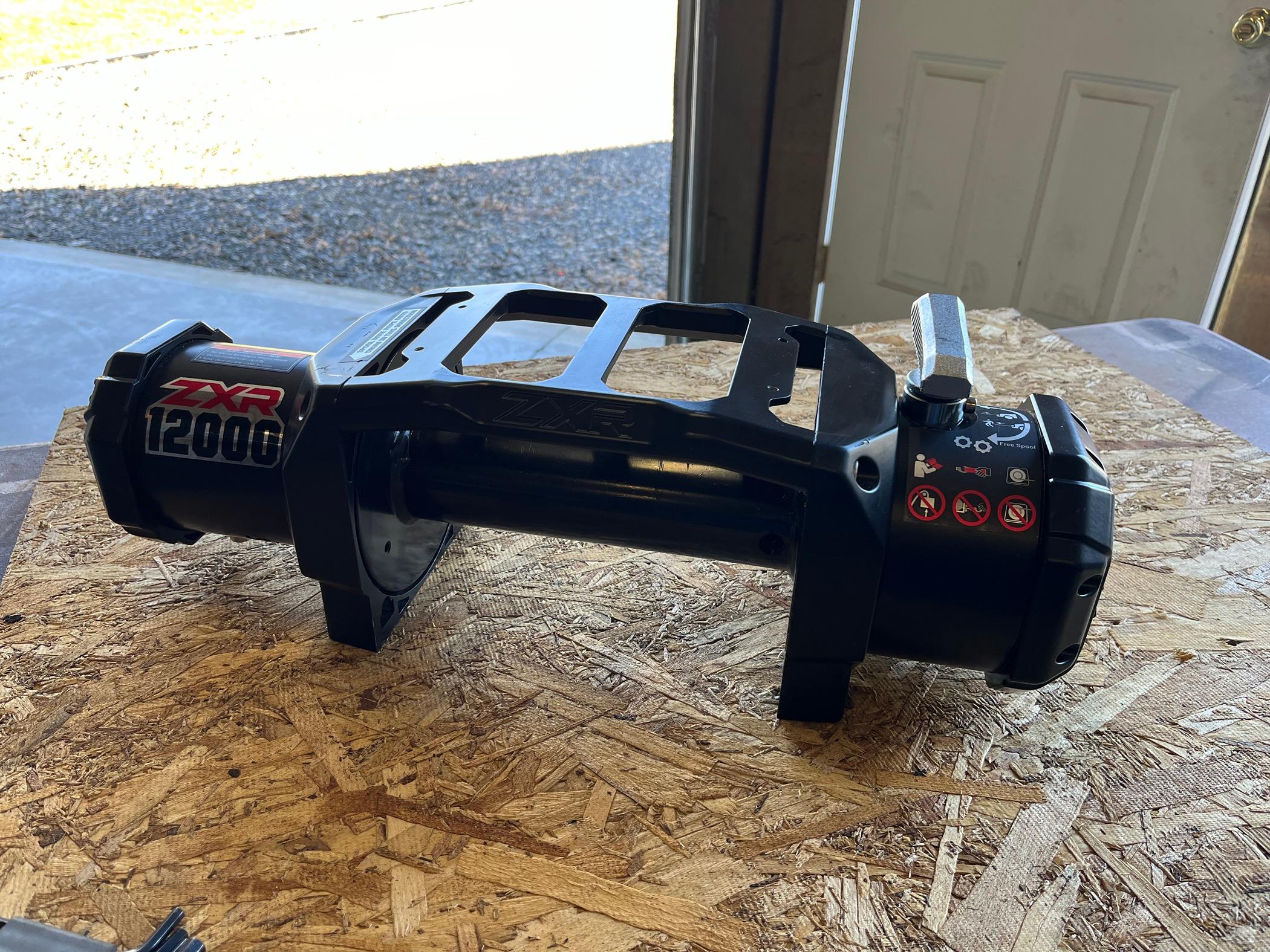

I was happy to see how easy it was to clock this Badland 12k winch so the clutch lever is easily accessible through the face of the bumper:
