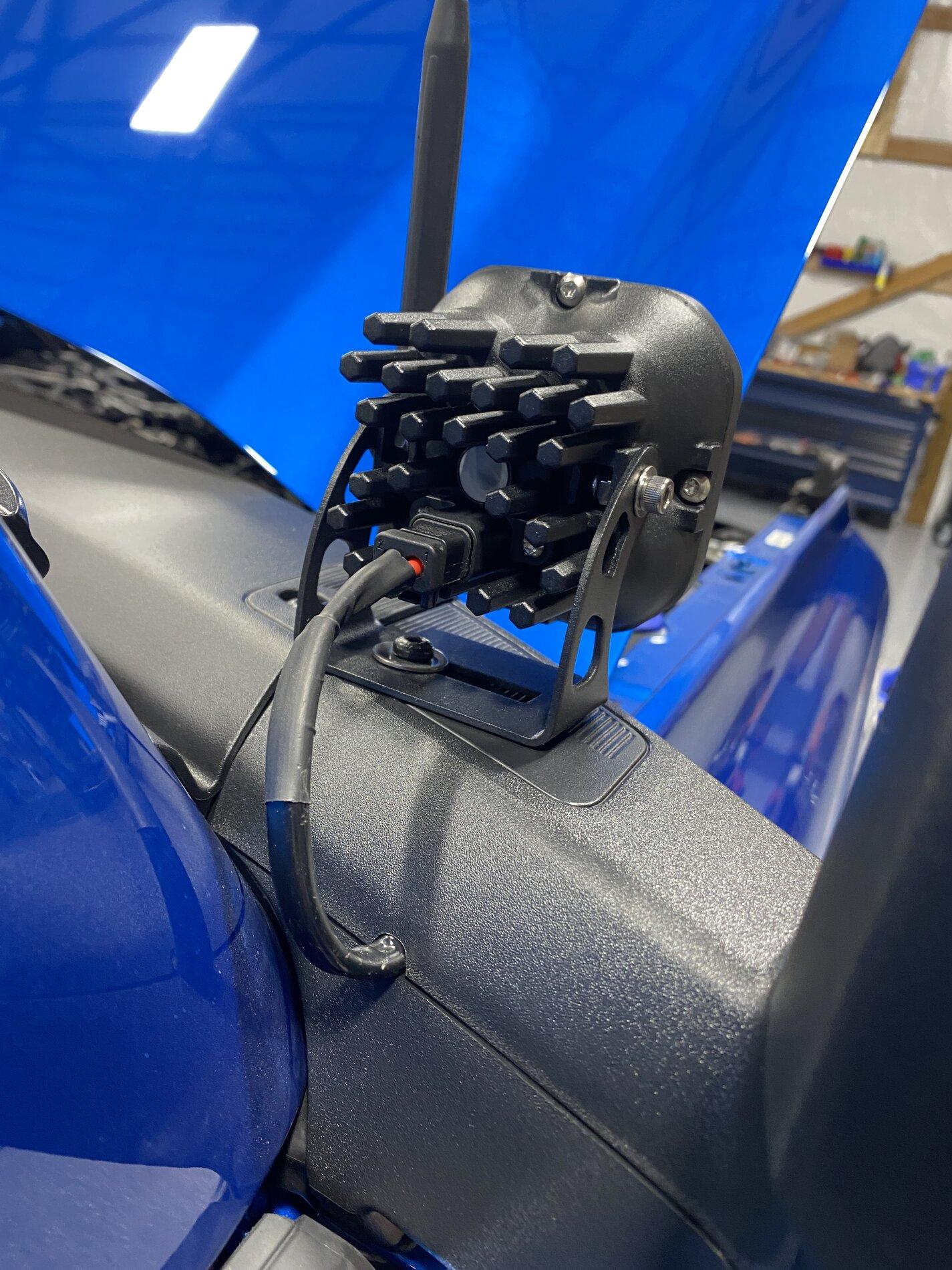

This may be a dumb question... But what the hell is a “cowl?” And where it it located? I’ve never installed my own lights before (hate drilling into my own vehicles). But if drilling can be avoided, I’ll give it a go myself!
The cowl is the plastic piece between the windshield and the under hood area. there is a one torx to the left of the mounting location you remove that and pop it up. After that you can run the wires under it.
We have a video that will be out in a few weeks that will go into detail!

Is that a mounting point inward of the current location? That would seem like a good location.

i was wondering if you noticed any specific times where you found the factory lighting to be inadequate? also did you order the auxiliary switch panel or did you need to add a switch to the dash?
Used the oem upfitter switches. Large yellow wire to power it. grounded the harness on existing ground on cowl.
I just liked the look to be honest, lighting is good without them.
Antenna is in the way on the passenger side, I would have liked to have used the inboard bolt as well.
down fall to the inboard bolt is its not rated for weight like the outboard.
I would be careful mounting big pods to it as those 2 inboard bolts hold down the cowl
