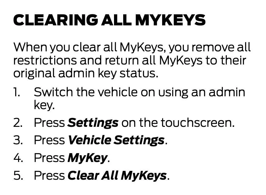

Is there a way to deprogram mykey permanently? Seems like every couple of months, it resets itself & I have to use the other fab to turn it off. Thanks.

from my '23 owner's manual, p. 86:
Ford Bronco Deprogram mykey permanently? Screen Shot 2024-09-16 at 10.33.39 AM

Sure you don’t have a prankster in the house? My guys at work have F150s and they will occasionally enable mykey on a coworker when they get the opportunity.
