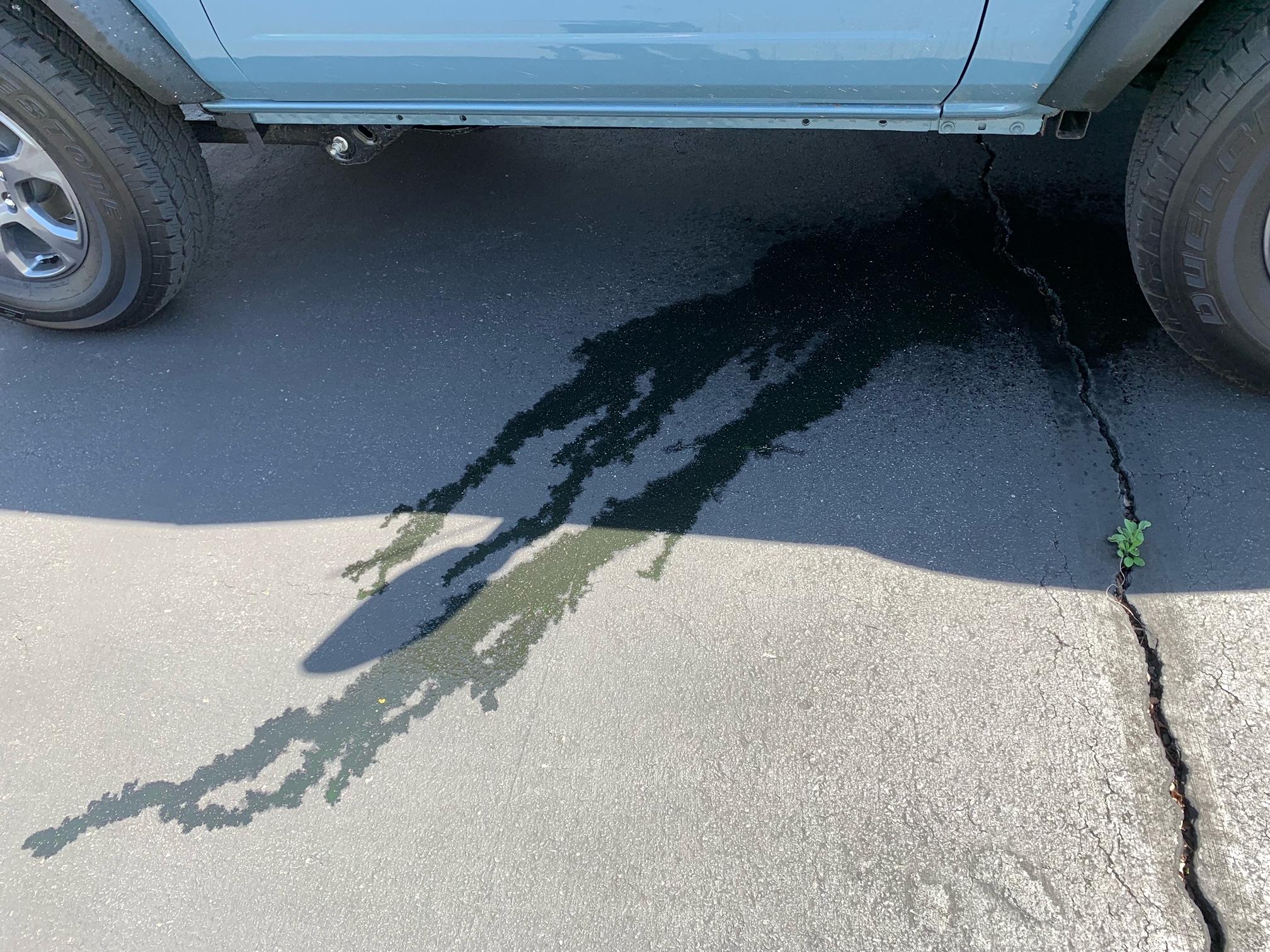

One more item for the mechanical inspection checklist:
Check coolant reservoir cap to ensure it’s screwed on tight- until it click-locks.
Last week my 3/7 build sprung a leak under the reservoir (passenger side near firewall) after only 50+ miles, on an 84 degree day. I now feel foolish for taking it to the dealer, but I also had them check the clamps and hoses, since other helpful B6G members had reported issues.

Sheesh!
Thanks for the post. The dealer should have caught that during their PDI.
