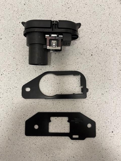

Known problem. The Bronco specific 7/4 trailer plug comes with it's own special bracket that's not available from Ford individually. I got one of 3 of these that were in the depot and have not seen any since. If you buy the Ford accessory trailer hitch kit it comes with the hitch, 4 bolts and bracket for the flat 4 pin. See the pic below..

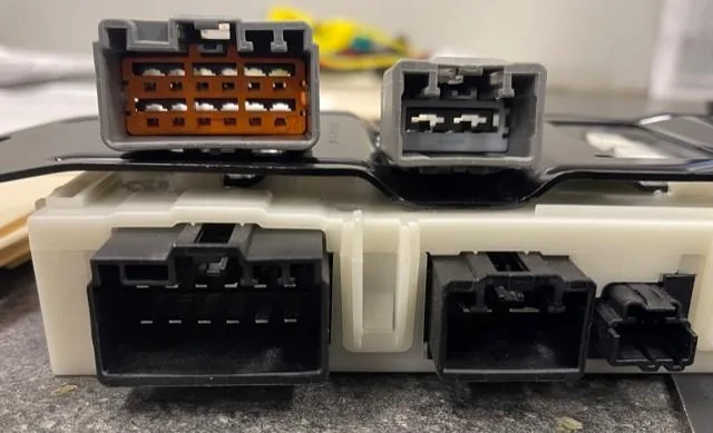

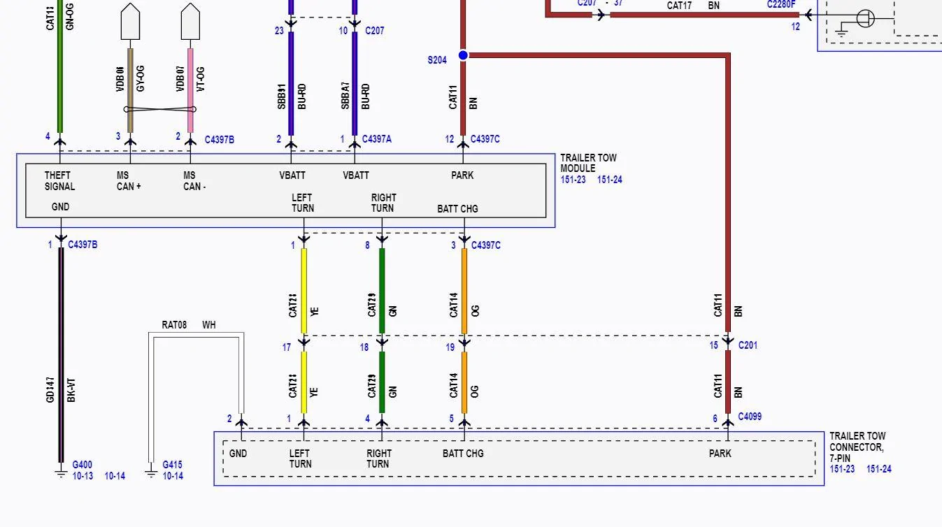

If you had factory TT this is what the wiring manual shows. There are two higher amp VBATT 12V+ coming in through this connector near where the module would mount. Problem is, this plugs into the module which means the male side is part of the module. Got a fix.

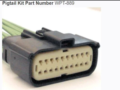

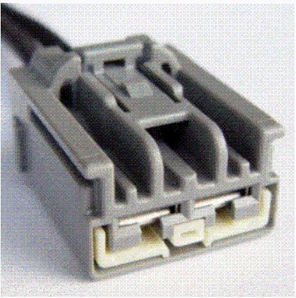

I've got a source for the correct connector and terminals. Ford also carries the pigtails but they are much more expensive than where I'm getting them. The downside, you have to make up your own pigtails. The larger connector should have one circuit coming in for park lights. That's assuming the BCM feeds this factory TT or not. Not a huge problem because we can pick that signal up at the next connector.

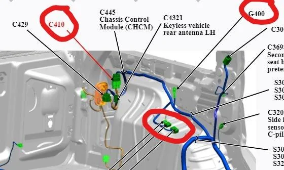

While this is up I'll explain the connectors. C410 on driver side and C411 (not pictured) are where the turn, stop, park, reverse lights meet up prior to exiting through the orange bulkhead and to the tail light housings. G400 is where we will pick up a ground for the Ford tail light converter. The 3 connectors circled are for factory TT. The plan is to mount the converter in this general area.
The big question, to cut or not cut. I hate Scotch lock connectors having fought electrical problems in the past due to half arsed installations. Ideally, there would be another set of male/female connectors between C410 and C411 with jumpers coming off the wires we need to pick up signal from but we're getting into more cost and more complexity. The connectors are unsealed Molex MX150 20 cavity. Readily available but short of buying pre made pigtails, would require crimping tools.
