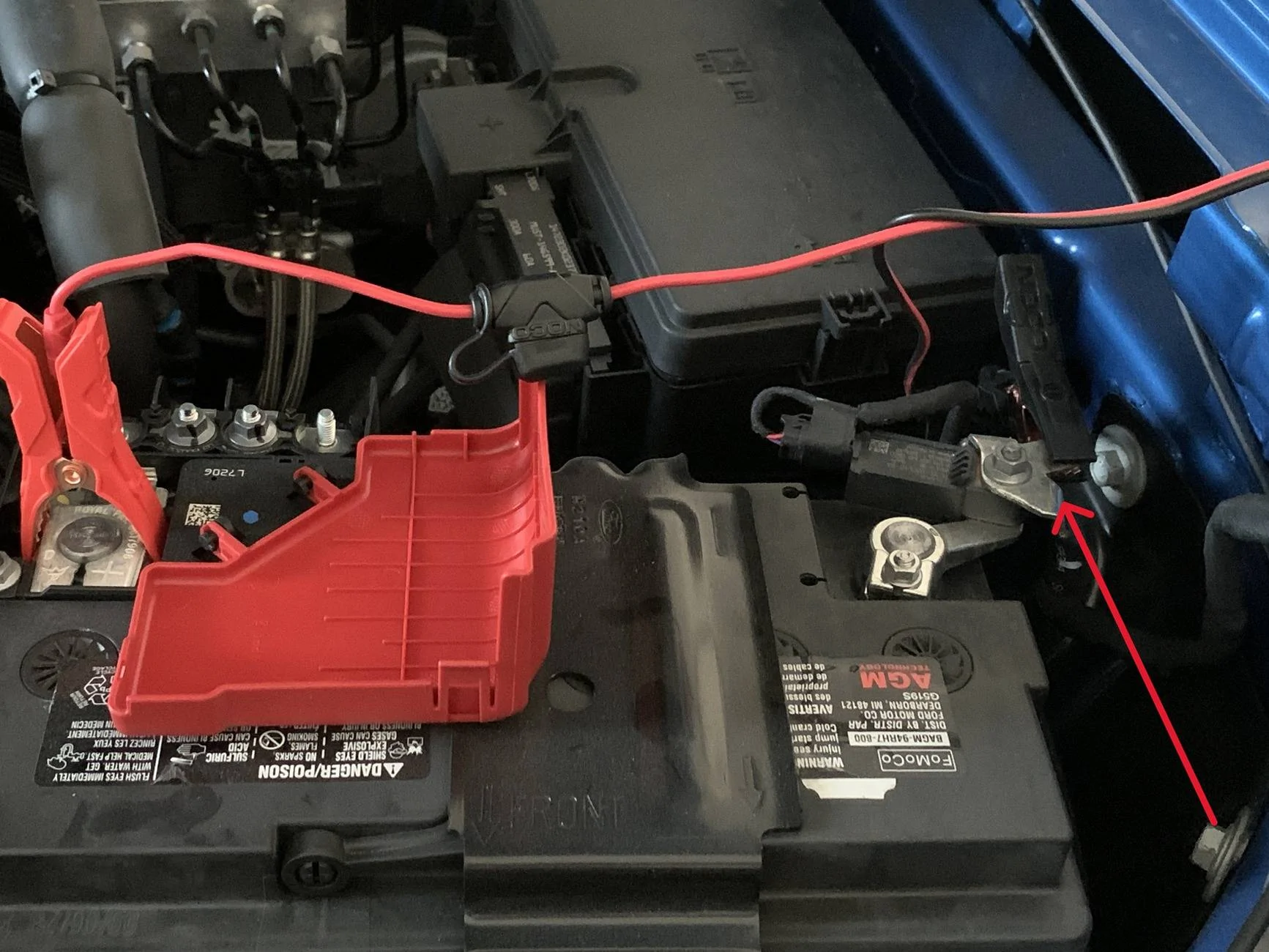

So the tab off the BMS is not a good point to attach? I thought it was
That's fine. Any good ground other than the negative post. It just needs to be on the backside of the BMS sensor
