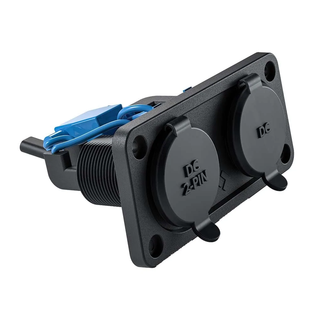

I recently got a fridge slide, a dometic fridge, and a Anker Power Station. My plan is to run the power station to the DC power outlet in the rear of the vehicle, and have the fridge plugged into the power station. My only issue is the fridge/slide/power station sit on the driver side of the vehicle, and the power outlet is on the passenger side of the vehicle. I considered moving the slide and everything to the passenger side, but the fridge gets caught on the tailgate area.
I'm looking to relocate that outlet, or maybe add the Dometic Hardwire Kit so I can have a DC plug on the drivers side. Does anyone have any experience with this? I'm a novice when it comes to electrical work and have no idea where I could even tap into power or run the wires.
If anyone has any knowledge they could share I would appreciate it!
