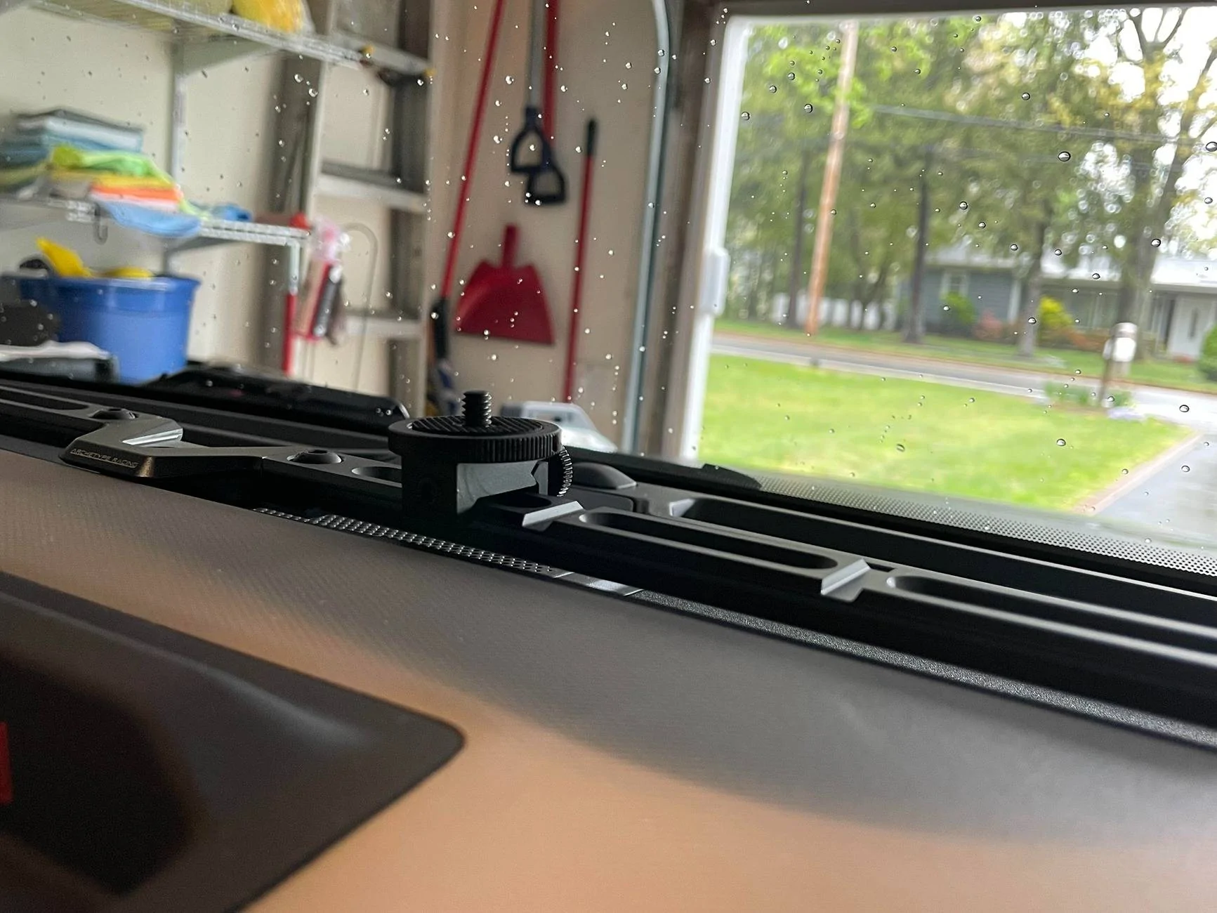

The BYOD (Bring Your Own Device) rails highlighted with the first Bronco announcement were never produced by Ford. Not sure if putting a ton of stuff on the dash was considered too unsafe to sponsor this. Nevertheless, the after-market has come up with a bunch of components to screw into the 'Accessory Ready' mount in the middle of the dash. I have the AR rail and have to admit that even tho it's flat black, the flat parts (see below) do reflect on the windshield on a sunny day. I have a friend with the same rail in Silver and it's much worse with that color. Regardless, it does give lots of options to install accessories. Cameras, phones, pass holders, etc. can all be set up here with a clear view.

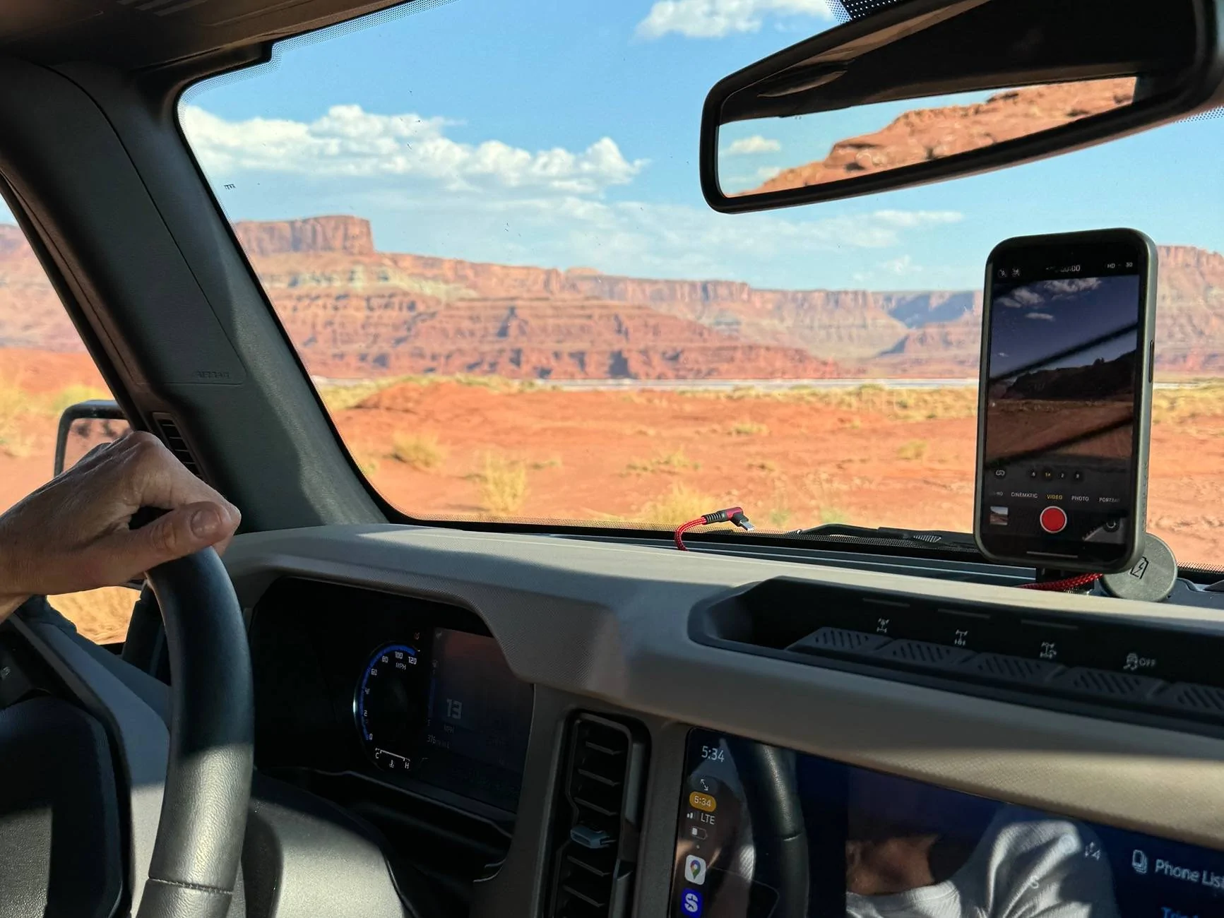

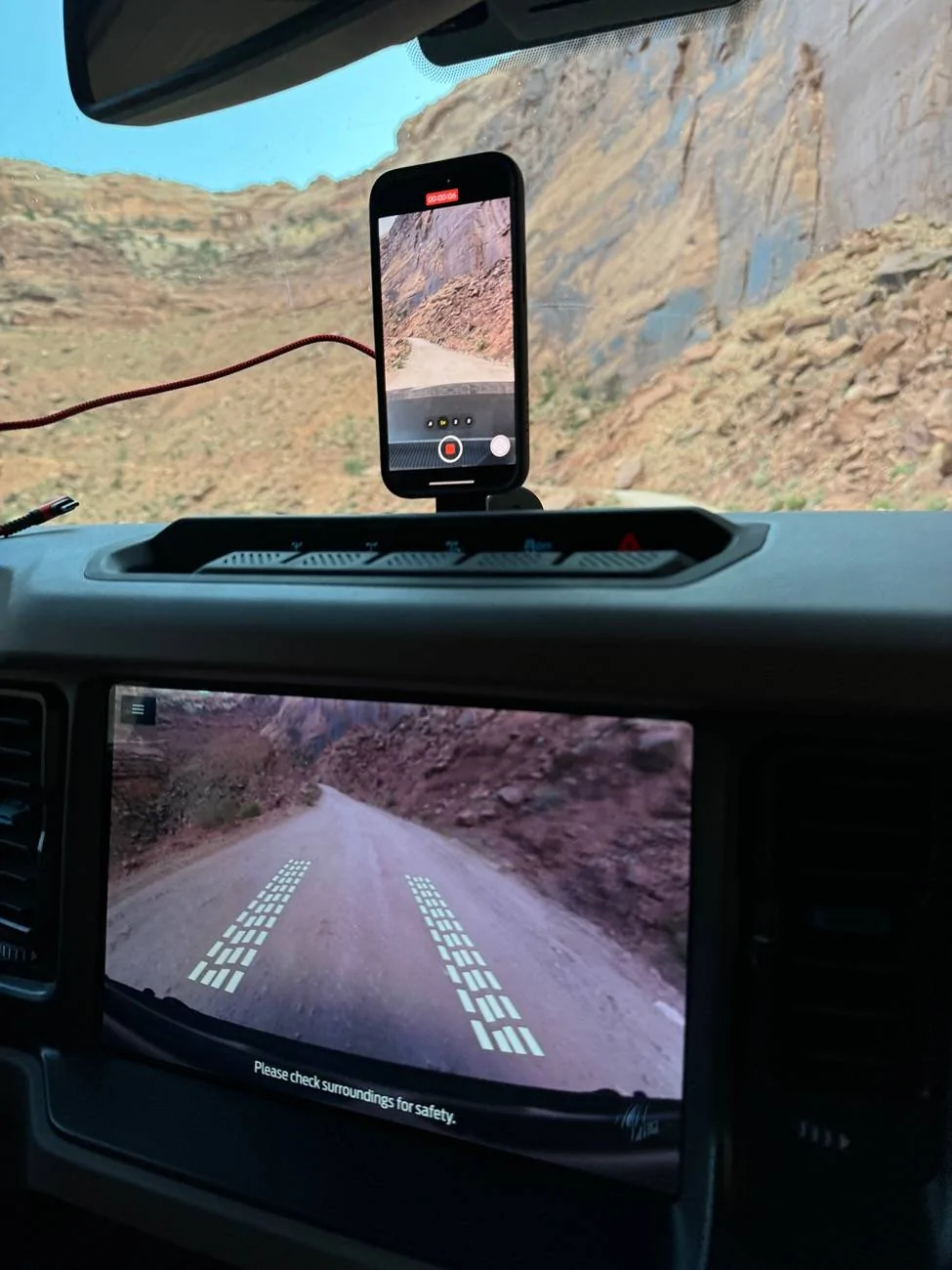

I use a Quad Lock mount and phone case with my iPhone15 Pro. Was really pleased on our recent trip. Minimal setup, quick mount/dismount for the phone and image stabilization of the iphone made the video easy to watch. Glare wasn’t an issue but really had to make sure the windshield was clean in front of the camera and the dashboard free of light colored items to reflect. Obviously doesn't handle multiple accessories, but clean.
