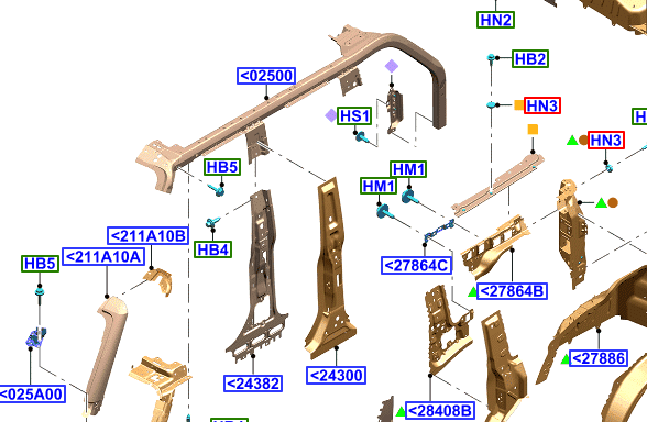

Each manufacturer publishes position statements, metal repairability charts and repair procedures. Like I said earlier, Ford just bought back a 2020 Explorer because their repair manual was wrong and frame section couldn't be replaced according to their instructions (boron).
"Boron and Ultra-High-Strength Steel/Martensitic components must be replaced at factory joints; sectioning is not allowed"
If you buy a vehicle and modify, it's your business. If you start cutting around on stuff and compromise safety or vehicle integrity, that can get into a whole different liability issue and might void the vehicle warranty. This isn't like running a hot program or putting bumpers on. There are published procedures on how to safely and correctly do repairs on different parts of vehicles for a reason. Just sayin'.

What am I missing here? Everything is welded together. How is a sawzall not come into play here? You're dealing with boron steel, HSLA steel and bake hardened steel in the horizontal bar, rear down tube and cross reinforcements. No bolting here, it's going to be cut and weld and there is no procedure to weld on boron without screwing it up.
Just a thought here, if its all welded together how is there no welding process to weld it?
Only where Ford says you can spot weld and they also give you a specific wire type, size and nugget size depending on what steel it is. My point posting is not dissuade the OP, just make them aware there's a lot more involved to do these modifications and try to provide some useful information. The days of just welding on something and calling it good are long gone. As a dealership with a body shop, we do the repair by the book or not at all. Way too much liability involved with doing a half-assed repair.
