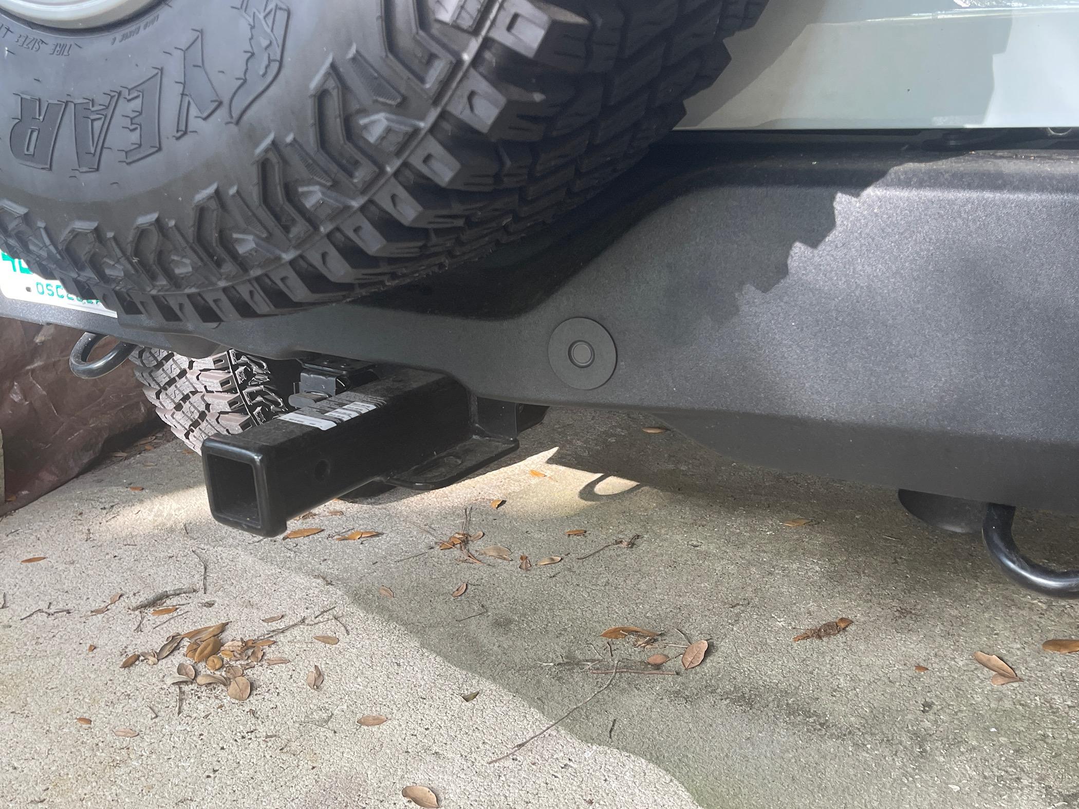

I got the Draw Tite extended hitch and Curt wiring kit. Plug in line /pass thru with tail light harness. There are videos on YouTube and instructions. Fairly easy. I had to use a spacer and some additional washers as the bolts are a bit long.
Ford Bronco Curt hitch or get Ford installed tow package? IMG_9239
