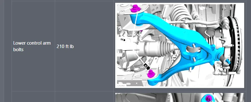

Check if your LCA bolts are torqued to spec. Two different alignments I got the Bronco back and the LCAs weren't to spec and made similar sounds. The last shop had them at ~90ft-lbs even though I TOLD them 210ft-lbs. I've since found a good shop for alignments, marked all the bolts/nuts, no issues since.
