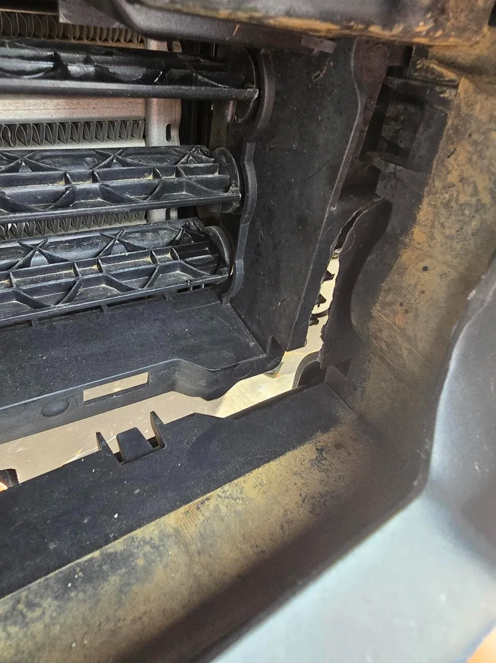

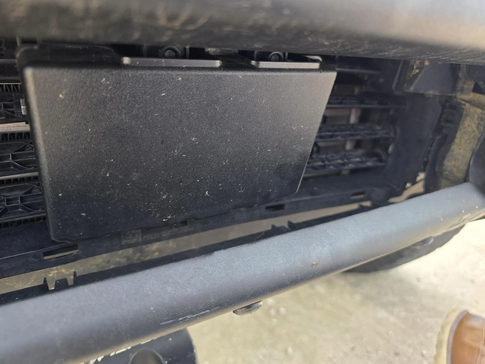

Welp, I think I just found out what's wrong with mine... The whole plastic structure the ACC distance sensor is mounted on is broken and bent back (making sensor point down more than it should). I must have hit something off-roading at some point. I guess I'm pulling my bumper off and doing some work with some epoxy...
