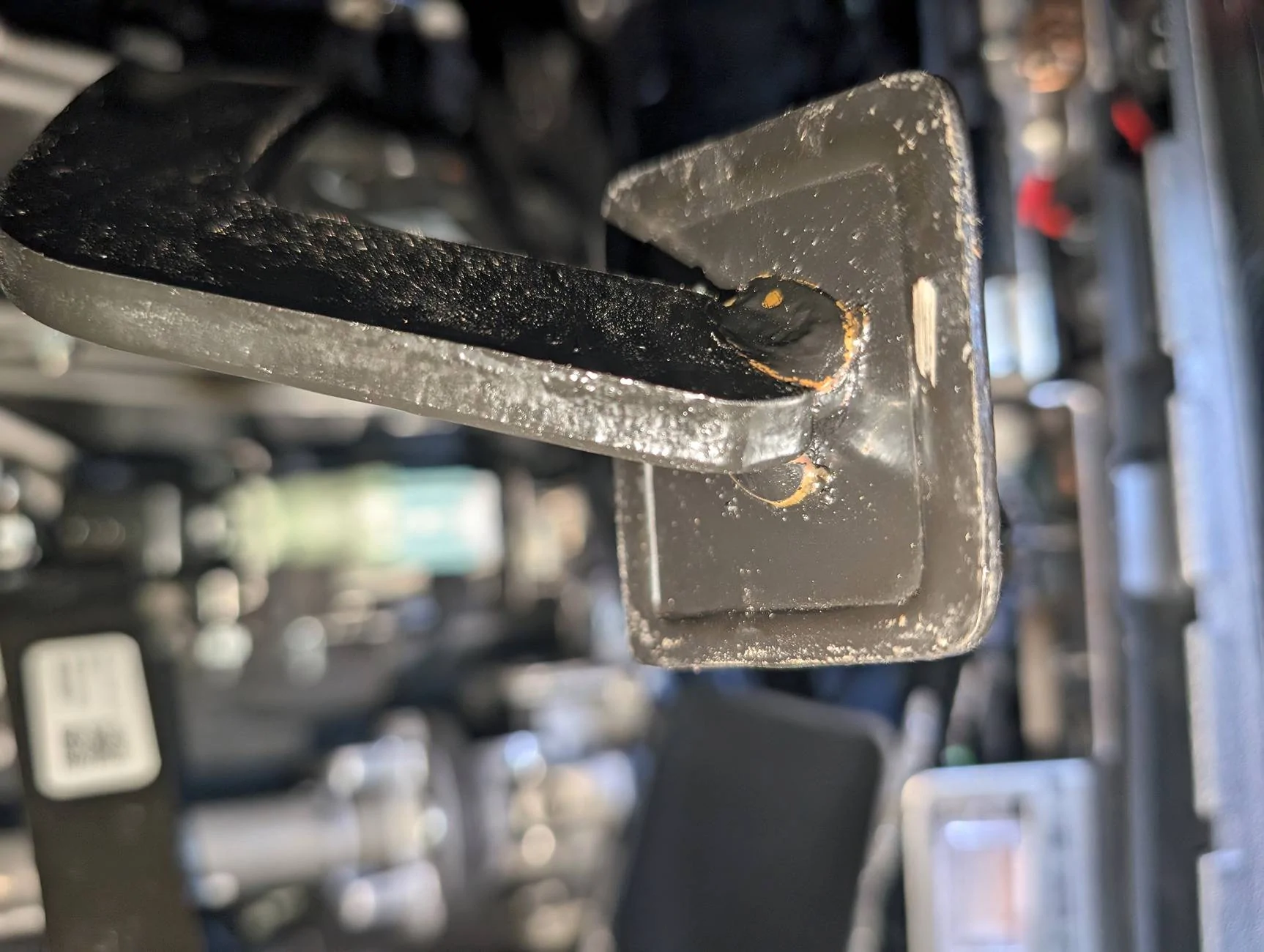

So after a week or so the creaking returned, odd, perhaps I was not hearing it initially, but upon further looking I may have found the source of the creaking. Here is what the back of the pedal looks like. shitty welding?
Ford Bronco Clutch creaking PXL_20250521_003909691
No idea how to fix this
