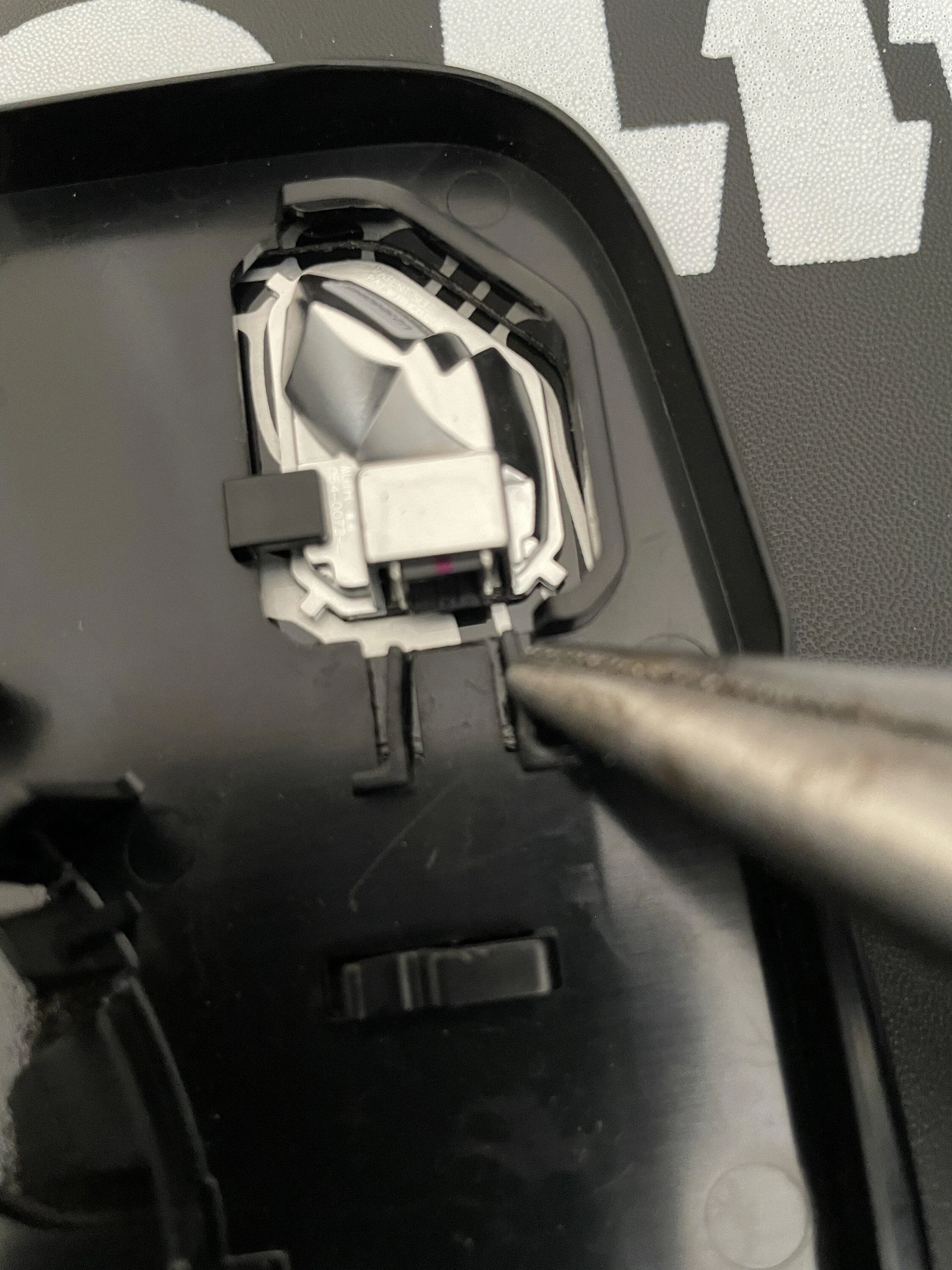

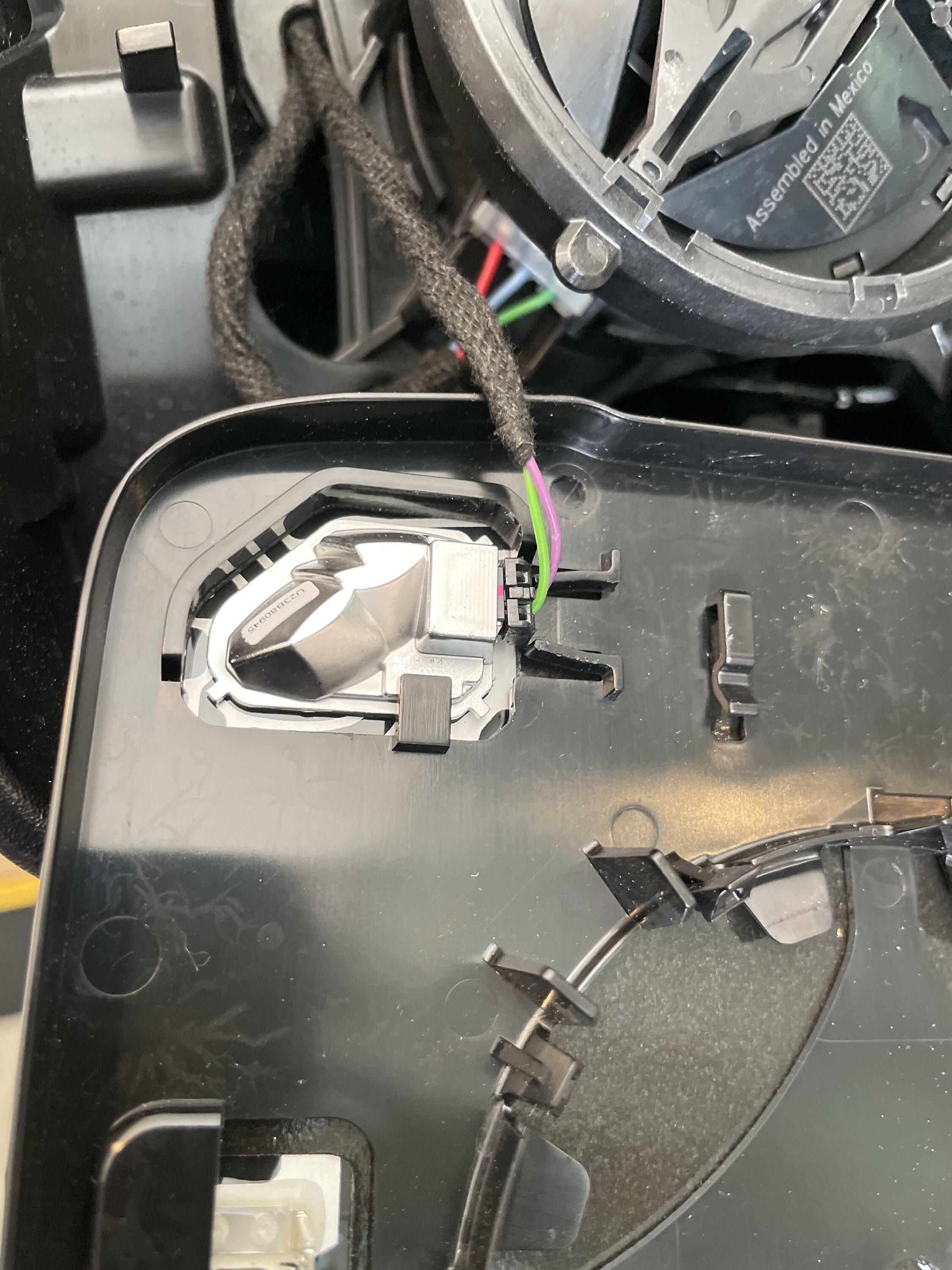

I just opened the package a year and a half after receiving it because I finally got the car. There’s no instruction manual and the item listing page only shows how to pop the mirror off. How do I remove the BLIS connector??
Ford Bronco (CLOSED) Group Buy | Suma Performance Mirrors image
Edit:
Nvm this was easier than I thought. These plastic retainers flap so you’re supposed to push it to the sides.
INCLUDE IT IN YOUR INSTRUCTION PLEASE, @Suma Performance

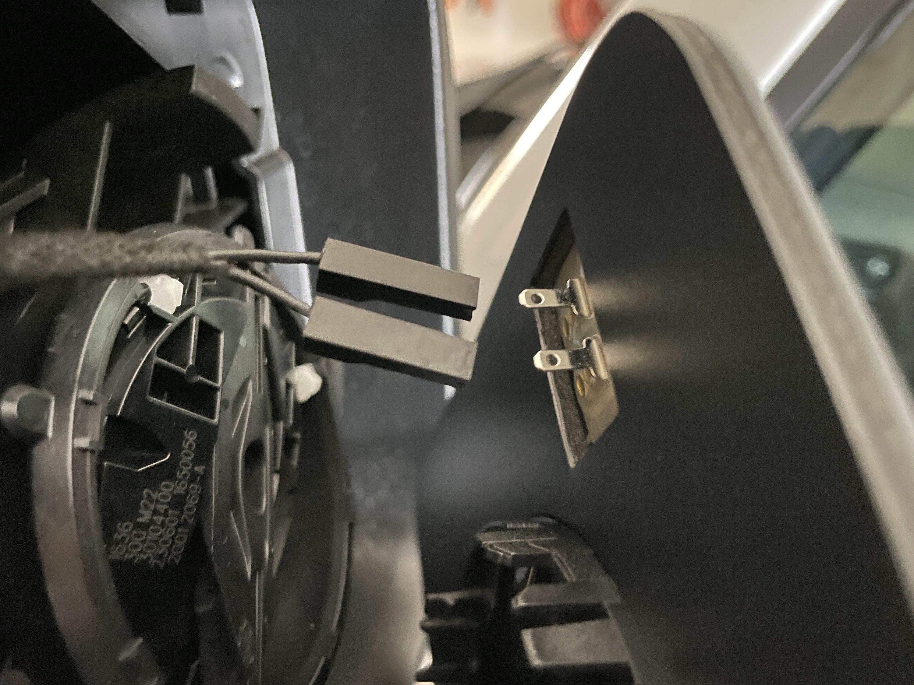

Another issue, freaking defroster pins on the replacement mirror are a lot thinner than the OEM, so the connectors don’t stay in place nor are long enough to even make the mirror sit in the place. WTF??
Suma provides extensions for these cables in the box if I recall...
I was the #4 order placer when they first launched this product, so I have the very first batch of the manufacturer's defective product. Nothing was sent to the shipping address afterward either so I just gave them a DM.
They’ll send you a set.
I just bent them a bit, they stay seated.
