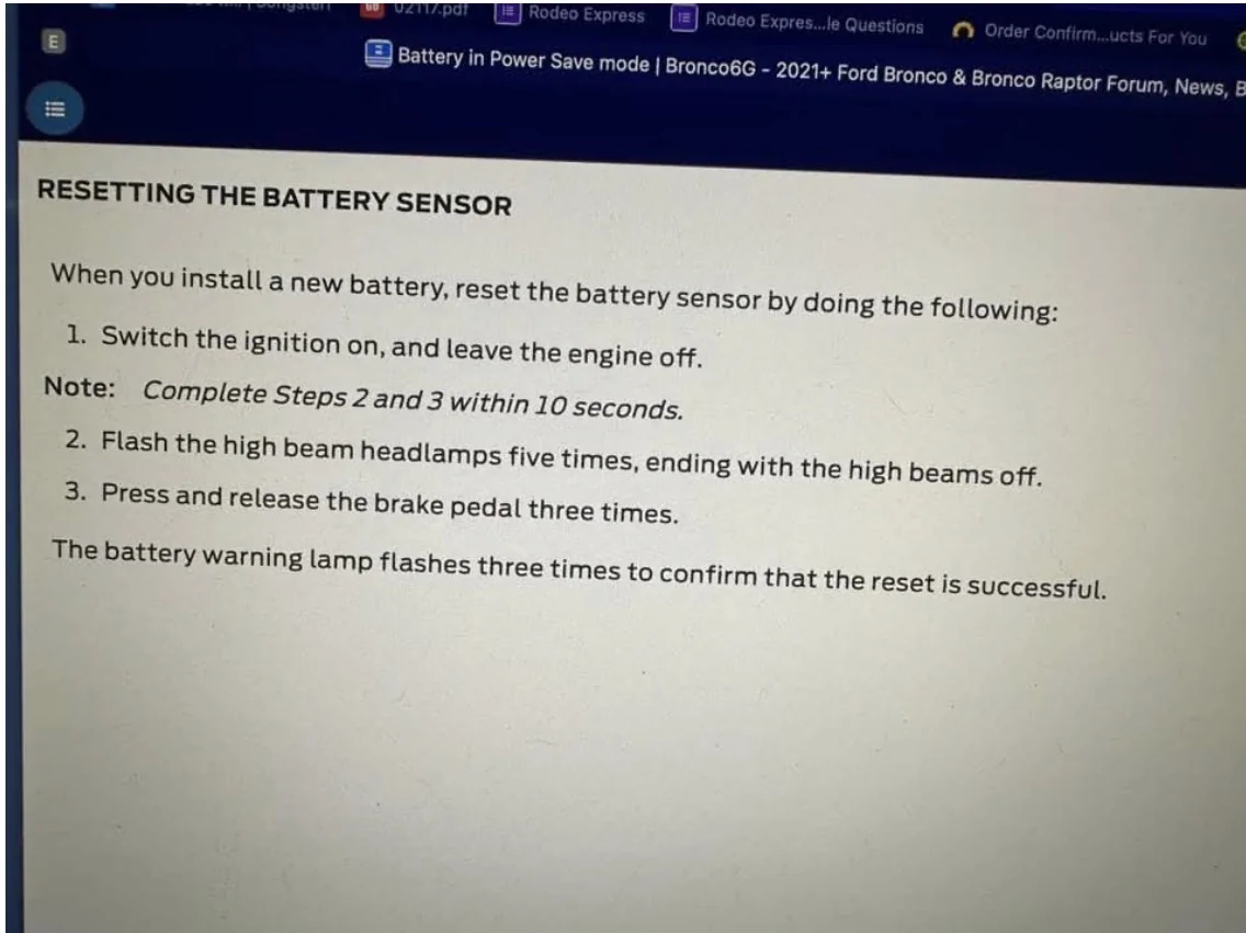

Tanks but did that as per many youtube videos. Battery light did not flash after the brake pumps and now the car won't even start-with the new battery in. Seems like i have to unplug the battery sensor or maybe discoonect/reconnect battery and try the brights/brake pumps again.

If you cant get the headlamp/brake/button/whatever dance to
work - Forscan also has it in the service mode section and it’s a lot easier to activate there.
The fact that it did’t reset ~may~ be an issue but shouldn’t be hanging the parking brakes up.
Here’s what I would try before you have it towed: (I know you’ve done a lot of this already but the order can matter)
See if you can reset the BMS again (any way you choose) - if it works great, if not ok — proceed as below either way
Pull the negative lead for about 20 minutes or so
Connect the negative lead again
Dont start it or anything yet
Put the battery on a trickle charger / tender (I know its brand new - this is more for the BMS). make sure the negative clamp is on chassis or the wing out on the harness — not directly on the battery (-) post
Let it sit over night
If the BMS didnt reset the day before, try it again here
Use an OBD scanner or Forscan and check for any codes here (ProCal is a junk scanner and wont show you everything) — they should have reset when you pulled the cable but if you have some at this point it’s teliing. Reset any thing that may have popped up
Now start it up and see what it does
