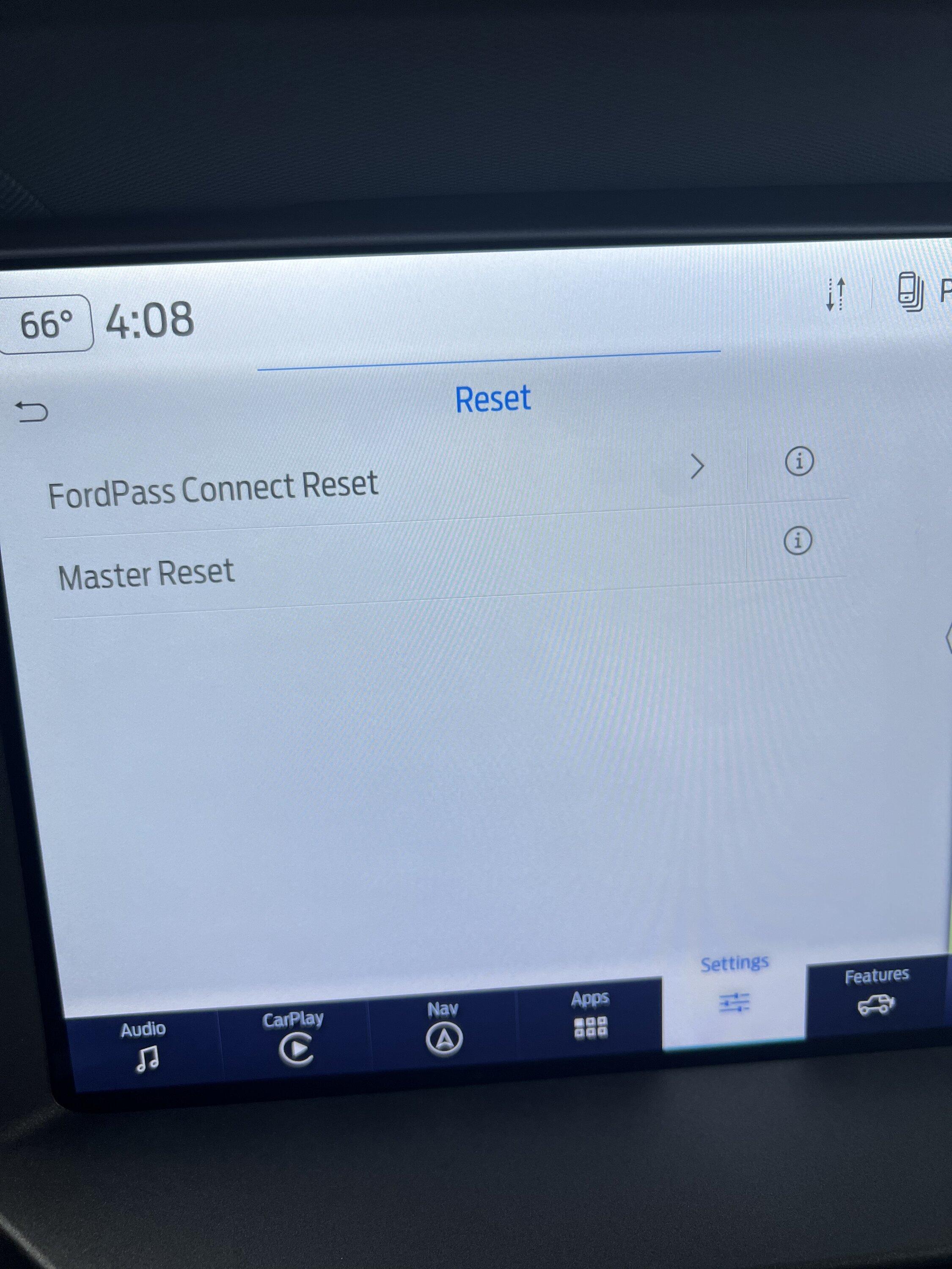

I’m not sure exactly what it resets but it doesn’t reset your settings. When I’m having CarPlay issues it always solves them.
I did a master reset of the entire stereo/sync system and now it is working. I had to set up some things again but ATT and sirius came back alive without any phone calls.
The reset I did is show below
I think that may be a different reset but glad that worked for you.
You don’t need to do a master reset when sync acts up. Just restart the head unit. Hold the power and seek forward buttons for about 10 seconds and it will restart. No need to loose all your settings and connections.
