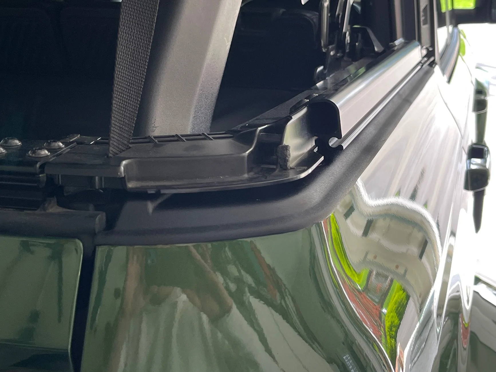

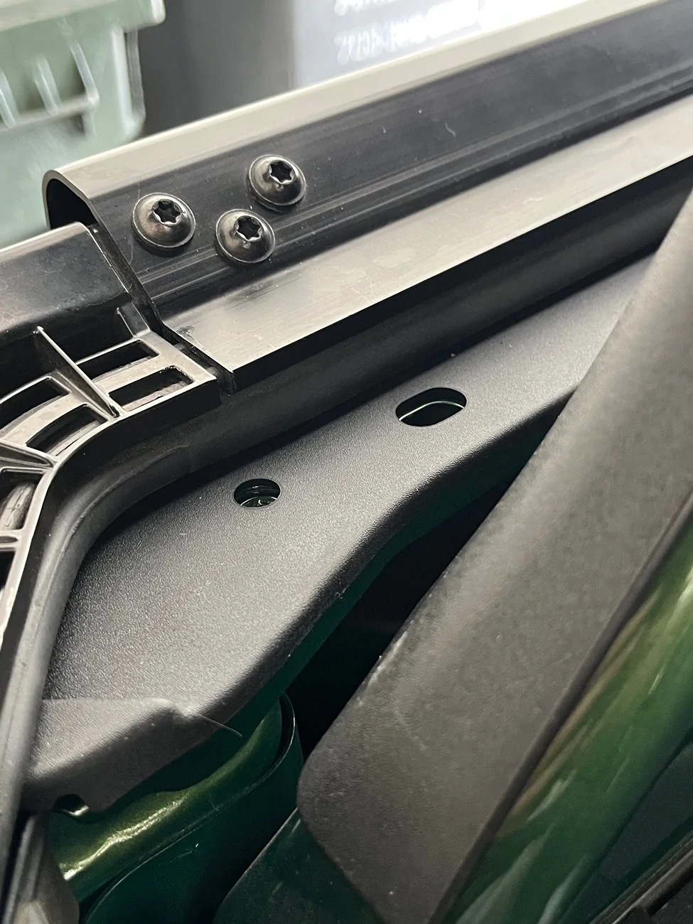

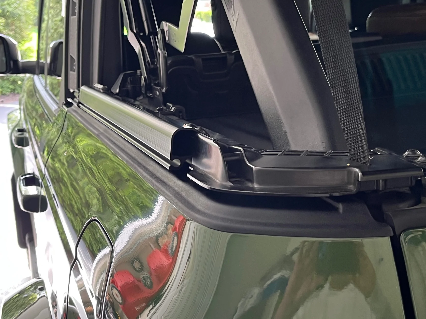

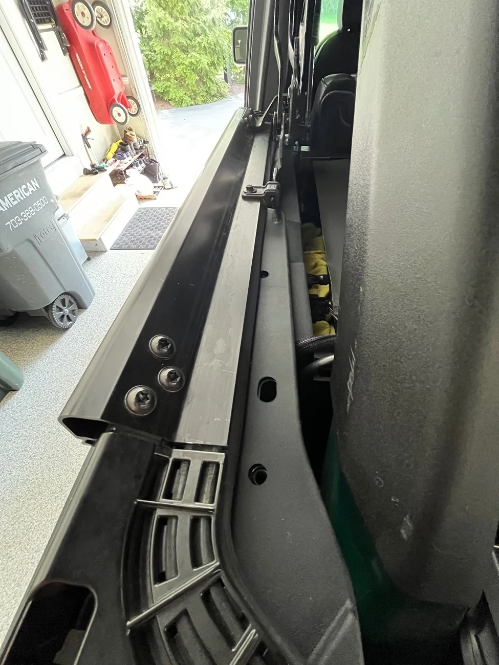

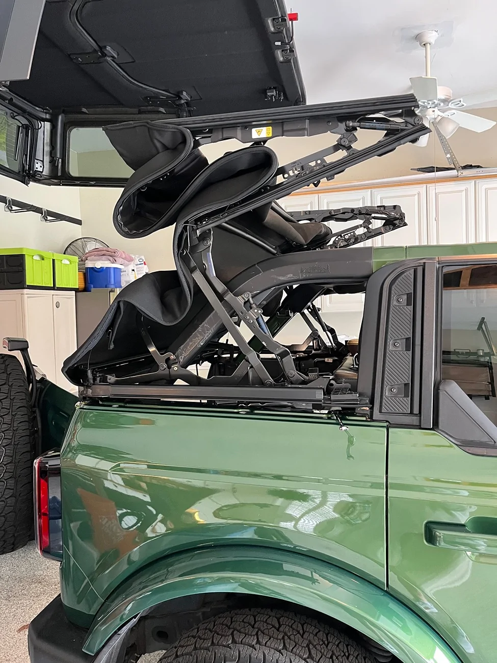

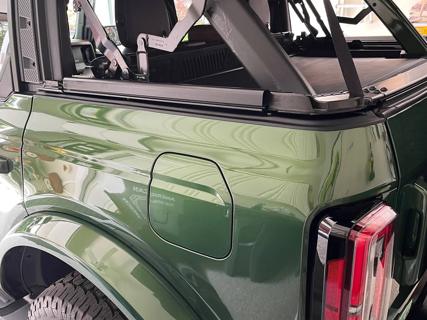

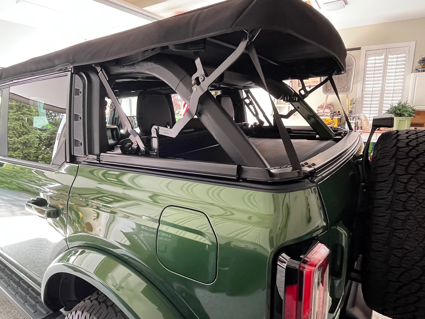

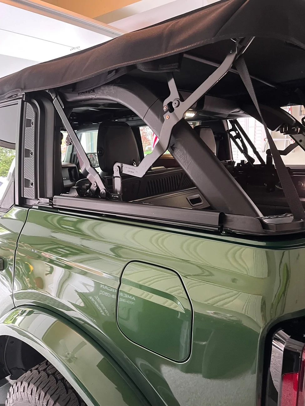

After making the switchover from the hard top to the soft recently, I decided to give these a try. I like them! I like the way they look, but I also really like the protection they offer now for the paint when switching tops. The HT isn't a big deal because it's all plastic under it, just guiding it into the frame holes and then bolting down. But the soft top is a different animal. Heavier, clumsy, and metal mounting and frame. No margin of error to the paint if a mistake is made. At least with these tub rail covers, you'll have some forgiveness. Not hard to do. Just make sure you thoroughly wipe down the area with a rag and alcohol to make the tape grab and hold. Mine stuck to the car very well, no issues. For the dual top guys, I do recommend them. You can see how scratched up the roll bar covers are already, and I've only gone 100% retracted maybe 3 or 4 times ever. The whole area is ripe for damage. Ford could've done a little better job on that design aspect. Thankful for the aftermarket world.
I ordered the 4-door version, and the holes all lined up fine. I can see where the HT holes are ready for it as well already.

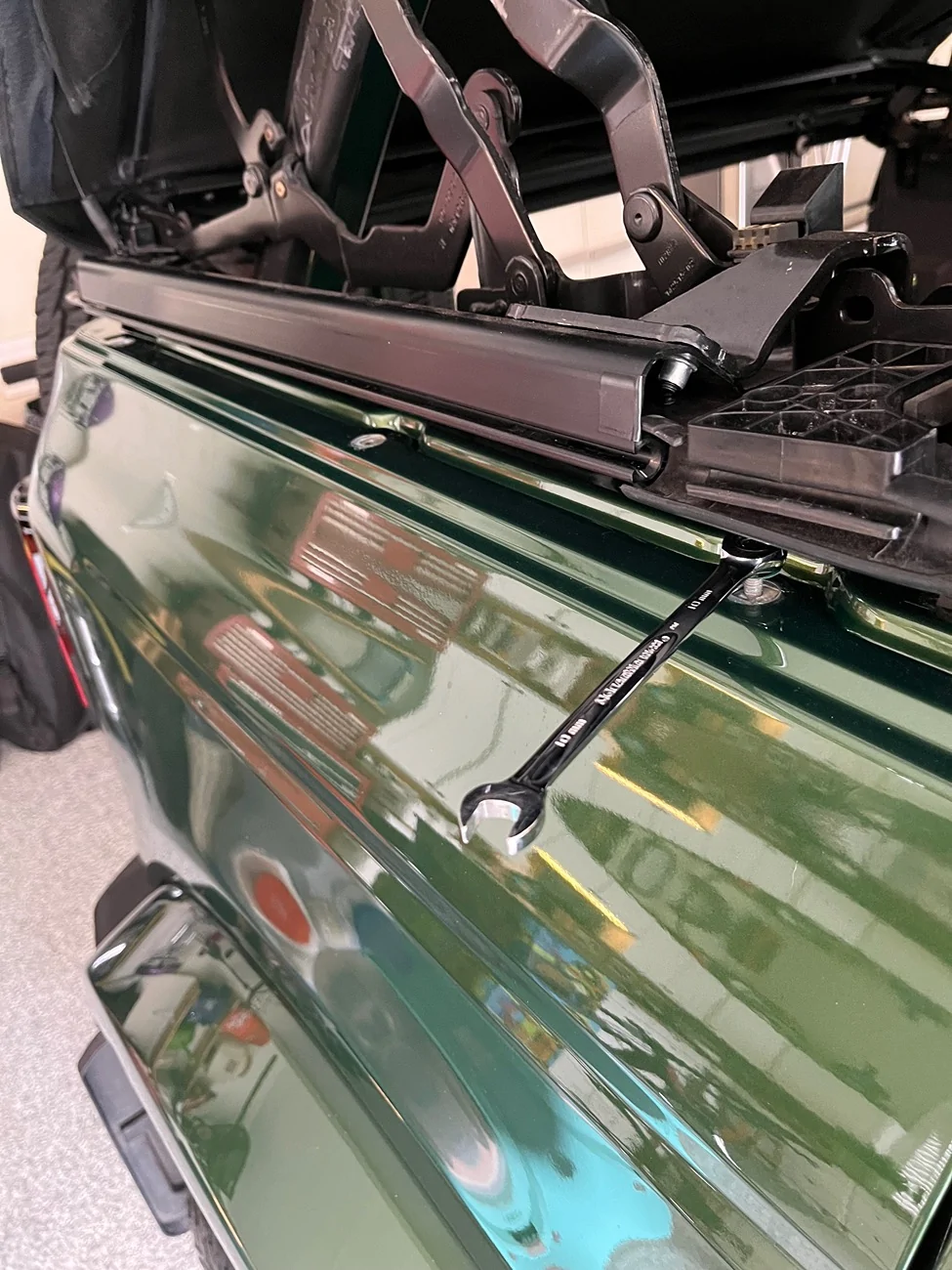

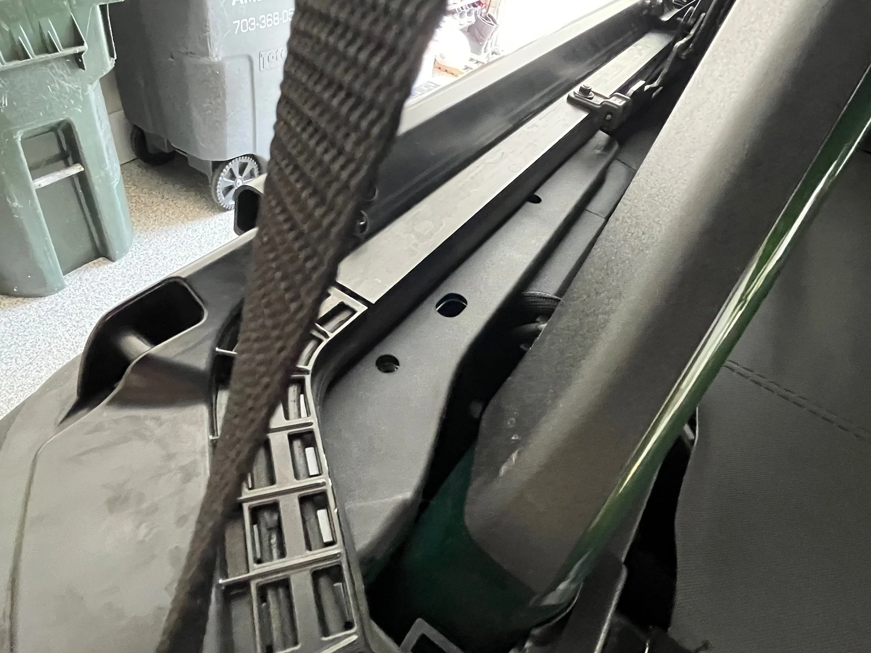

PS: if you're interested in it and don't want to take off the top, you'll need a 10mm ratchet wrench to slide under to get the bolts off, and then reinstall. Makes it easy, and you just have to remove the mounting bolts to the soft top on the inside and mess with lifting it up a little, not a lot. Also note, it's worth the money for a little touch up paint pen from the dealership. It'll strip the paint off the bolts once you take them off, but a little touch up, and all back to new again.

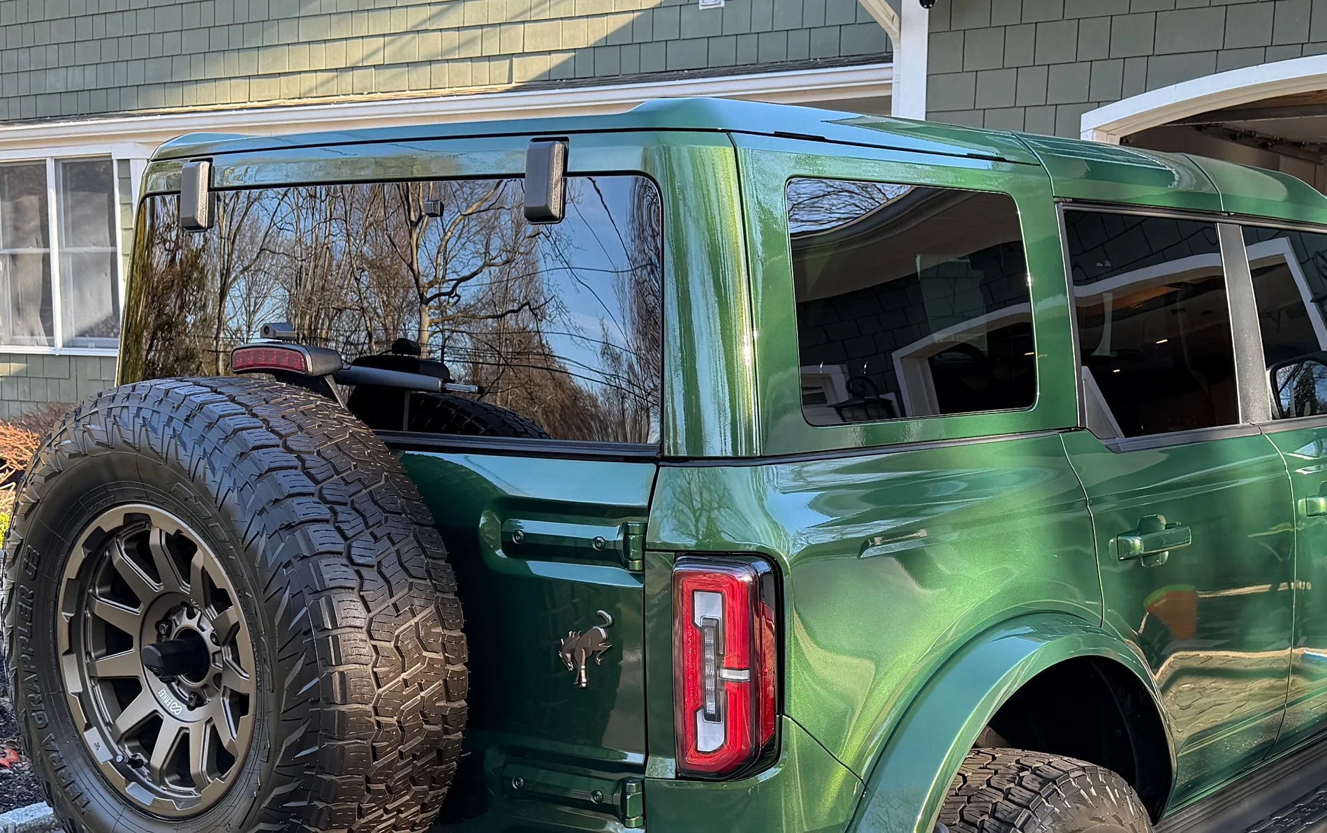

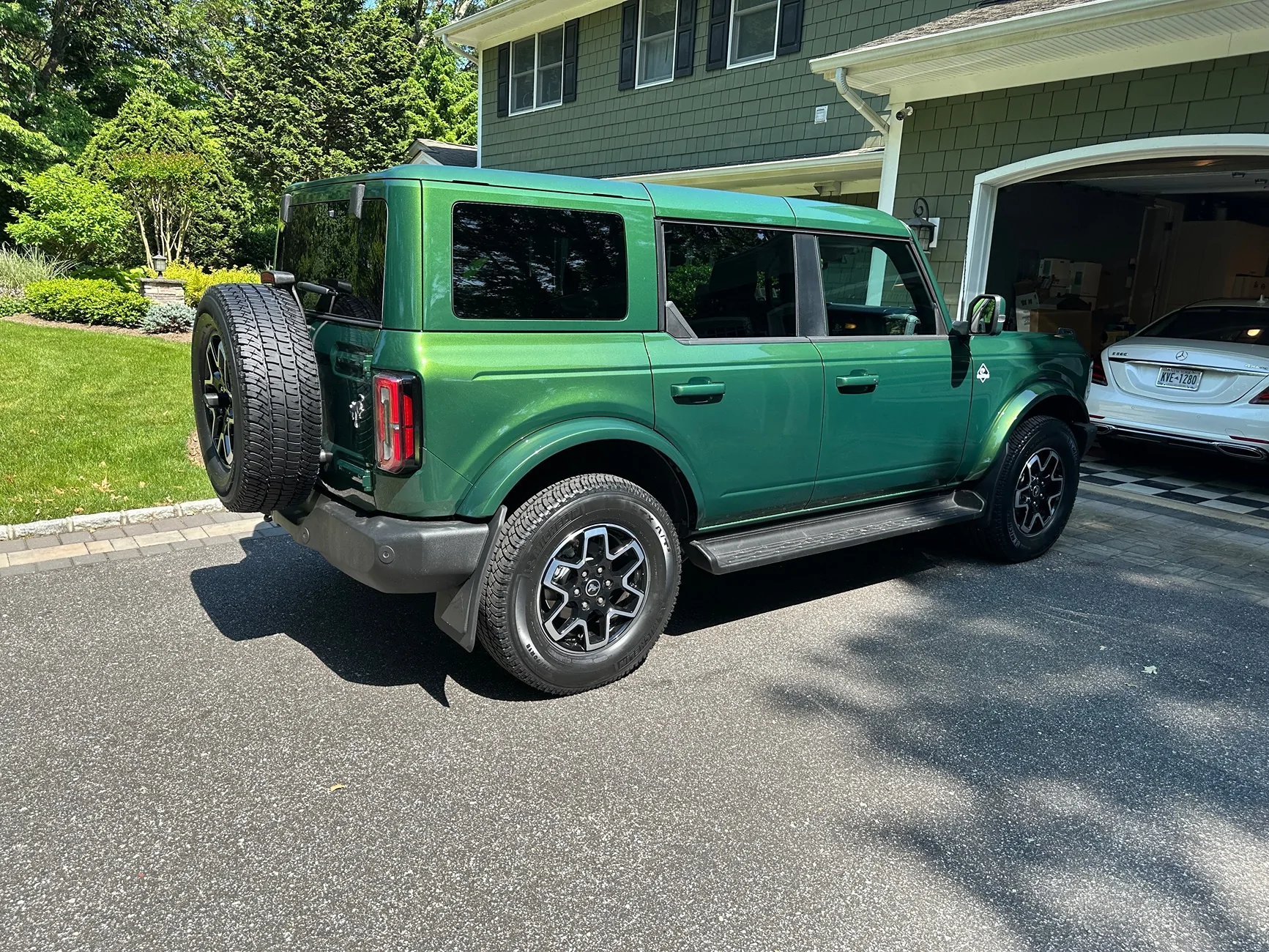

I have the Mabett version and they work as advertised. I have seen some people cut larger holes to fit around the painted bolts so they don't have to remove/chip the paint. I didn't and regret that. One thing painted top people should realize is the plastic lip is always visible outside the truck. So previously where your rear fender meets the top it was just paint to paint. Now there is a piece of plastic trim in between. Not the worst look but I preferred the cleaner look stock. Inside looks much better though, not as raw metal as before.

I like your style!!! Good looking garage you've got there!
