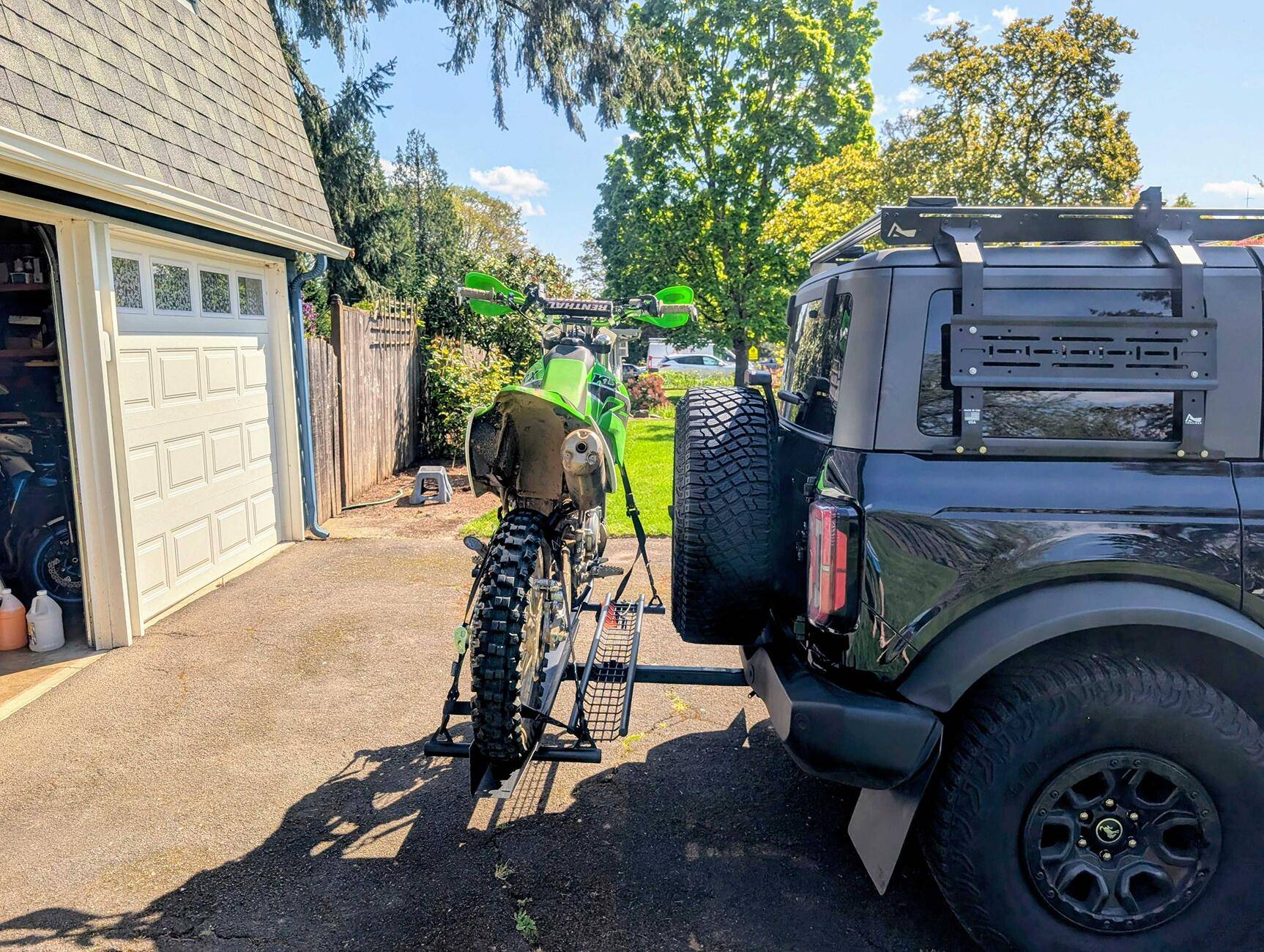

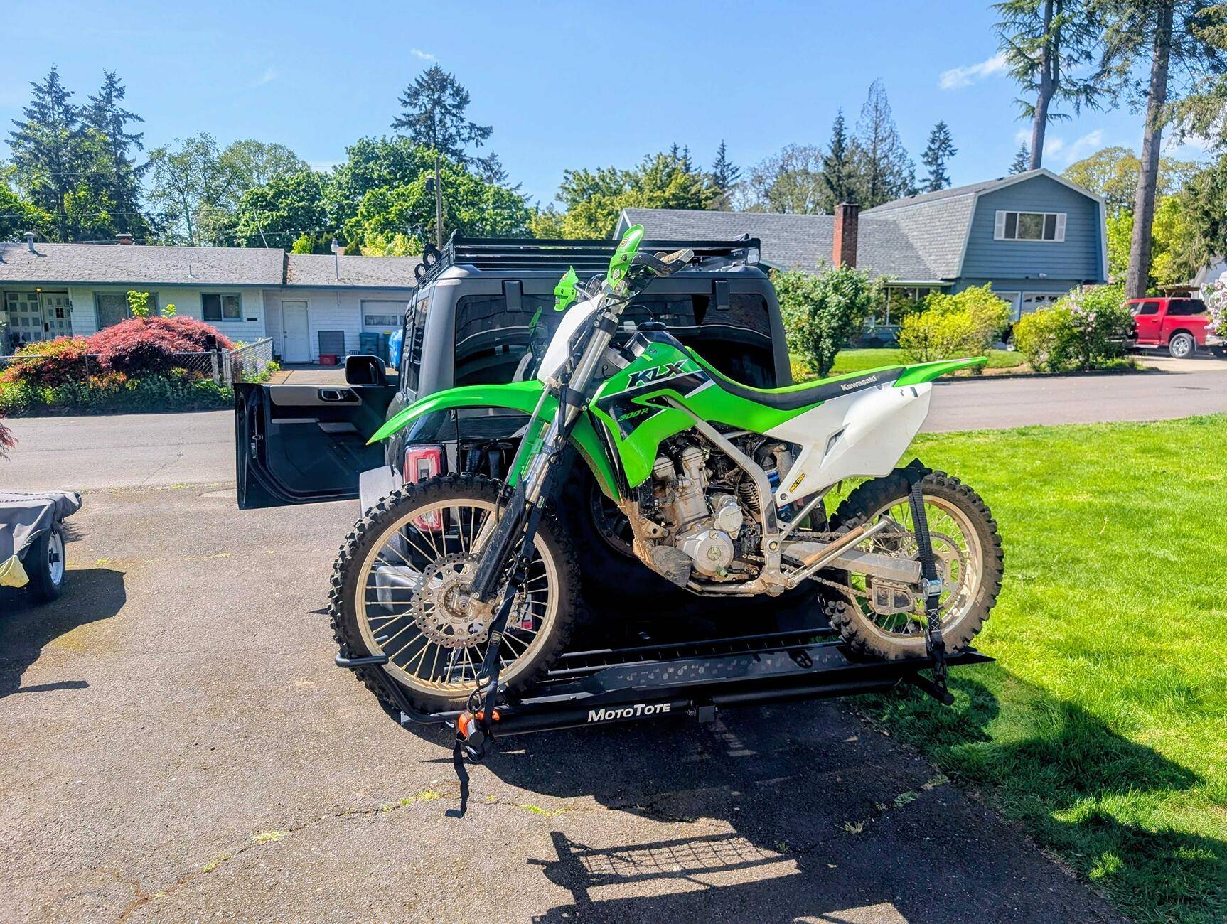

I posted this elsewhere as a response, but figured this is a good thread for consolidation of what folks use and will add it here:
I have the MotoTote M3 and it worked great for my recent ride. About 90 miles round trip. I know I'm at or slightly over the calculated weight with the tank of a bike the 300R is plus their optional extension arm. But didn't notice any difference with the handling on a road I've driven many times in the past (crappy pavement, washed out areas - HWY 6 here in Oregon heading out to the coast).
Super happy with results and way easy to load even with the SAS suspension bringing it up a bit than non-SAS.
It's also great I can just push it up there and lean against the tire and still have a couple inches clearance of the handlebar against that back window.
Nothing but good things about the rack itself, super sturdy so far and it doesn't rock back and forth much when taking turns/corners.

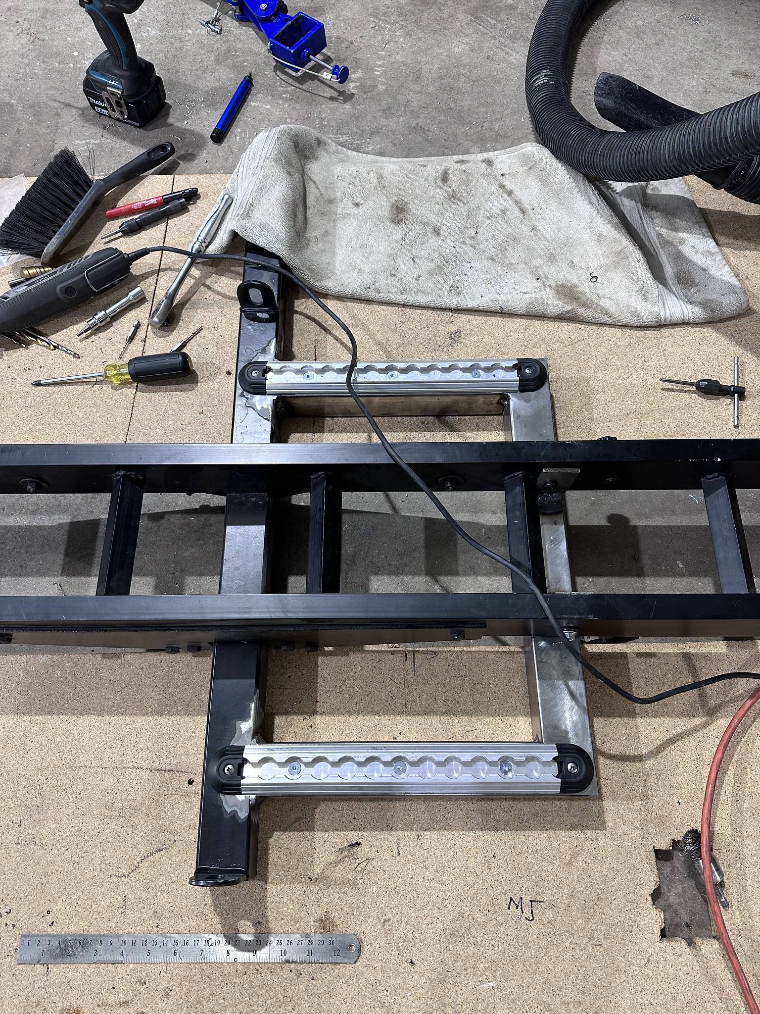

Yup that's my favorite part about my setup too, easy to lean the bike against the tire.

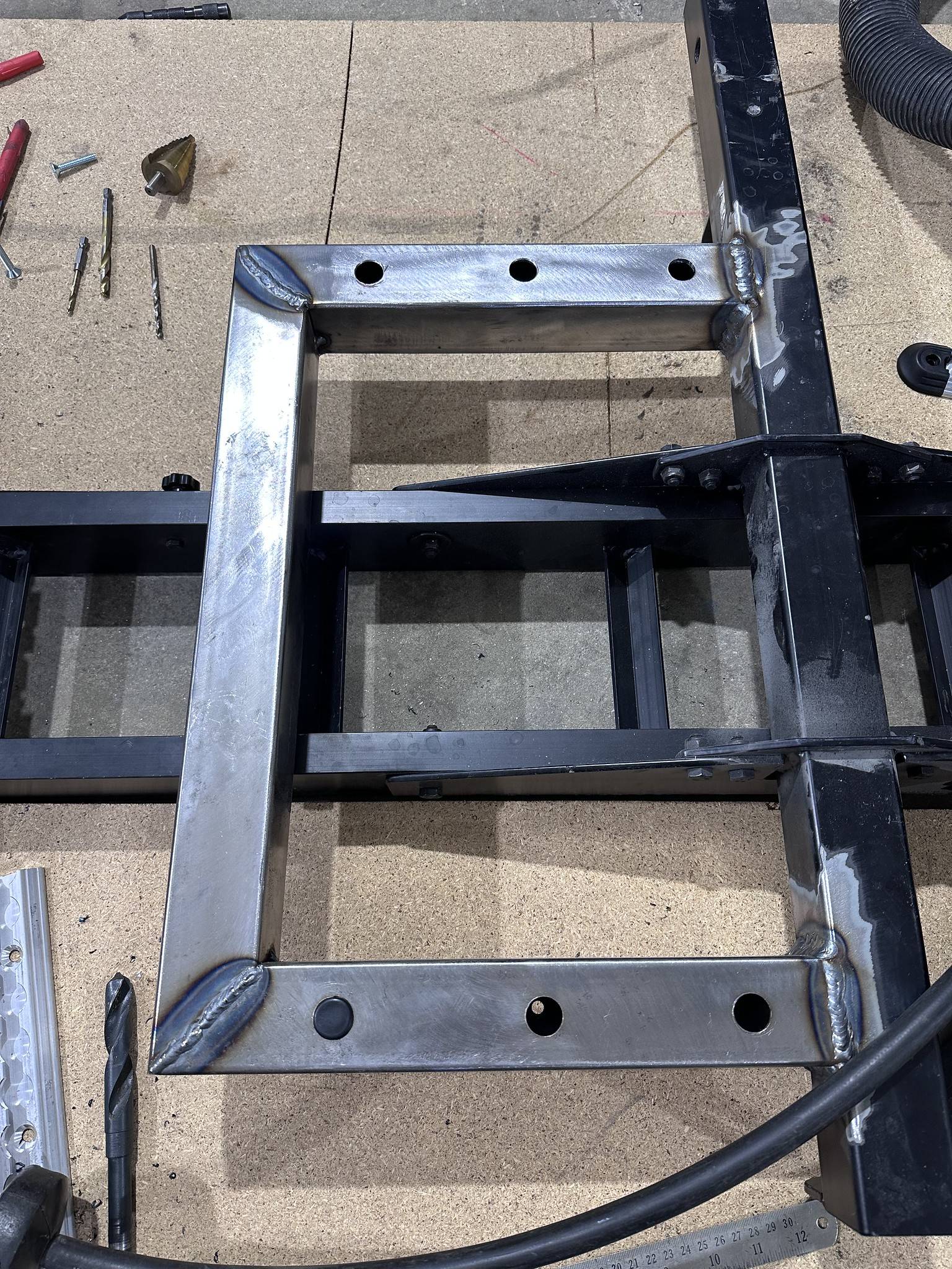

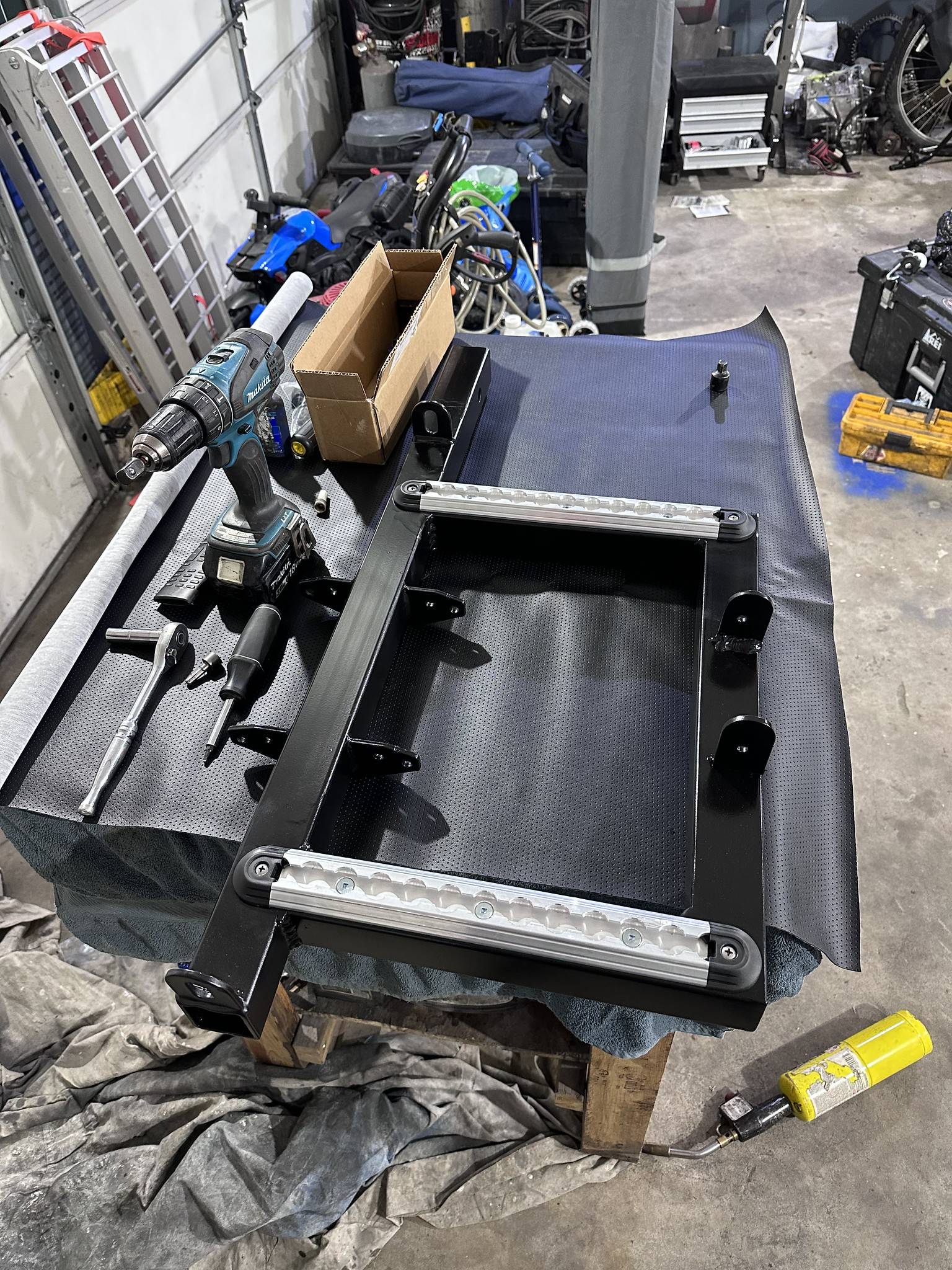

It looks like I never posted the mods I did to my carrier in here.
I welded up extensions to my carrier to mount my bike binderz. Now loading and securing is under a minute.

The f150 bracket ius welded on now too and had the whole hitch powdercoated black as well. Can see it in this pic:
