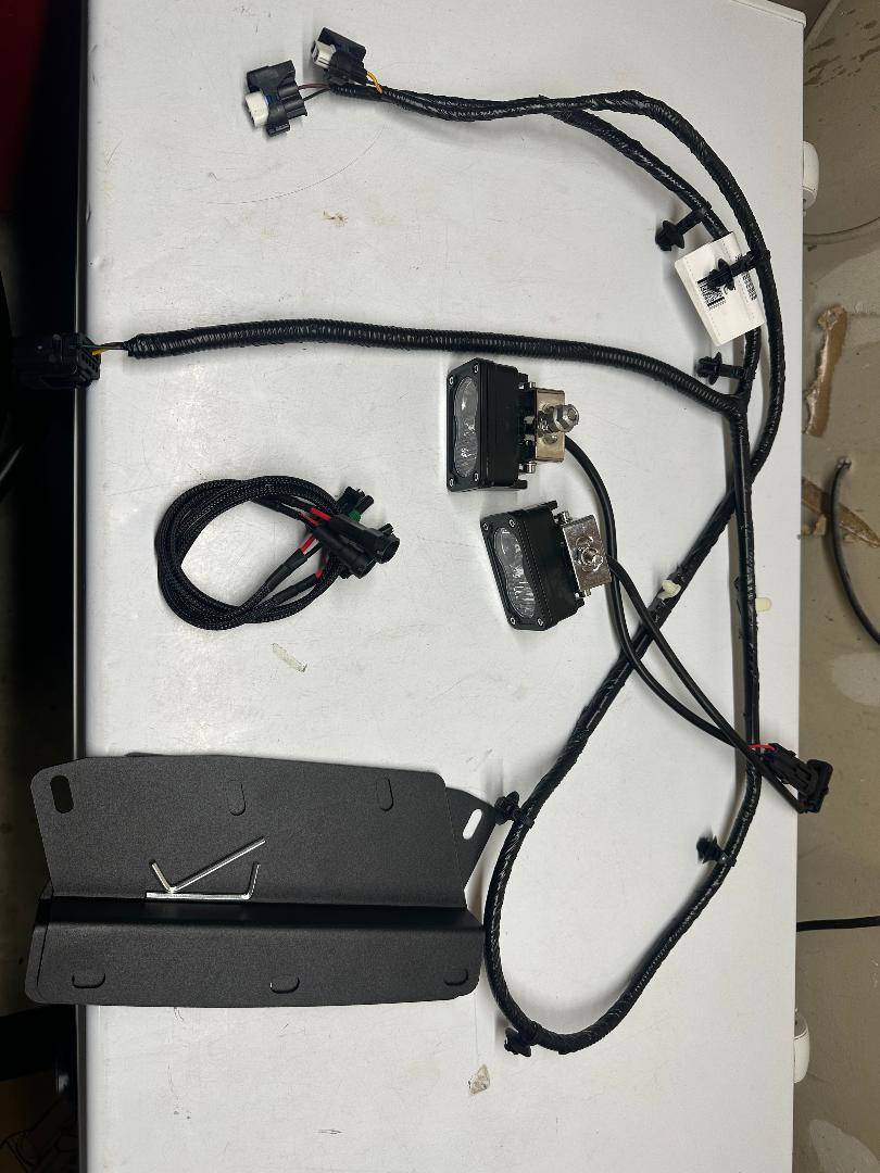

Yes as everyone has said quick and easy, I have a BD like yours and the wire harness plug for the fog's is on the Driver side above the bumper. I removed my harness from the capable and I'm going to re-use it for a set of fog's in the MOD soon.

Awesome, I’d like to do the same. Are there lights that will plug into the factory harness?
No I had to buy some pigtail adapters from 4x4 Truck LED's for $20 to do the job easily.
CrystaLux WP 2-Pin to H11 Pigtail, Pair (2021+ Ford Bronco w/Plastic or Capable Bumper) - 4x4TruckLEDs.com
I have everything ready to go just waiting for some nice weather to install. Cheap fog lights from Amazon that are S2 Baja Design look a likes, I also have 2 sets of Squadron Pro's I'll be putting in with them.
