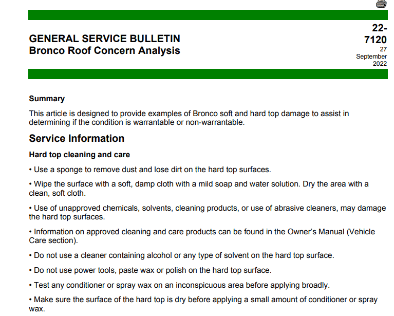

I went to this TSB and it says to use approved products on the hard top. Went to the Vehicle Manual, under Care, it DOES NOT list any brands of products to use.
I have been using 303 Protectant on the hard top. 2 treatments since picking up my Bronco in July. It seems to be doing very well, a light shine and has UV protectant. When I received my Bronco the top looks very good, but, if you look really hard, you can see a very light honeycomb look to it. I am going to believe this is normal.....but not as we have seen in many photos.
I know others here are using 303 Protectant also.
ANY OPINIONS ON USING 303?
If Ford suggests they have a list of products to use, then maybe they should provide it.
In the Manual they do list in a generic section all Motorcraft Brand products, but, do not state anything specifically to use on the hardtop.
Below: See bullet point #4:

PDF-ified... not everybody has Word.
Summarized for everyone... some may have some hope:
Ford is not responsible for pretty much anything that happens to your top...

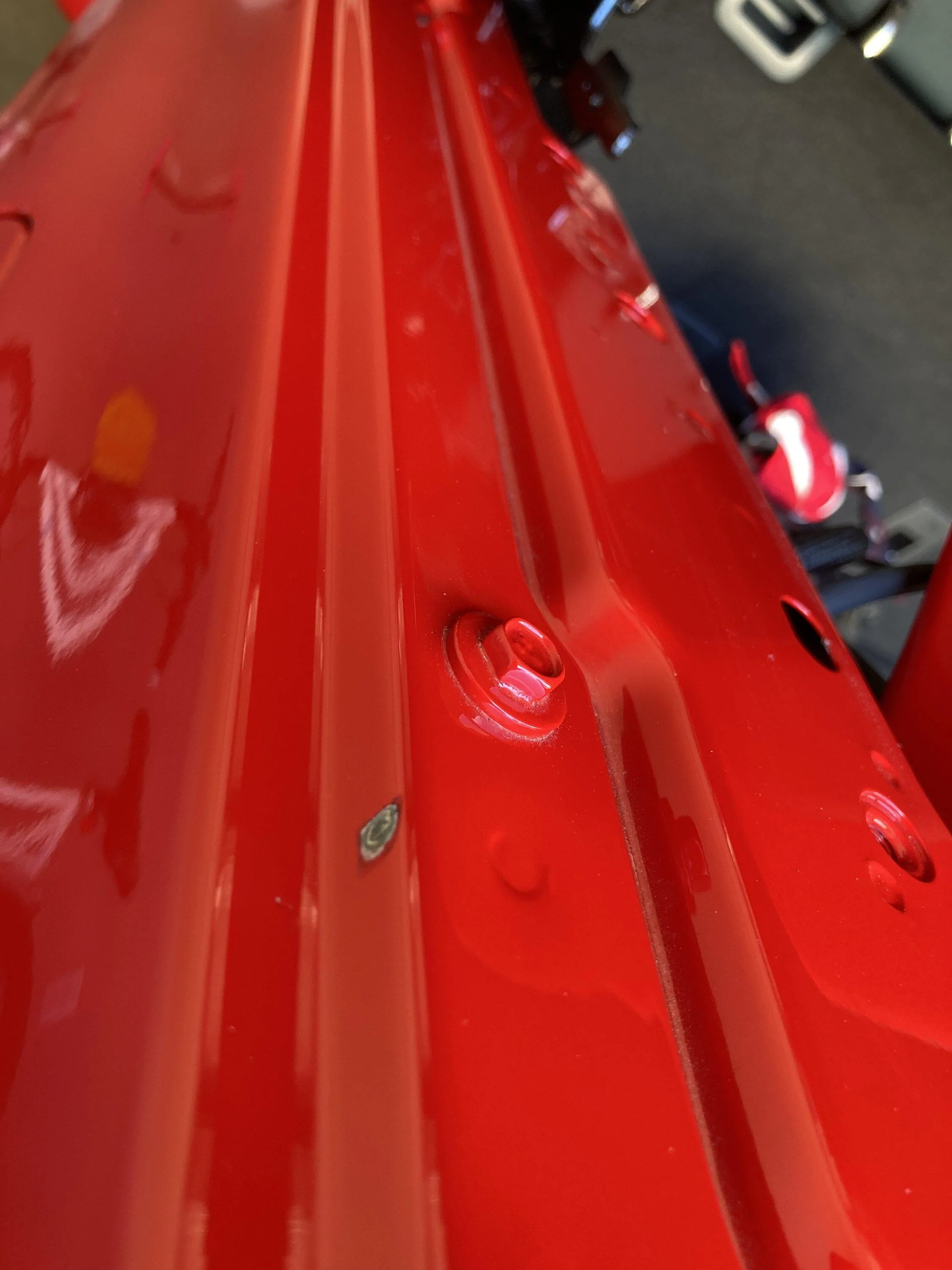

i'm taking mine in tomorrow for this soft top edge wear issue as well as the soft top rubbing my paint at the rear fender top on each side.
flip
Base Sponsor (Level 1)
Phil
4,839
16,033
IN
www.ruxerparts.com
Fords
I suggest putting a strip of PPF/Clear bra on the top of the rear quarters for either top setup to help avoid the rub.
