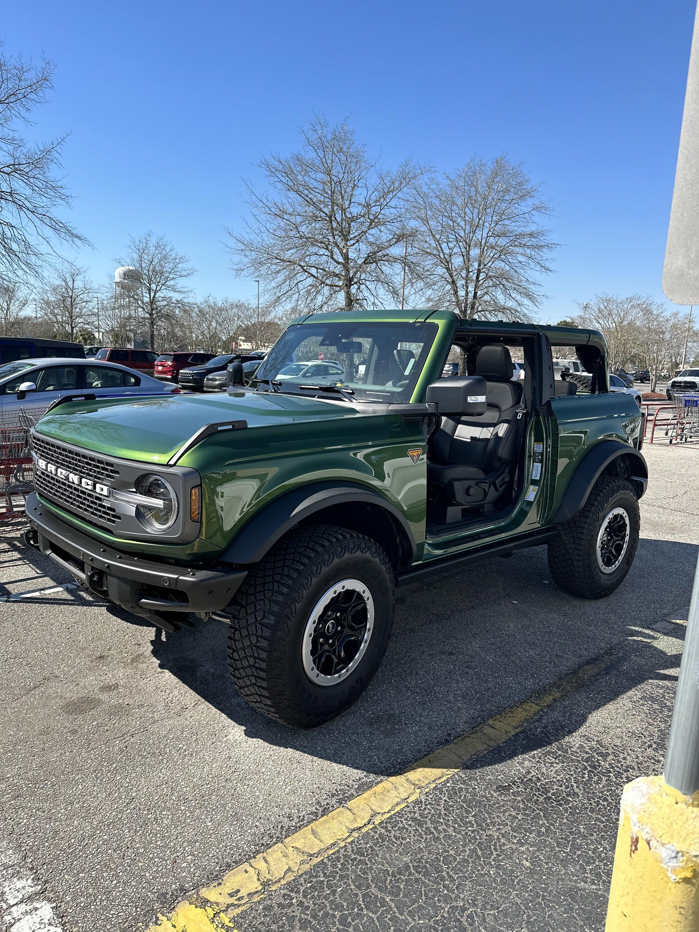

Good timing, because I just joined the club, just waiting on consistently warm temps (it's 38 this AM), and I'll have a pretty close to matching photo.

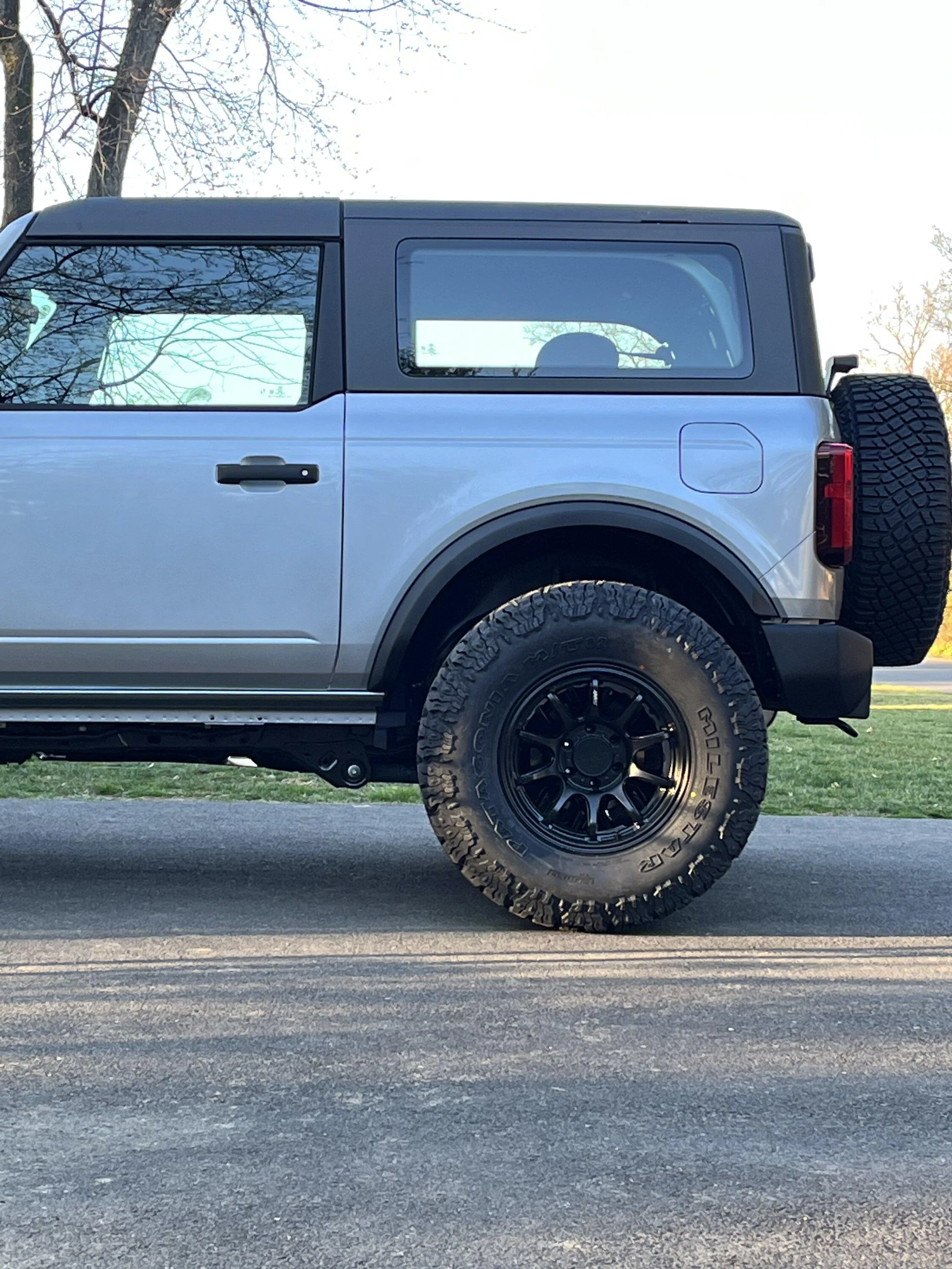

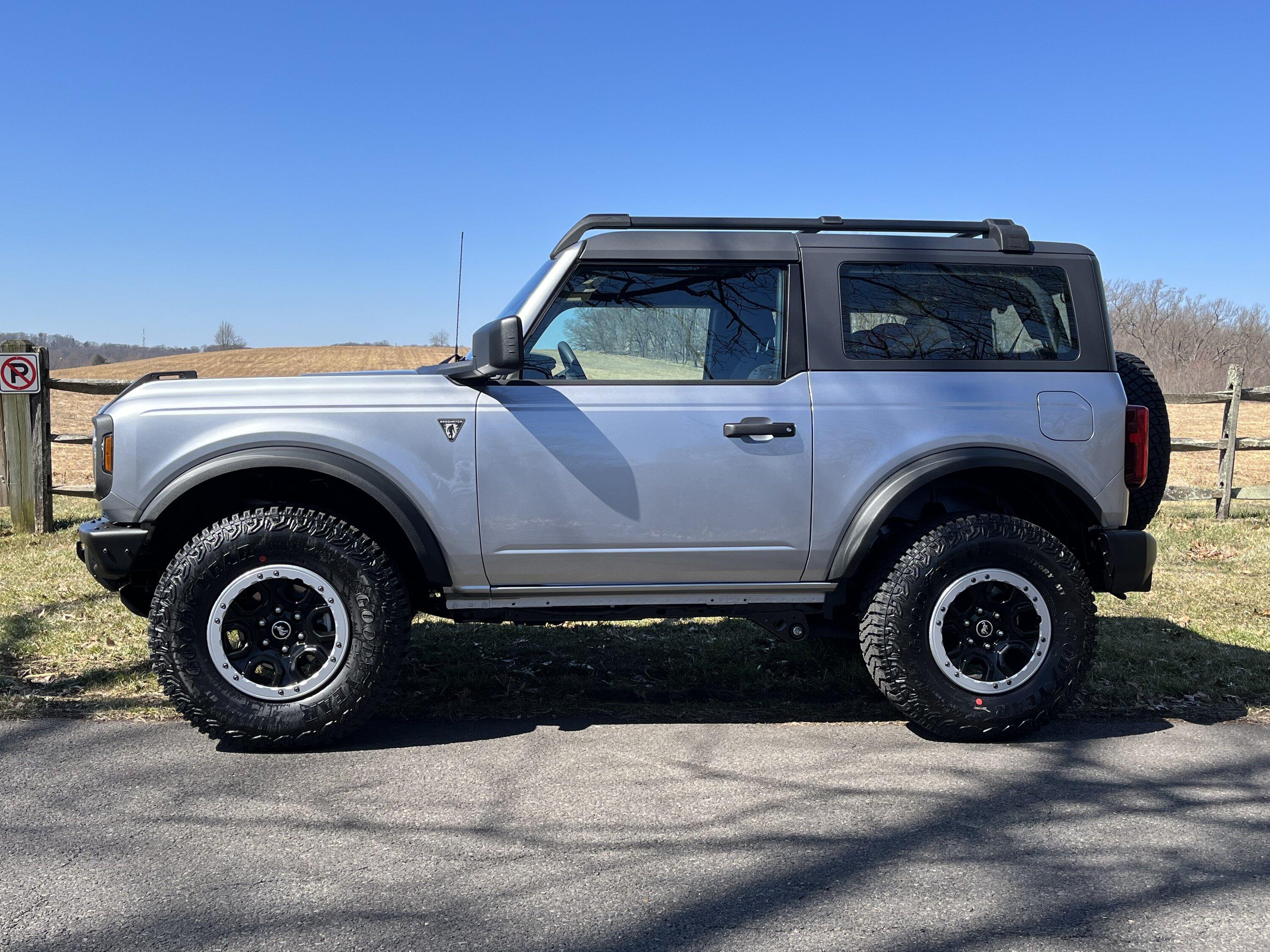

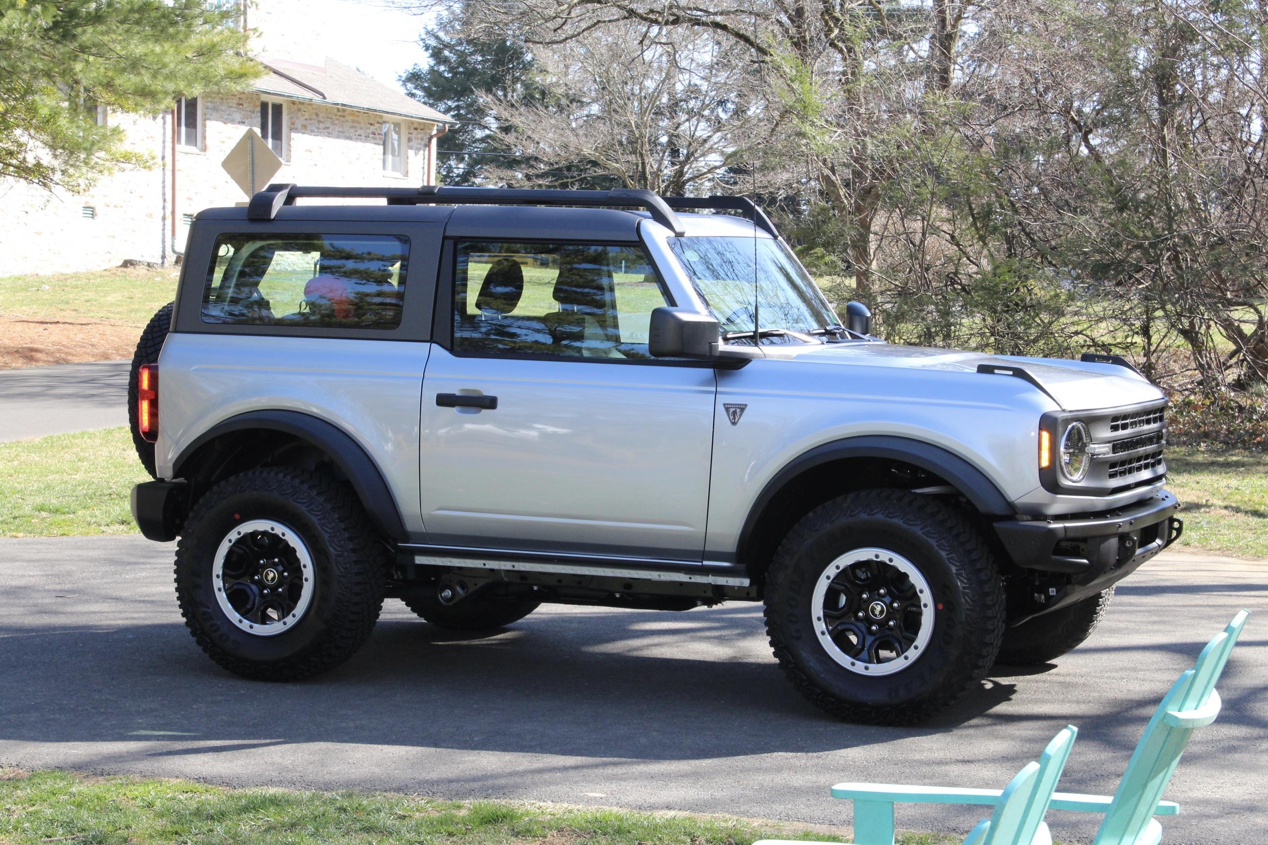

Finally got my iconic silver 2 door base Mansquatch yesterday. Loving it so far. Only problem is they forgot my up fitter switches 😡. Other than that and not fitting in the garage with the roof rack I love it. Did a little mock of what it’s gonna look like with new wheels/tire combo and I think it’s gonna look sweet.

Not sure I can find out. Will the dealer own up to it if they did ? I’m gonna have to go through my emails and see if I can trace back where the disconnect happened. Problem is that I ordered over a grand in lights and now it becomes a much bigger installation. Super frustrating.
