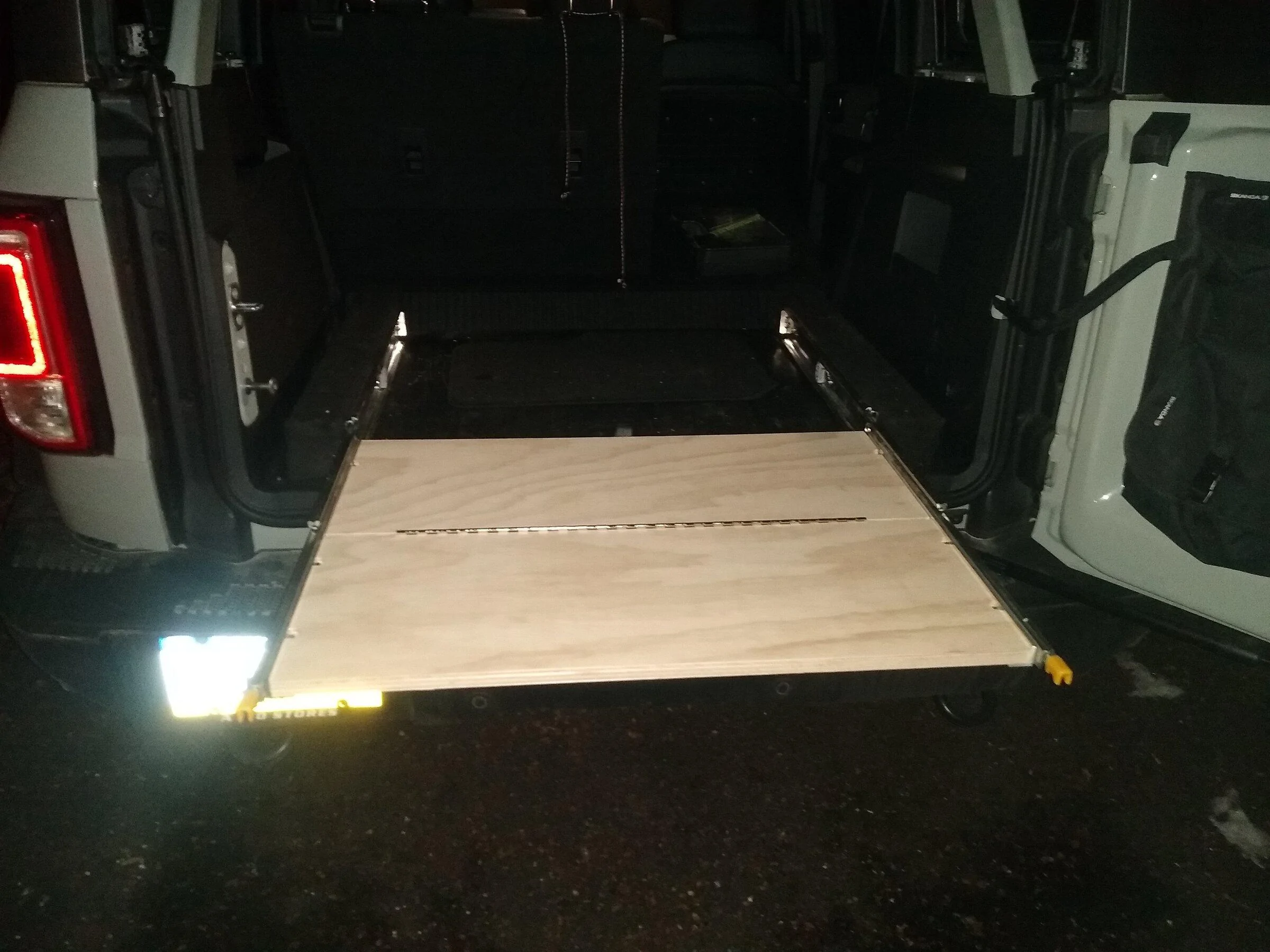

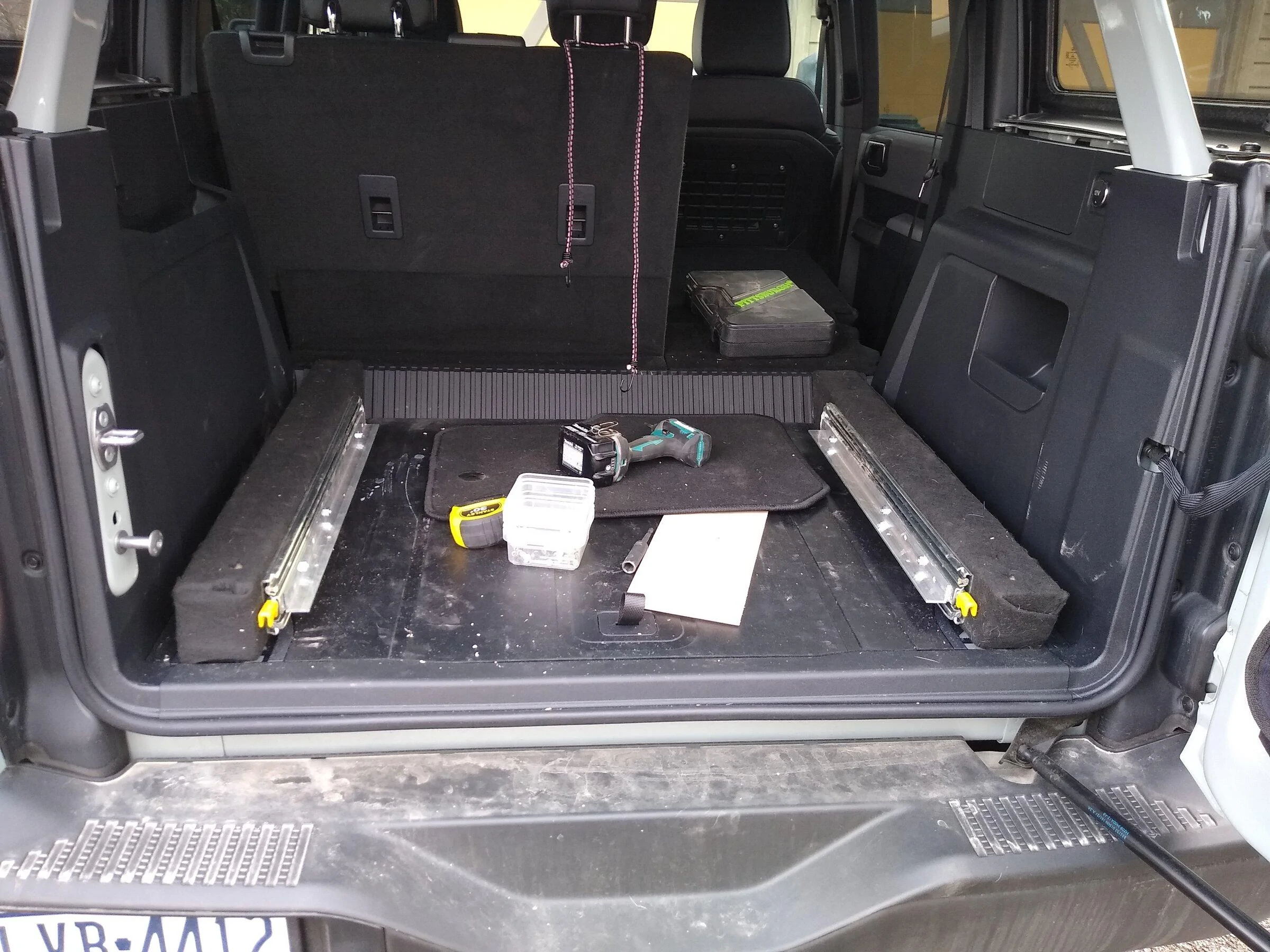

I'm still working on my copy. It's slow going with a baby and with my shop far away from the parked bronco. Lots of walking back and forth.
I had to order more carpet, one 40"x70" wasn't even close. Two of them should do it.
I also cheaped out and paired up 2x4s instead of getting a 4x4. Can't tell now that it's carpeted and they're glued and screwed together.
Edit - all in, with getting gouged from my local small-town hardware store, I'm probably in for 110% of the Ford sliding tailgate.

Nah I was somewhat kidding. Although I had plywood on hand a sheet can be like $70. $100 for slides. Hardware can be like $50, $40 for carpet etc etc.
Lots of trial and error, and fun in the 15f temperatures. I have a heated garage, but that's even further away from the shop -.-

Still waiting on more carpet to cover the top piece, so this is as far as it will go for now.
Observations -
Can't attach the angled aluminum with the rear-most hole. Why do they drill that hole...
1/2" hardware is long enough to mount the angle aluminum.
Mistakes -
Didn't buy enough carpet.
I mounted the angled aluminum so the bottom was flush with the slides. This results in the bolts too high in the plywood. I tried so hard to notch it without breaking through but it was sooo borderline I just went through.
I may eventually swap the seat with 1" thick hard maple. That will allow for hidden notches and be stronger.
