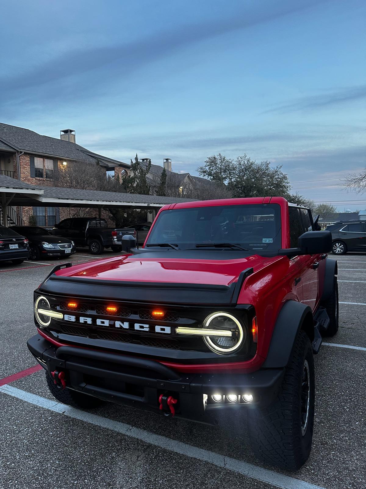

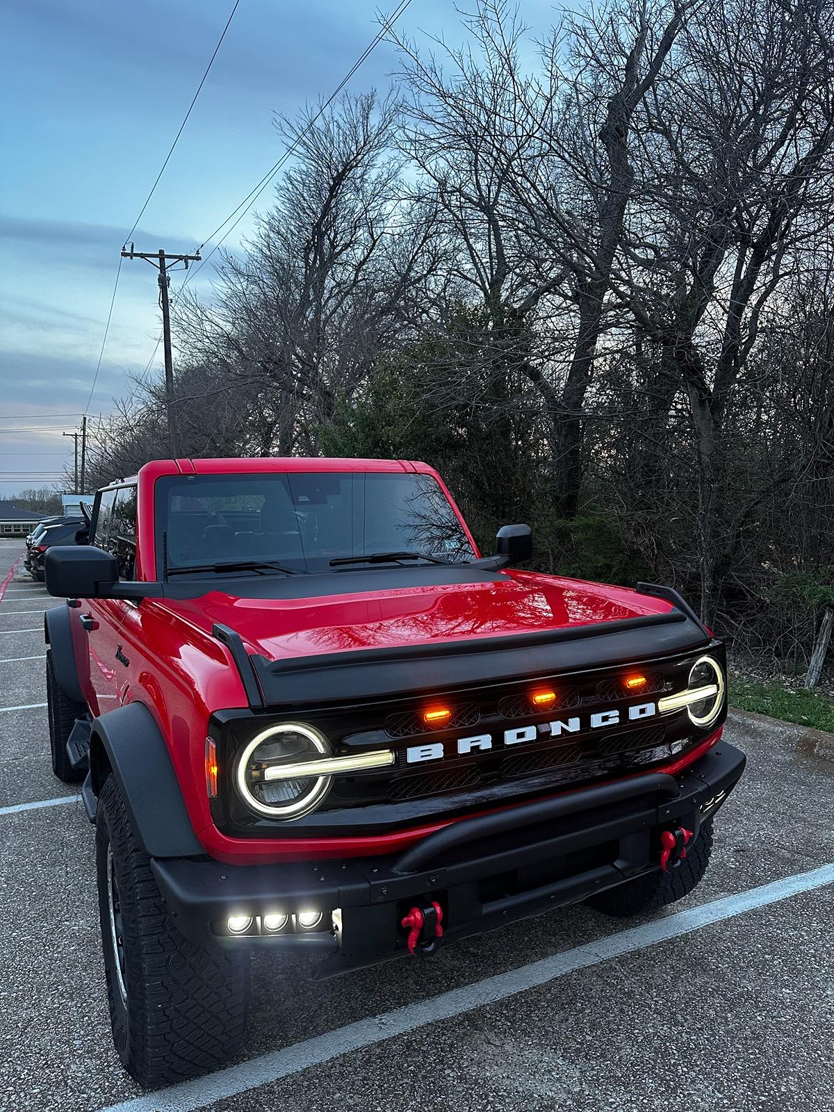

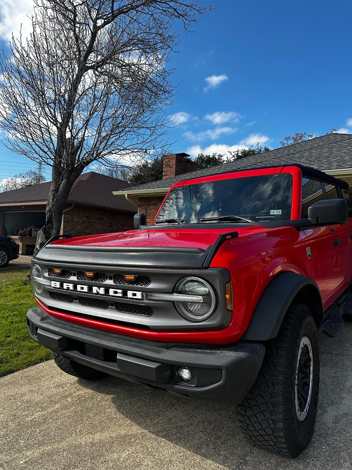

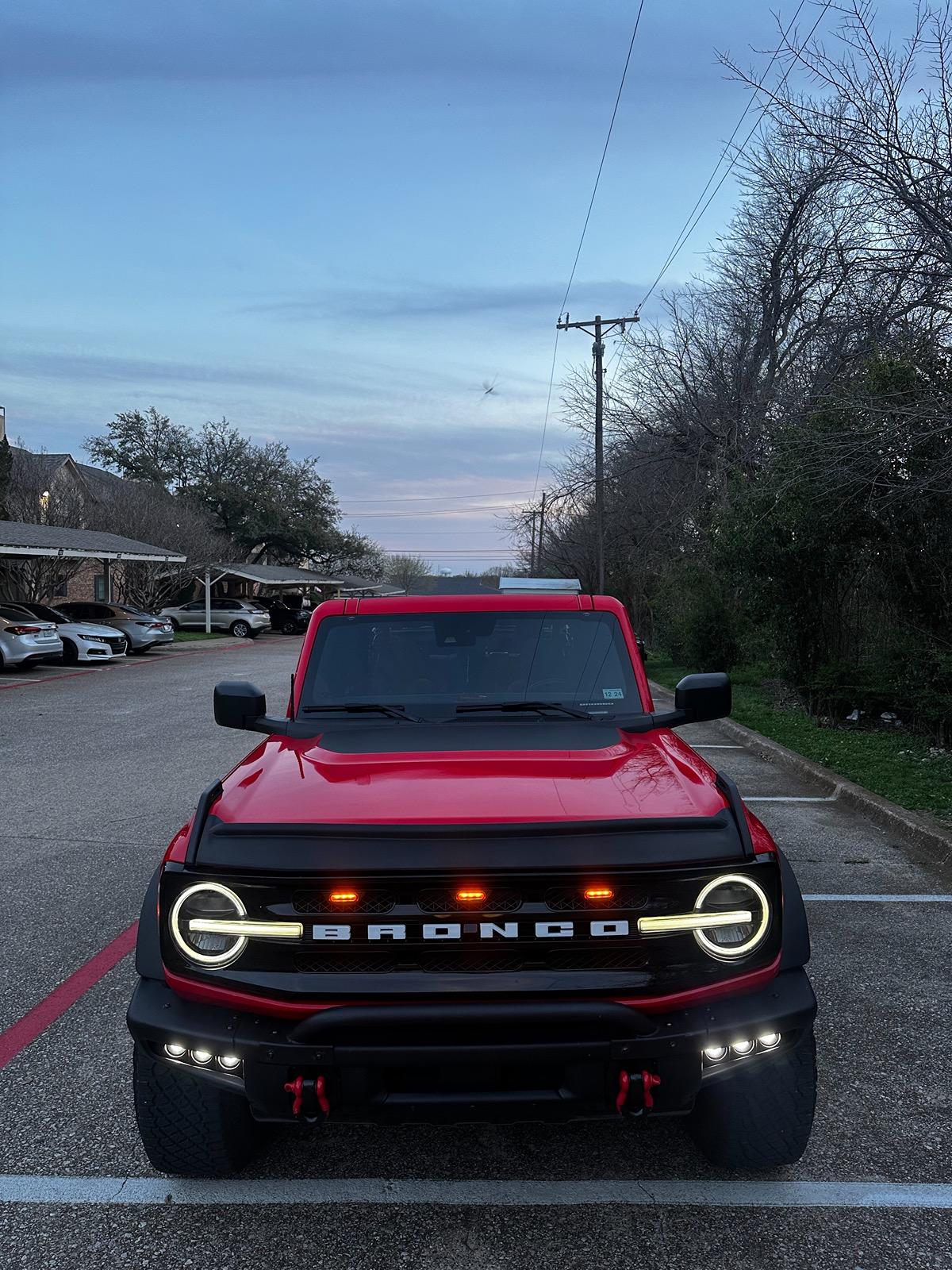

The bumper arrived without any instructions, just 3 main pieces, and a bag filled with screws, washer bolts, and clips. I bought it on eBay, and fortunately, they had a video on how to install it. The video wasn't the easiest to follow, but after a few replays, everything made sense. I made a few mistakes along the way and had to screw and unscrew the pieces back and forth, which was tedious, but overall, the installation was straightforward. The bumper itself is made of solid steel, with no damage, scratches, or dents. It's also quite heavy. I also ordered fog lights from Amazon and a bull bar from eBay, and the placement was perfect without any issues. When it came time to install the bumper, the fitment was perfect with the three OEM screws on each side that come from the Bronco itself. I neatly tucked away my OEM wiring harness (although I had to screw and unscrew the bolts several times, which was annoying for correct placement), but once everything was set and done, it was a simple swap. I cut off the OEM hooks and sprayed them to avoid rusting. I ensured that the gap between the bumper and the grille was even and symmetrical to both sides' fenders. Overall, if I had to do it again, it would be much easier and well worth it for the price. I'm happy with it. I also used anti-seize lubricant on all the screws to prevent rusting. I recommend this to anyone searching for a modular bumper and either having trouble finding one or not willing to spend $600+ on it. I hope this
helps! PS: This did not come with the sensors. My Bronco does not need them.
For fogs without an aux:
The (OEM) harness remained untouched and came from my plastic bumper fogs. I purchased adapters that connected to the OEM harness, and then I soldered (the adapter, not the OEM harness) to the aftermarket fog lights, which originally had a female end that I cut off. The aftermarket fog lights were wired for an auxiliary switch originally, which the Bronco did not have. So, after some splicing and soldering, the fog lights now work with the fog button located on the bottom left of the steering wheel. Red/black wire. Pretty easy. Just have to be patient and organized.

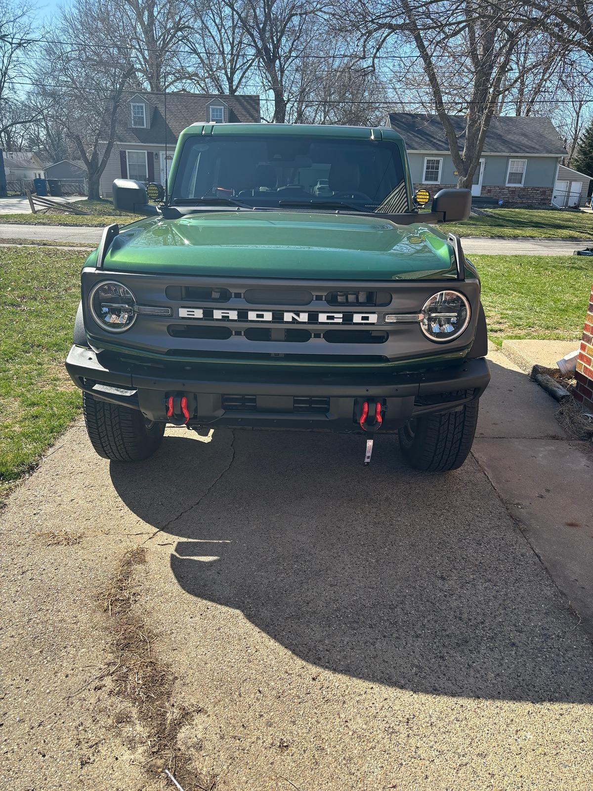

I have also recently bought and installed this bumper and it looks great!
Ford Bronco Bronco Knock Off Modular Bumper: IMG_0016

I haven't seen it mentioned, but I think it's worth noting that the ends of this bumper are designed very different from the original. The end pieces bolt onto the center section, I'm assuming to reduce the length for shipping.
sirius76
Bryan
Feb 5, 2024
47
Des Moines, IA
2024 Big Bend 2dr
Thats correct. There is another version floating around on ebay that is one piece at about $700.
I have been able to fit a prerunner type bar that was for OEM modular bumper with no issues. But YMMV
