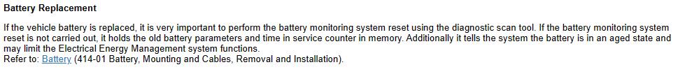

Battery replacement needs more than just a battery...........
Ford Bronco Bronco Completely Drained New Battery! 1713845135792-jx
