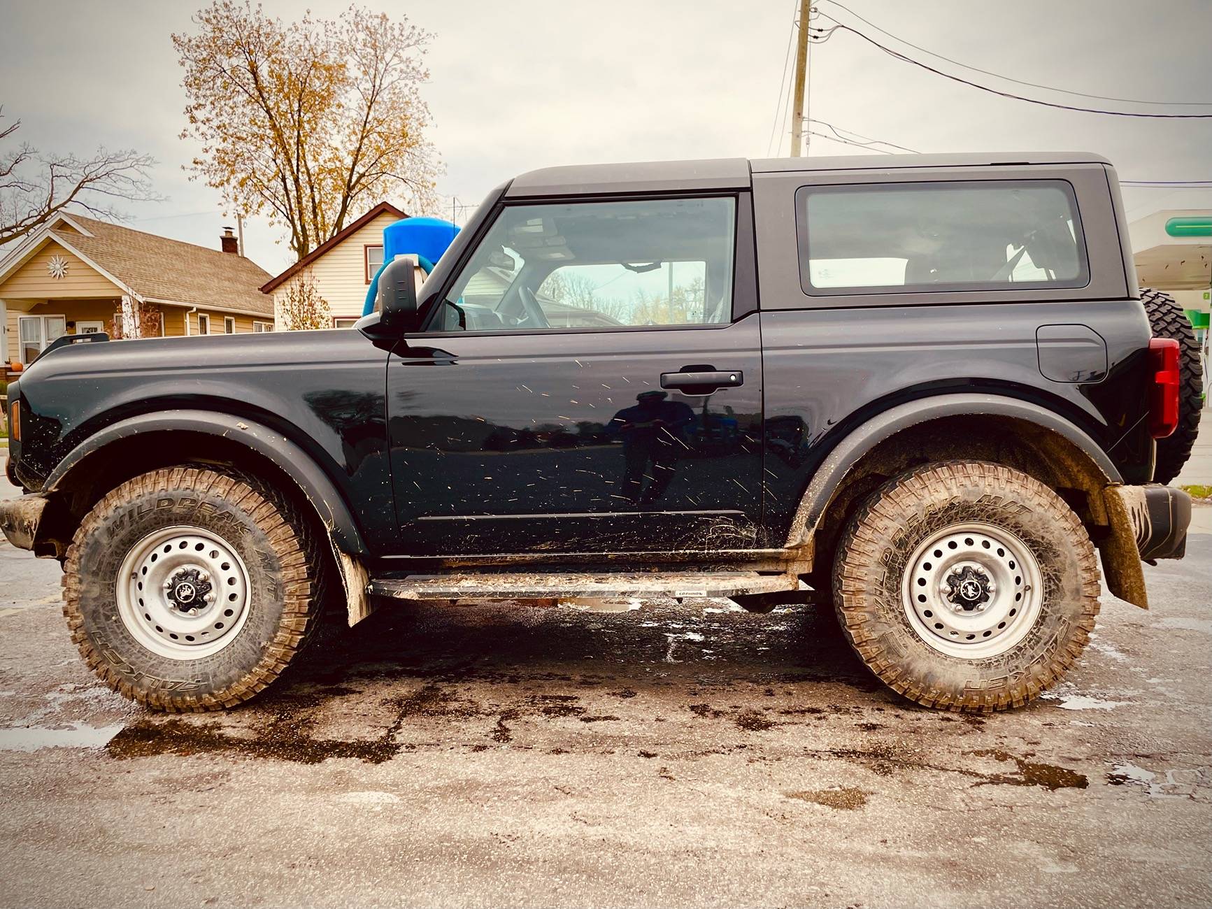

I have a base 2dr, 2.3L with the added weight of a front winch/mount, and OEM skid plates. Any shots in the dark which front springs (which 6G trim?) would be a good swap to level it out a bit? It makes more sense to me to swap heavier springs instead of adding front lift spacers. Here is what I’m starting with:
I'm in the same boat as you, just did the modular bumper Warn winch kit and ARB skid plates in my 2dr base 7MT, measured it dropped about 3/4"
Did you find any good solutions yet? I'd also prefer not using spacers, leaning toward just a lift kit where I'd go ~ 2" front and 1" rear to balance it back out

I ordered the Zone 1ā€ leveling kit. Assuming it will bring me back to factory rake. Once the 1ā€ kit was delivered, I immediately wondered if I should have opted for the 2ā€ leveling kit. So, I understand the ā€œleanā€ you’re feeling.
I recently swapped on a set of black diamond alloys (currently have the stock 265/70r17 Grabbers) but I’m replacing them with a set of 285/70r17 KO3 in a week or so. Adding the 1ā€ level kit after that.
My concern with the 2ā€ level kit is that I’ll then be tempted to install 285/75r17 tires. I’m not sure my 3.73 gearing would appreciate that…
