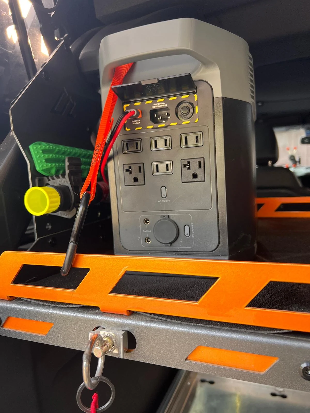

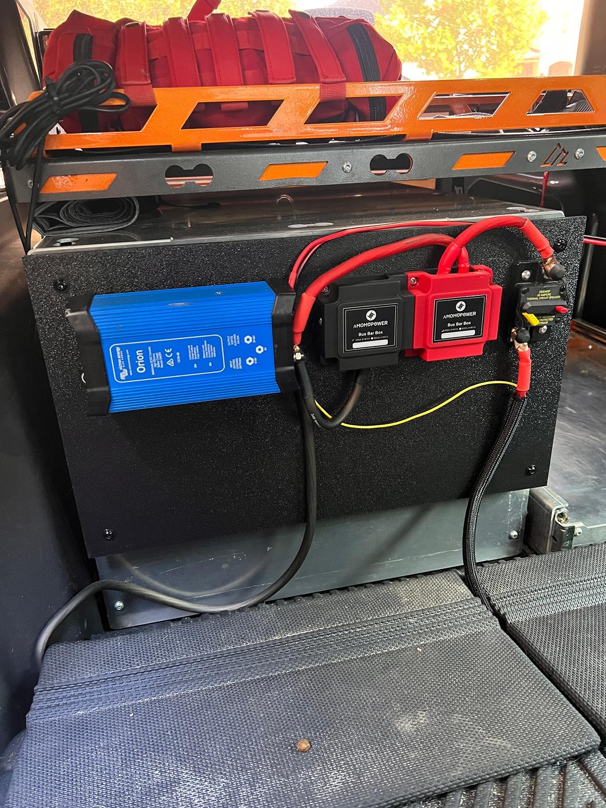

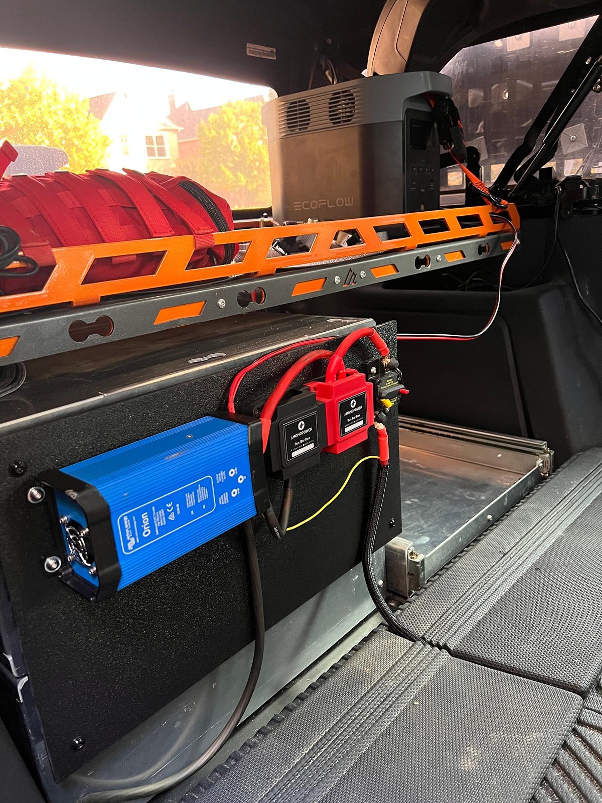

Ford Bronco Bronco AC outlet doesn't work with Ecoflow Delta 2 IMG_9155

I did exactly like what was shown in the YouTube video above. It works great. I ran a #4 AWG wire from my battery to the disconnect seen in the picture. I then routed to a distribution block and then from that distribution block to the DC/DC inverter. I then ran the PV wiring from the DC/DC inverter to the EcoFlow. The system works great. It charges at over 400W.

Forgot to mention, I also ran that yellow wire to the fuse box to have a trigger for the inverter. Since this photo, I have revised the distribution block and I actually have tapped off of it and ran a wire to the back area where I have a switchbox that controls various lights I use when I get to camp so that I can set up and cook when it gets dark.
