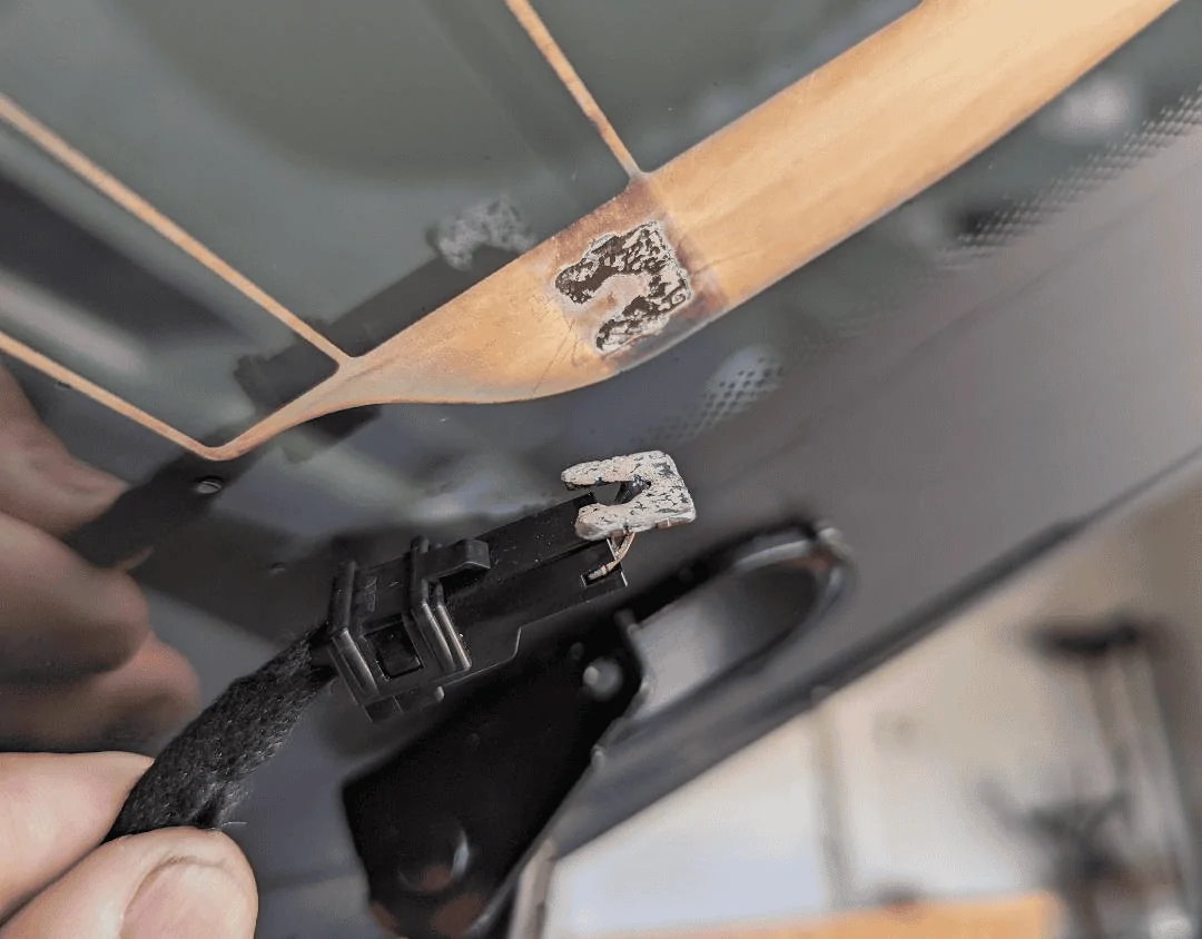

Autozone had a special permatex adhesive. It took me two tries but it worked well
I would like to try this versus haggling with my local dealer who did not repair when I had in previously for a service appointment to address this issue. I watched a video for using the Permatex adhesive & the process appears pretty straight forward. The first step is to disconnect the metal table from the connector plug by depressing tab & pulling out the tab. Instructions say to glue just the tab so their is no wire harness pulling on it while the adhesive dries. Then you reconnect. I cannot get the tab out of the connector plug base. @BroncoChallenger Did you remove metal tab? If so, how did you do it? Thank you.
My connnector came off on driver’s side with zero contact by me or contents in back end. Just noticed it dangling there one day when I was trying to identify a speaker rattle - which is another item that my local dealer did not successfully repair when I had in for a scheduled service appointment to address these 2 issues & an oil change.
I actually never bothered on the last vehicle I had where this separation happened, because I was getting rid of the truck and the dealer didn't notice it.
On vehicles I HAVE tried it on, I've had mixed luck, but yes, the metal tab MUST come out of the plastic connector first and have plenty of time to dry. It's been QUITE a while since I've done it so I don't recall any specifics. Sorry.

Sorry, but I can't honestly remember if I could get the lead off. I do remember holding the connector in place as long as I could and using painters tape after that. Like I said it took two tries, but worked. I have since added the plastic covers available from Stickerfab. They look good and protect the connection, although like you, mine just fell off and was not bumped or anything.
