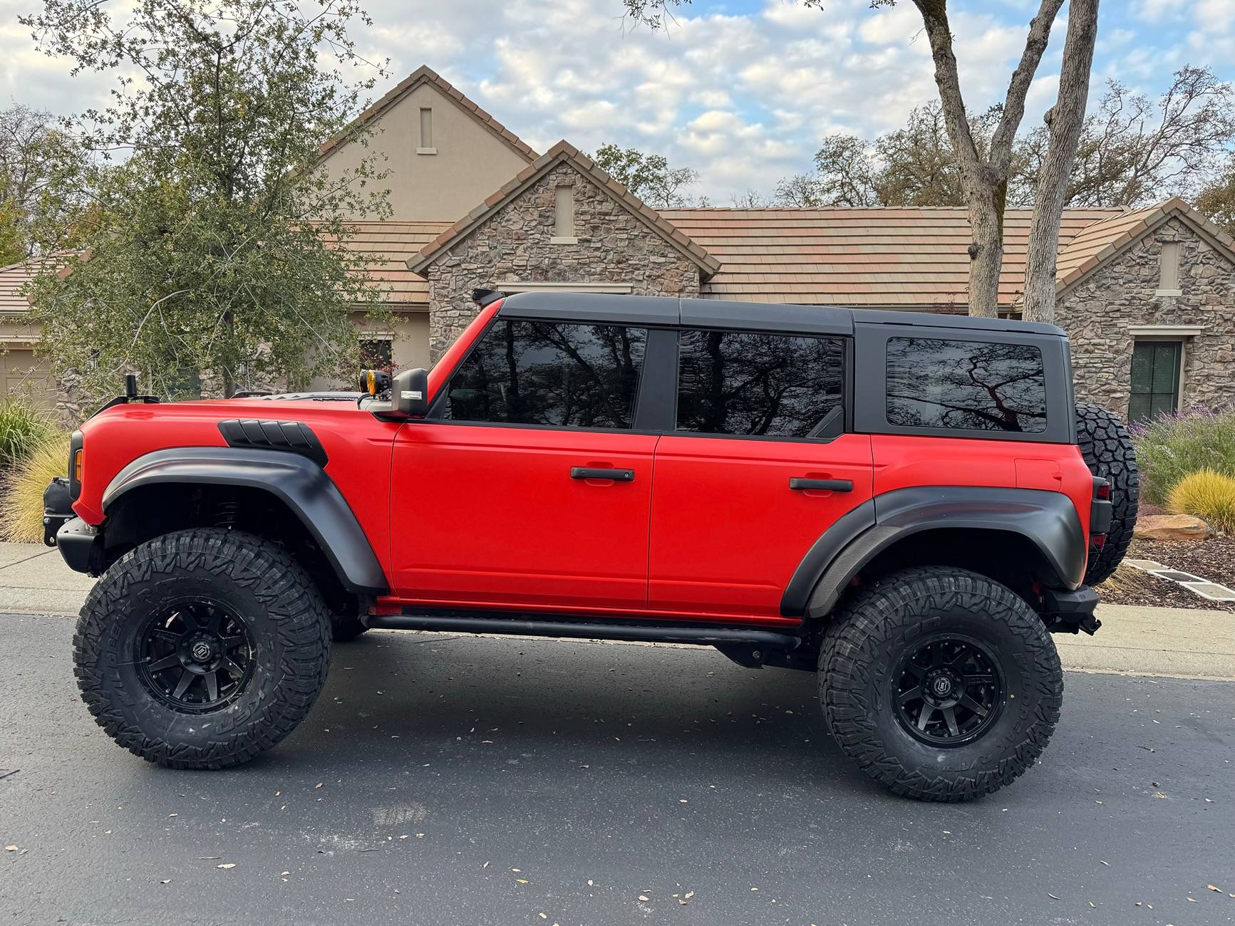

I went 38s and did the Eibach kit. Rides great but the rear springs are really soft and any weight in the rear makes it sag and sit lower than the front. I’m debating on perch collars with the Eibach springs in the rear just to bring it back up a little bit for when I’m fully loaded. My wheels are +6 offset and they sit perfect with no rubbing whatsoever.
Ford Bronco Braptor lift 2435507126359178891
Ford Bronco Braptor lift IMG_0710

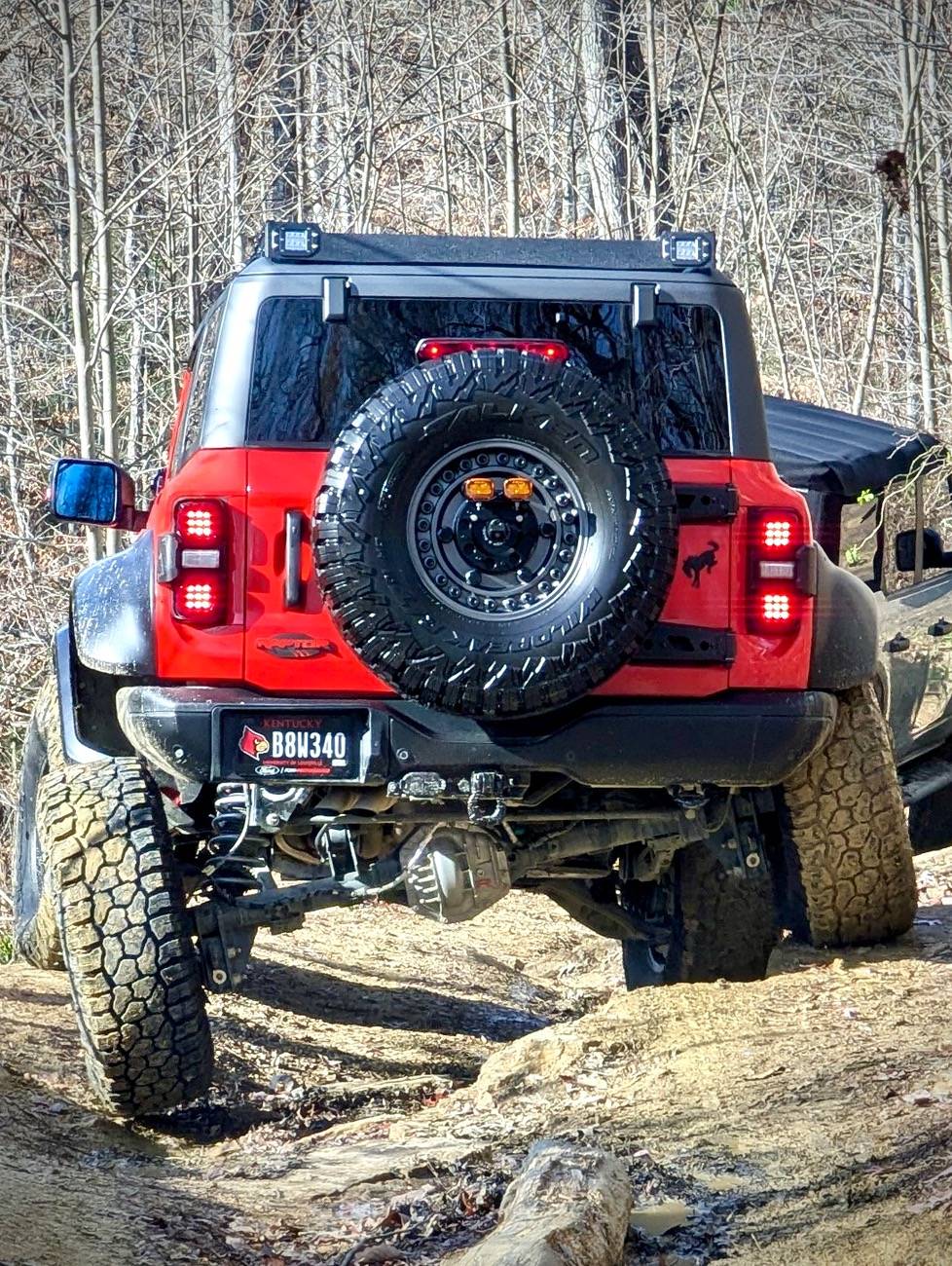

Hyperco 2”/1” springs, 38x13.5, Falken R/T01, +6 rims. Sits level, clearances are good on road and when flexed,, ride is still good, but not as plush as stock tires and springs. Gas mileage and acceleration are down a bit. im happy with the mods, but there’s no free lunch going with bigger tires.
Ford Bronco Braptor lift IMG_5664

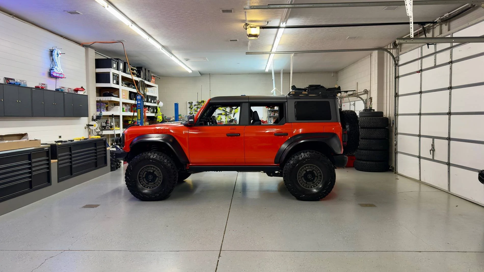

I run Foutz collars, true 37s, 1/2" body lift, 0 offset 17x9 12.50s. This can run 38/39s with no issues you can also increase the collar sizes.
