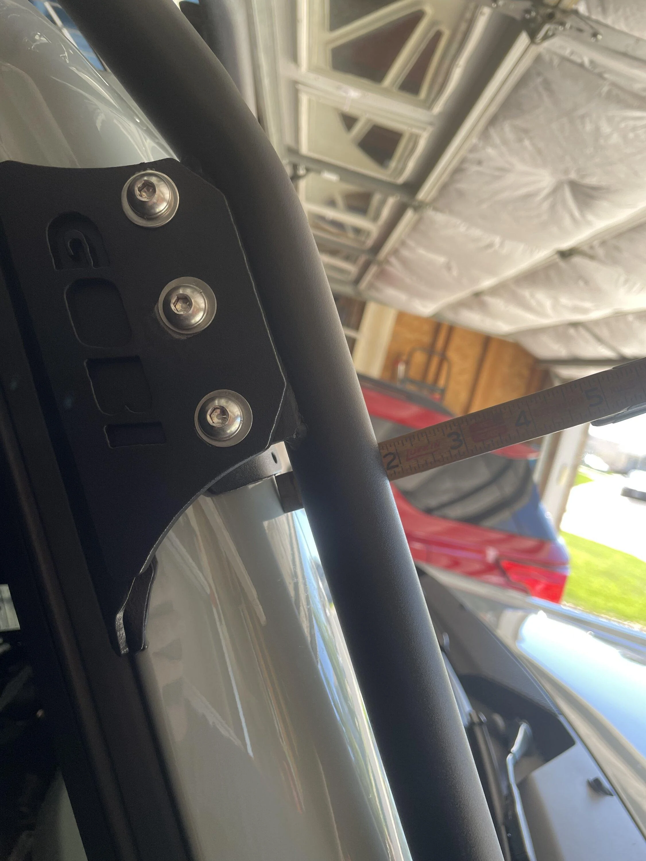

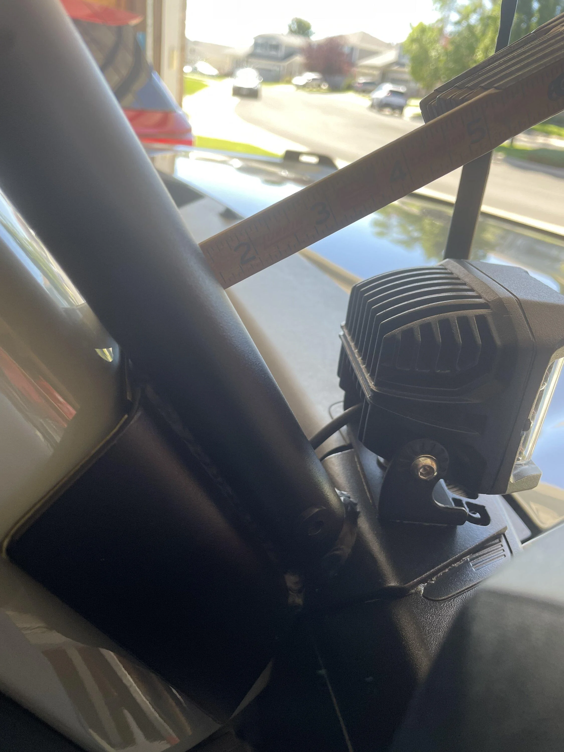

Nice! Mounting point is flat enough for stacking. My concern really is the clearance issue. Here are a couple more shots showing how far out the front support is.

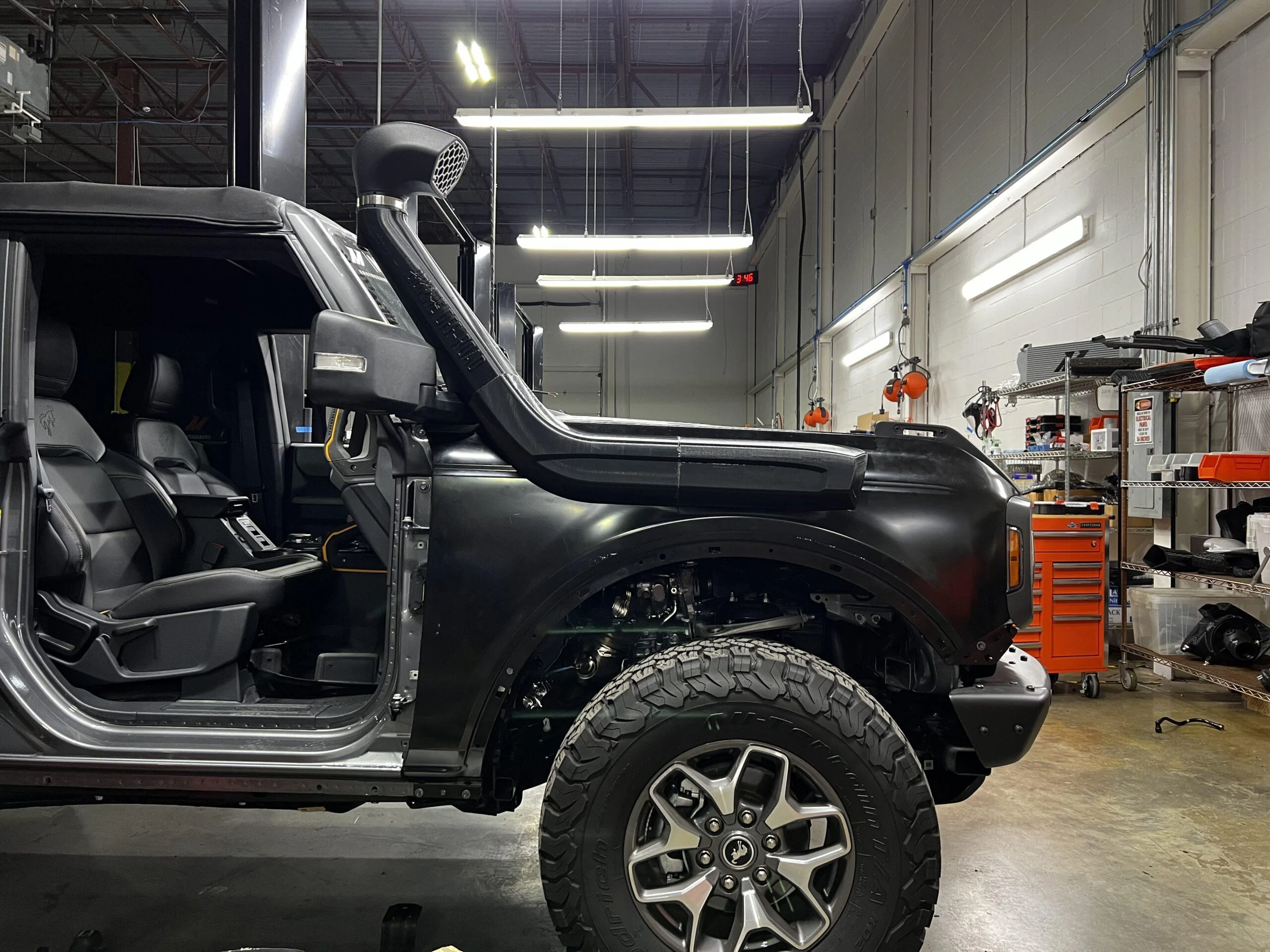

I was just chatting with Ye about this, and clearance from that bar shouldn't be an issue, this photos is from our second design after moving the snorkel tube back a smidge:

I'll grab measurements once we have the production sample in the shop and installed

ohh.. I would hope you are able to tuck that closer to the window pillar... otherwise it will make an blind spot where one is not desired...

So, because of the way the Bronco is designed, any snorkel routing over the mirror arm will be visible from the driver's seat and create an obstruction. While we always aim to avoid creating a blind spot with our snorkel designs, it's unfortunately inevitable without some serious modification
As for the gap, there's also a method behind this. While snorkels aren't designed as performance additions, or, well, they're aimed at a different type of performance, we don't want to detract from the Bronco's airflow, which entails keeping a large cross-sectional area while reducing the number of curves and bends in the system, like hurdling over the mirror arm.
Now, with all of that said, we did make some adjustments to our final design since, admittedly, we weren't too keep on such a large gap either, and moved it closer to the A-pillar. I'll have more on the final product later this month!

We don't anticipate any interference with the rack. We did adjust the the snorkel tube's placement, but there's still space for the rack. The rack does use the same mounting point on the upper cowl, so you'll either have to stack the brackets or, in the worst case, need a custom bracket for the snorkel
