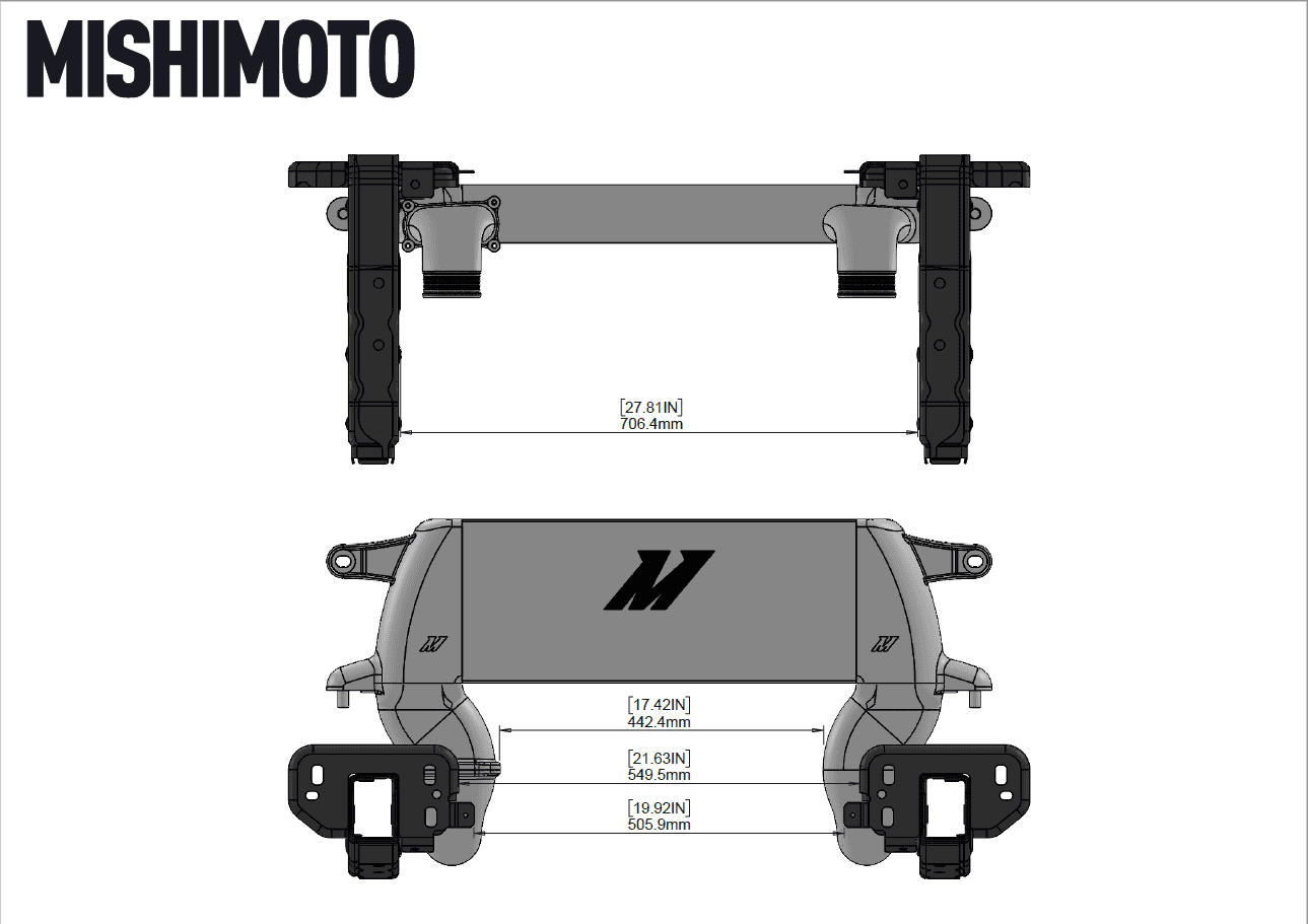

Will this diagram help people know the dimensions between the front frame horns and Mishimoto high-mount?
- John
This is awesome. However, I think the top image is incorrect as the intercooler sits back a ways from the front frame horns. Can we get this dimension also? The left side is probably more important as I'm sure the flange for the air pipe bolts decreases the measurement. This will tell us the depth we have for a winch.
Hey @brokentwig - The intercooler sits quite close to the front frame horns. Scope installed pictures in Post #174, #175, #81, and #1. Shoutout to @cvd2486, @BAUS67, and @Bronkers for sharing their installed pictures!
- John

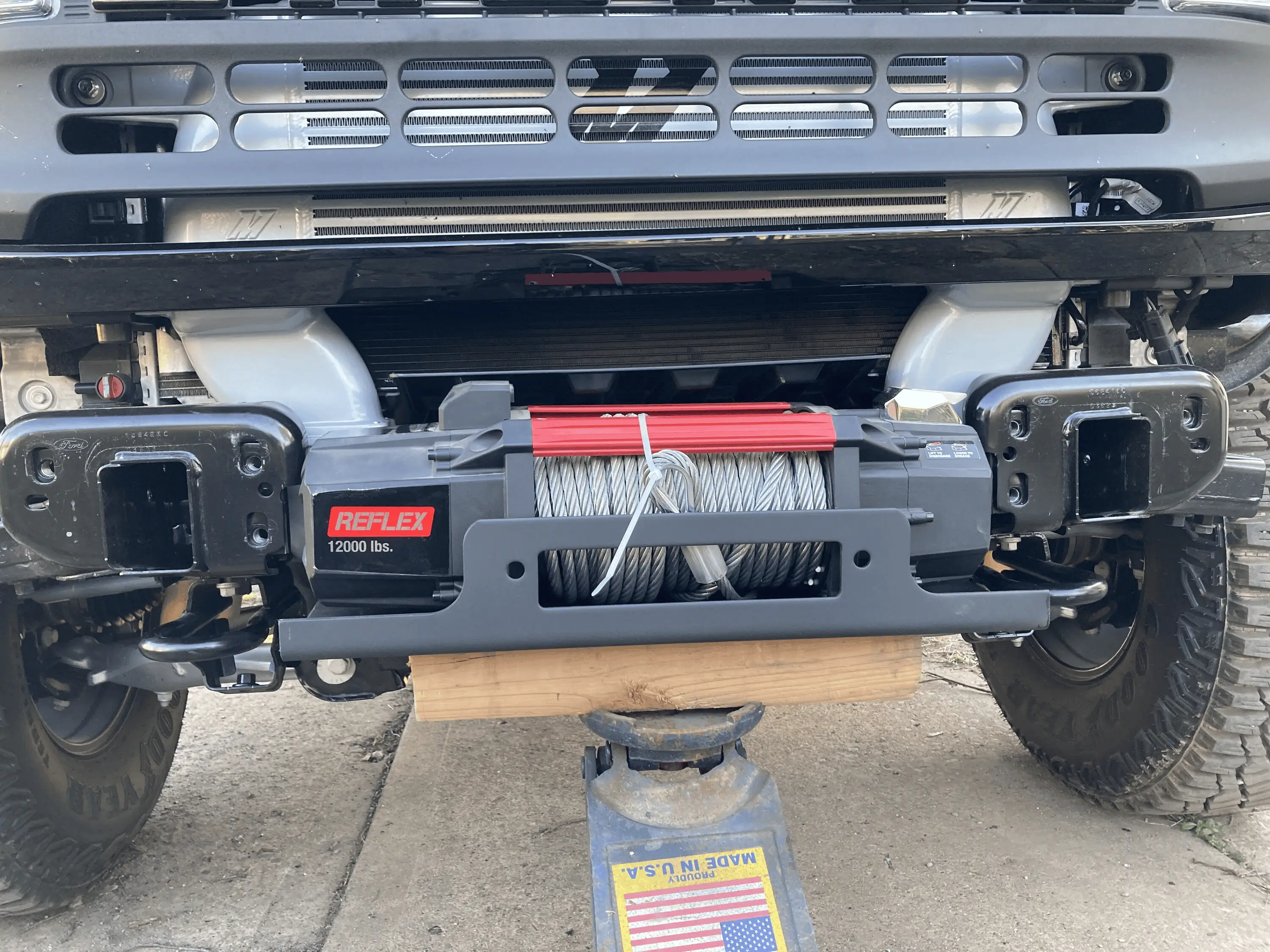

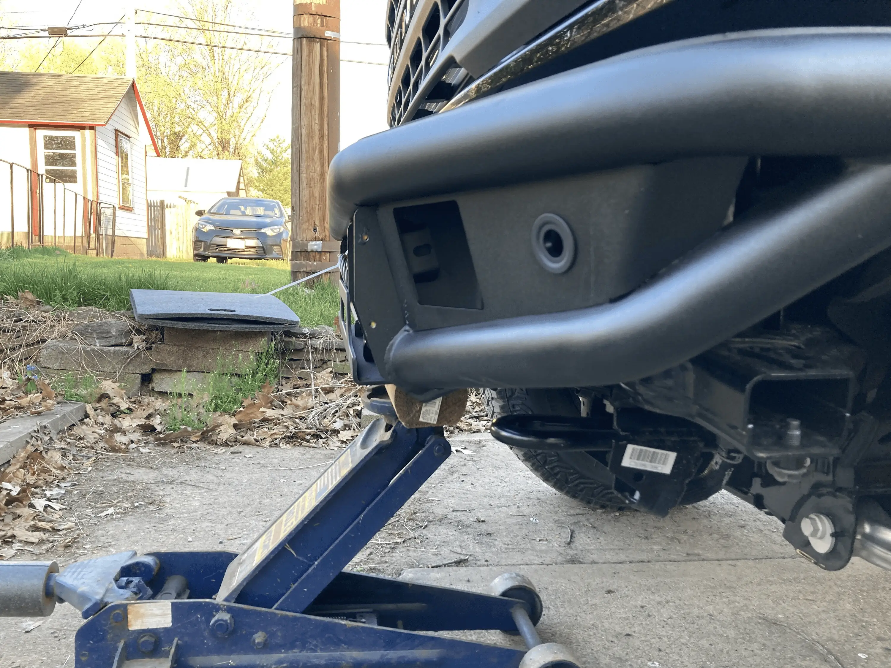

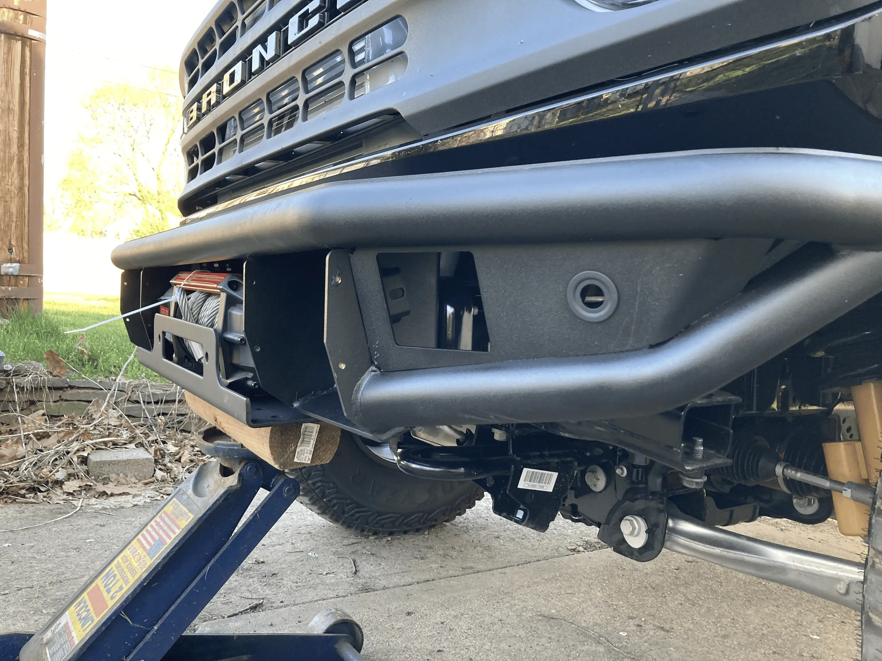

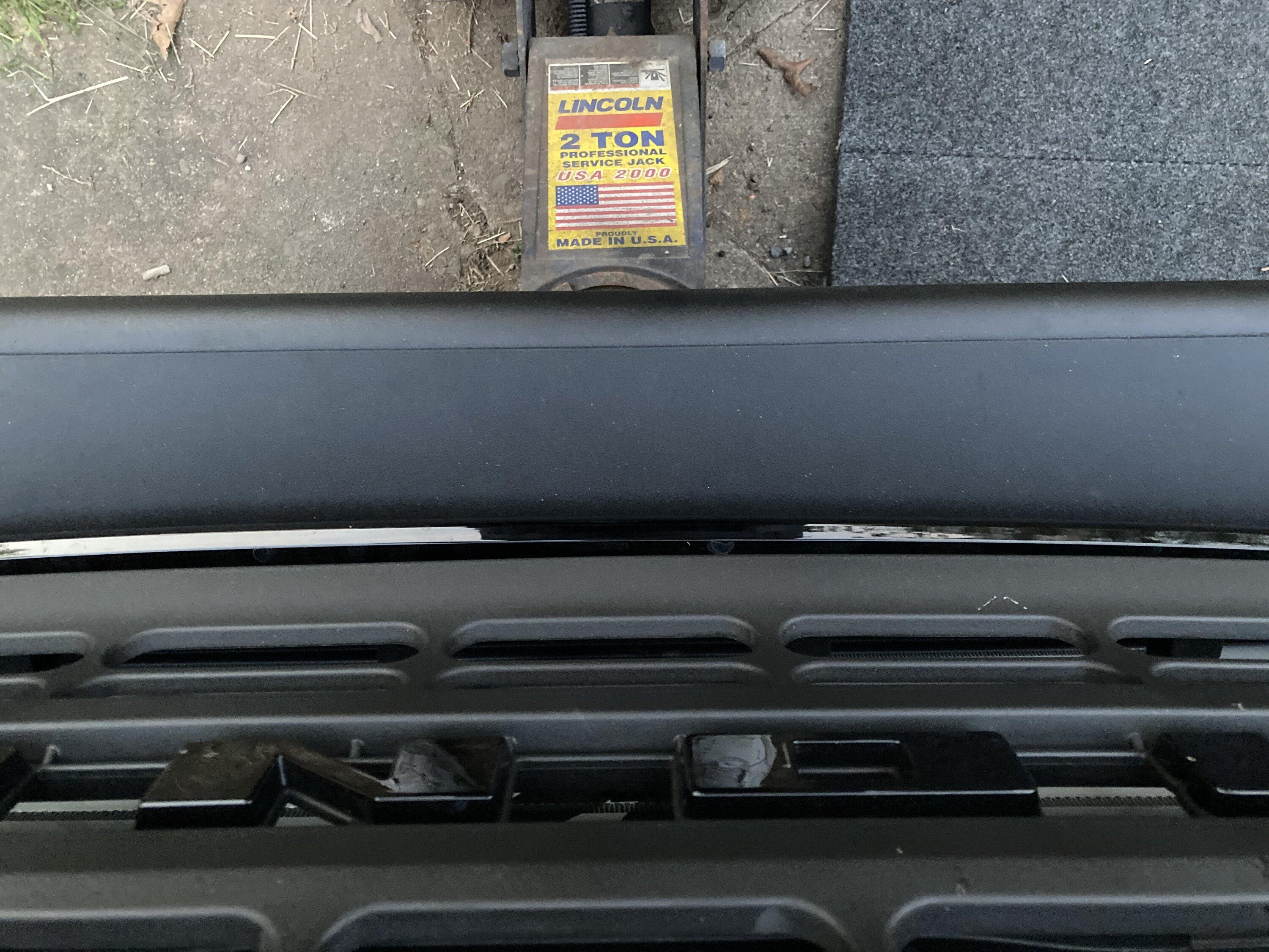

I will have that dimension tonight after work. It is much closer than in that photo.
Ford Bronco Mishimoto's Performance Intercooler R&D Thread 1681405092708
Ford Bronco Mishimoto's Performance Intercooler R&D Thread 1681405105695

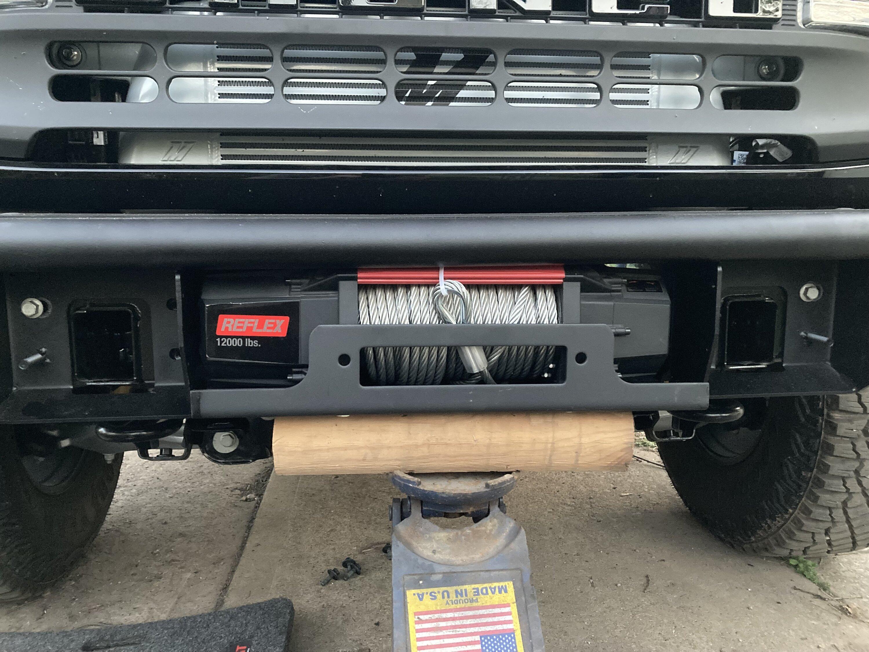

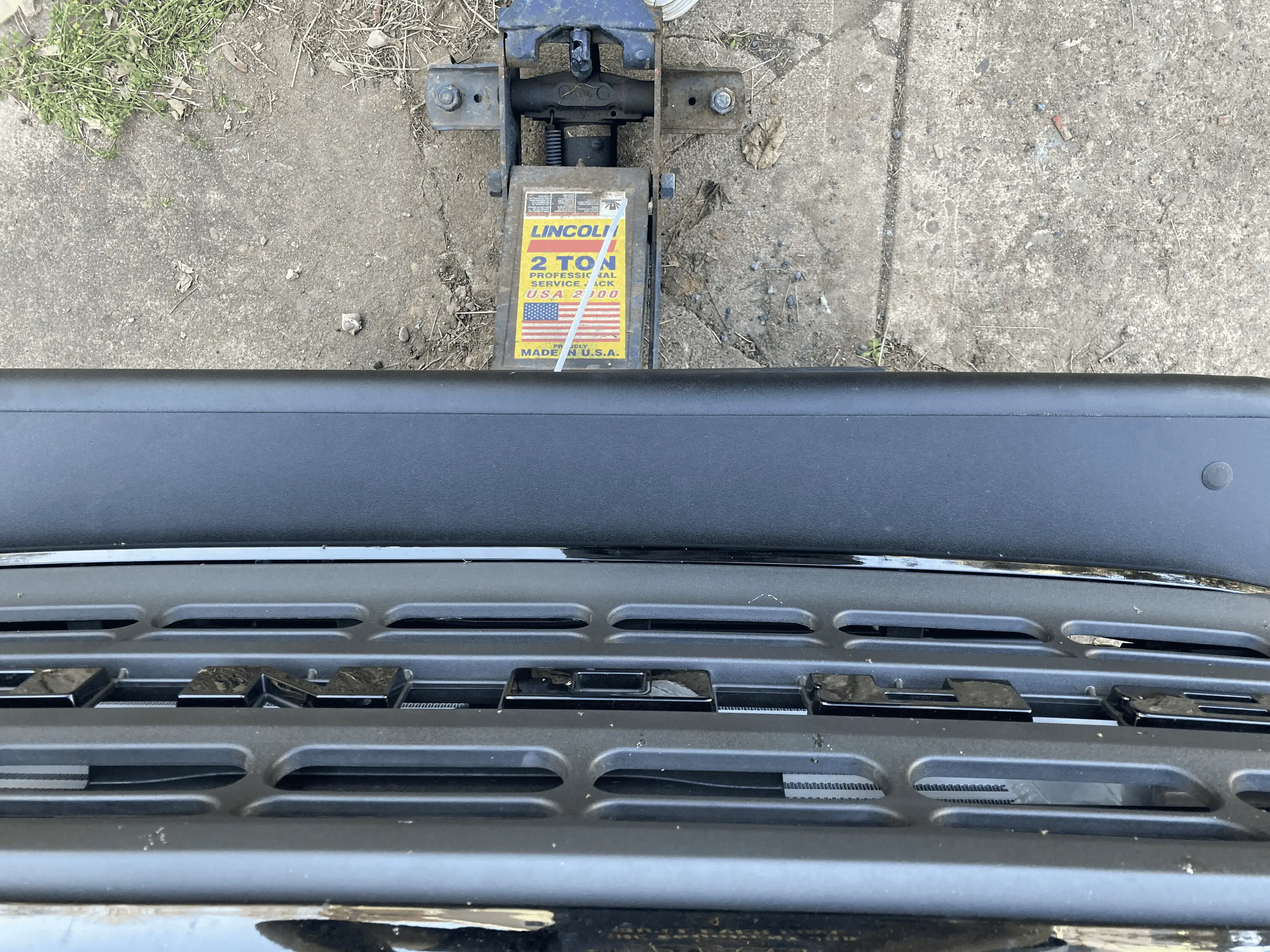

These are close up shots I was just getting last night and posted in my build thread. I will get better shots tonight. The shiny black thing in the pic is bumper pads.
Here is a front on shot.
Ford Bronco Mishimoto's Performance Intercooler R&D Thread 1681405244445
and this is with the my bumper on.........I still have some small areas I can trim to get it tucked in there better. Honestly I was quite pleased with this first shot at it considering I was just going by pictures to mock things up at first. It is deceiving, it looks like there is not any room but when you hoist the winch up in there it seems to fit nicely.
Ford Bronco Mishimoto's Performance Intercooler R&D Thread 1681405367309
Ford Bronco Mishimoto's Performance Intercooler R&D Thread 1681405384403
Ford Bronco Mishimoto's Performance Intercooler R&D Thread 1681405400312

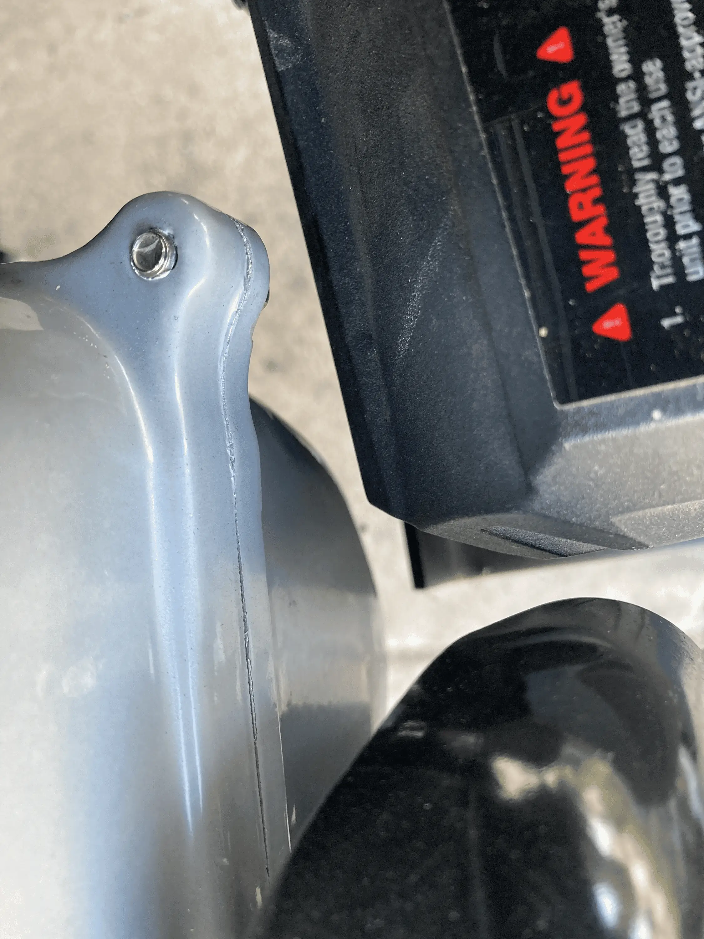

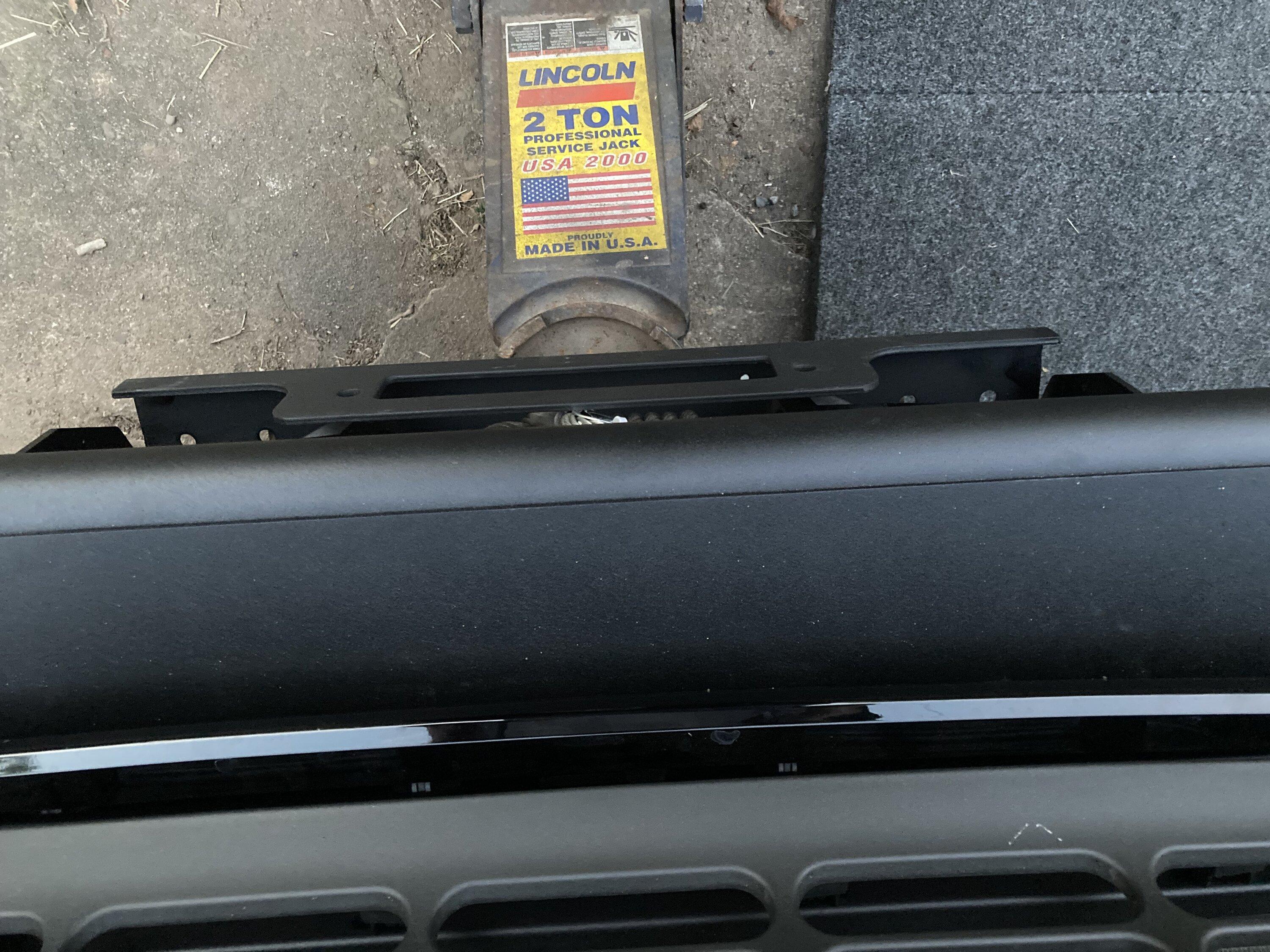

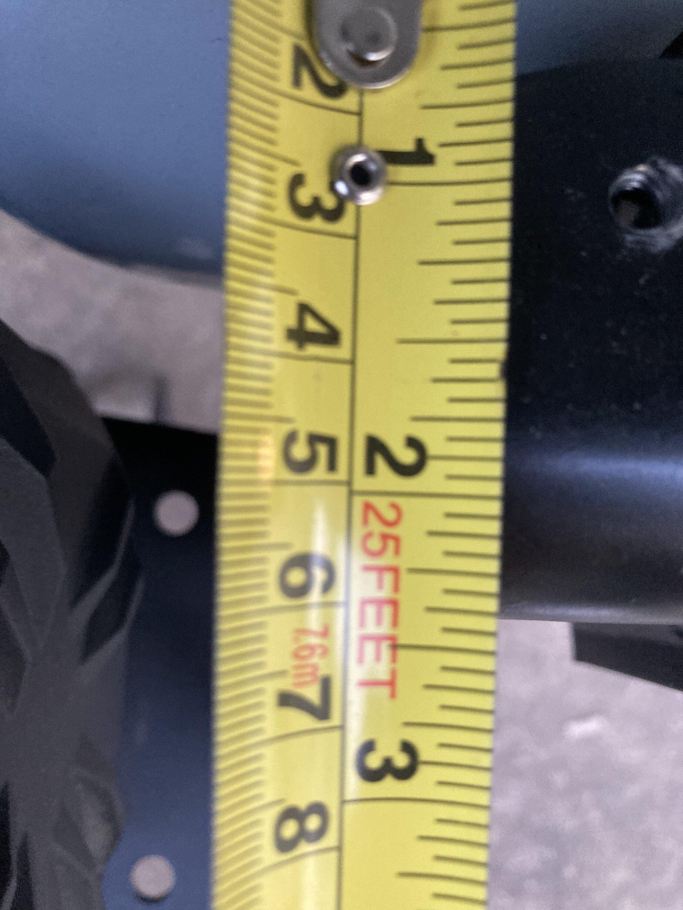

Here is a shot of the front of the bumper pad to pipe measurement.
It is hard to get the camera in there to take a pic but this is the best one. I looked without trying to take a pic and this is accurate. The front of my pad is 2 3/8 from the pipe. This would be were an aftermarket bumper starts. The bumper I used has like a pocket where it bolts to this pad. similar to the OEM MOD bumper, so it makes room for the winch without killing the approach angle.
