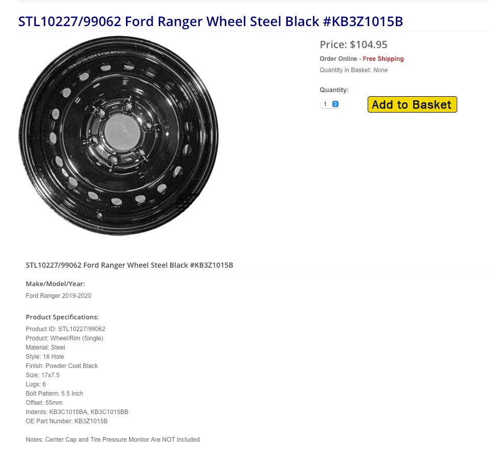

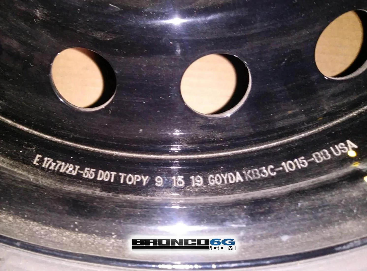

Here is a picture from the factory of the 17" steel wheels... exact same numbers as the Ranger steel wheels... Makes me think that "same as the Ranger" is a safe assumption!
::EDIT:: Link in post above to Levine confirming that steelies are shared across platforms.

Hopefully you are correct....but the number is not the same, unless I am wrong. One has a "Z" while the other a "C".
My understanding is that figure in the part number only refers to what "division" that part number came from or something or other.
Furthermore there are subsequent part numbers listed on the Ranger wheel that match exactly what the Bronco wheel has stamped on it.
