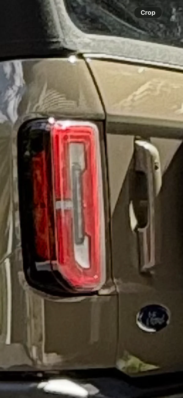

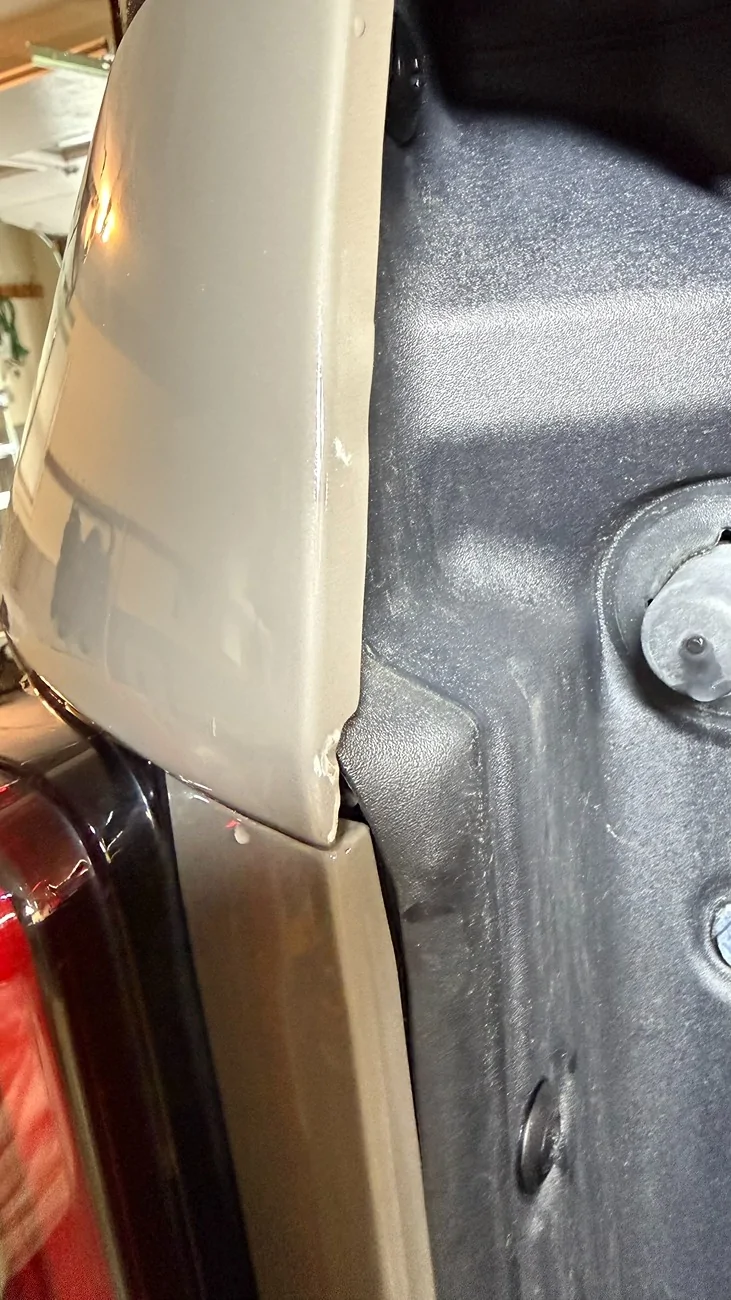

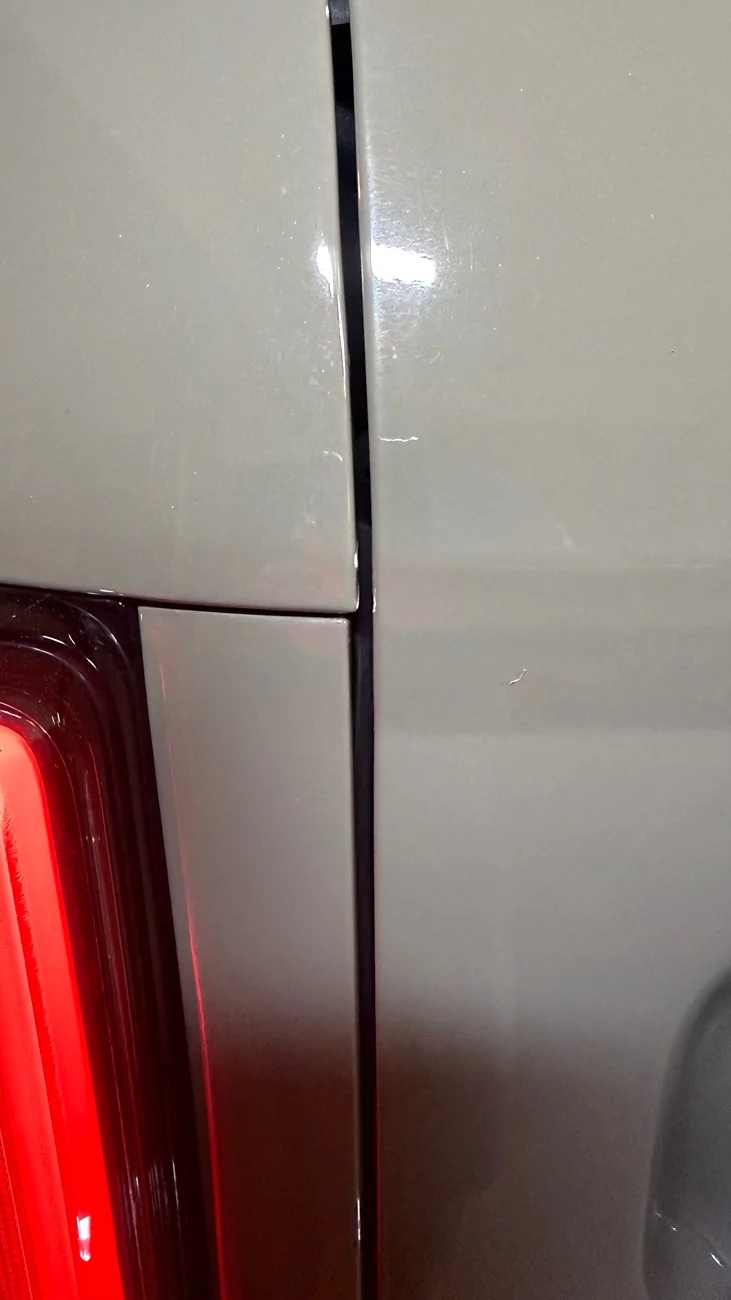

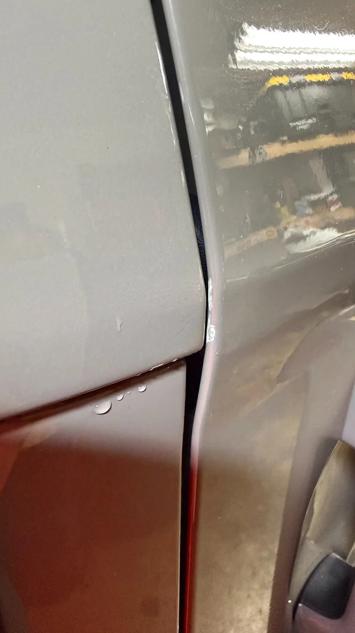

Im curious if anyone else has experienced a tailgate and rear fender alignment issues? Ever since day one of ownership ive noticed the terrible tailgate and panel alignment. but i just kind of overlooked it/accepted it as not really worth bringing up and having to sit at the dealership on my day off to have it looked at. However recently i noticed there must have been actual contact because im noticing paint chipping starting to occur. I loosened the bolts a little to see if there was any adjustability to be had there, but i guess the adjustment is where the hinge actually attaches to the chassis. Anyone else have this issue? Will Ford fix this under warranty? Its a 2025 with less than 8,000 miles on it.
hard to see the paint chipping in the pics.
Hard ro believe that got out of the factory like that. Are you the first owner? Positive it wasn't hit before you had it? If you bought it new you may have a case but I'll bet the dealer claims its "too late". Check the fender bolts under the hood for witness marks from a wrench having been on them. That panel fit looks more emblematic of an accident with repair at the Stevie Wonder school of Body Repair than a manufacturing defect.

Yes sir. First owner. Factory ordered. Tried to find a picture of the rear. But this is the best I could do. I zoomed in on a picture I took. Hard to tell but you can see how close it is. This was day one of ownership.

Wow. That's pretty disappointing. Definitely file a warranty claim with Ford. My '23 Big Bend has pretty decent panel alignment although the gaps are a bit wider than they could be. The paint however is thin and chips very easily. Shines up decently however. Mass production doesn't get you much these days.

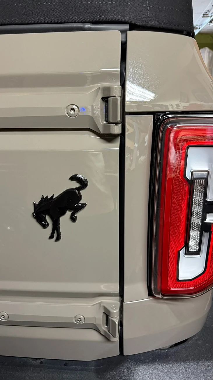

1. Tailgate centered (left to right)
2. Bottom of the tailgate sucked into the truck (ie that means your body panel alignment towards the bottom of the tailgate will not be flush to the fenders....but slightly recessed)
3. Top of the tailgate pushed back, ie tailgate slightly protruding from the fender.
My tailgate is exactly how you described, it’s a bit of an eye sore but it works as intended, so I’m iffy about messing with it. Is there a reason why Ford has it set this way?

So I was able to adjust it enough to calm me down. I removed the strut first, then cracked the tailgate bolts loose and just gave the spare tire a bump with my shoulder towards the passenger side. It slid over about half an inch or so. Which is all I really wanted. Torqued it back down and I’m happy with it for now. Annoyed that I have a paint chip but that’s easy enough and it’s in a very not noticeable spot.
