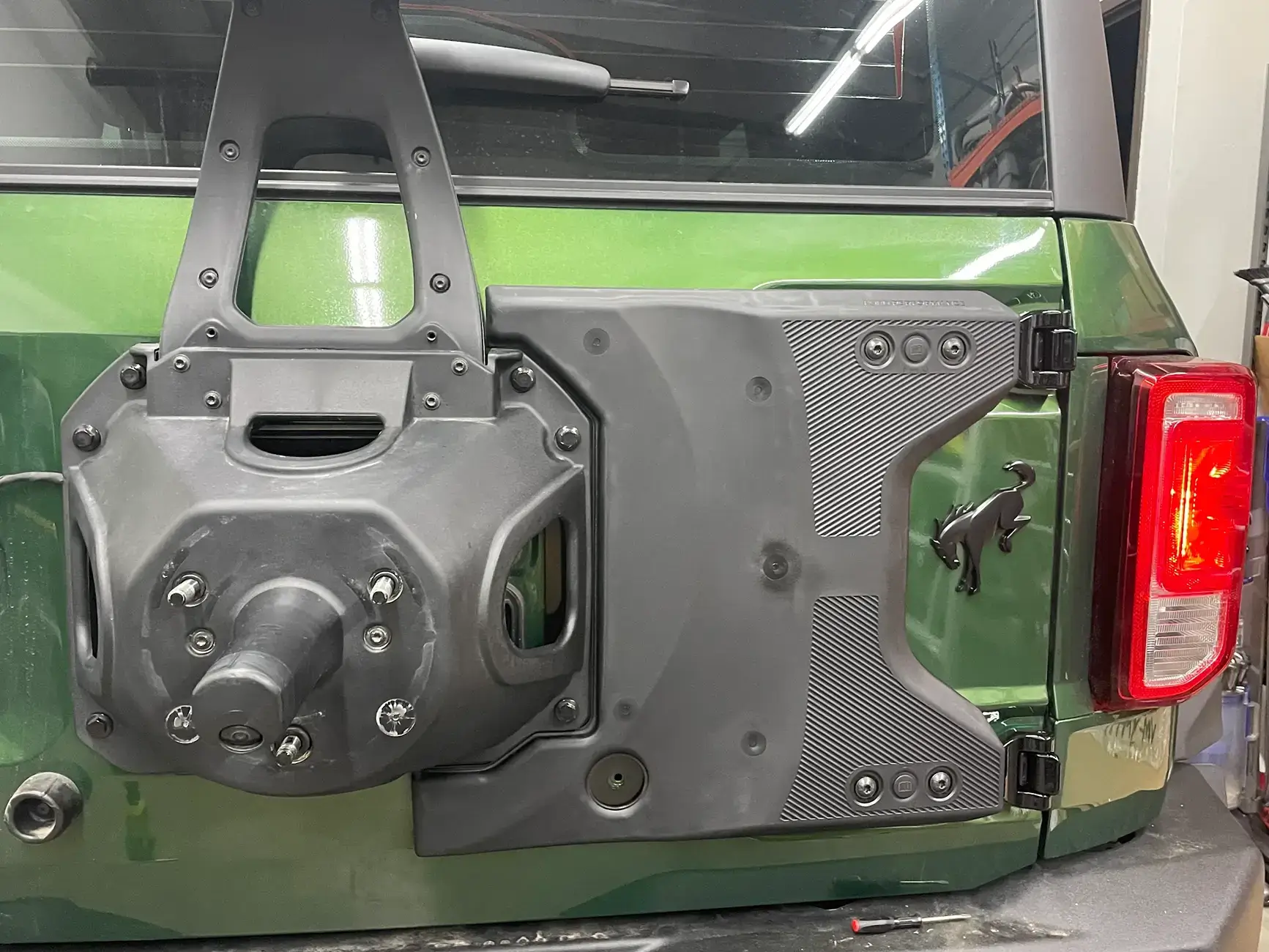

My experience on alignment:
- Staring at the tailgate from the rear of the vehicle:
  1. The tail can be adjusted left/right...ie sliding to the driver side or sliding to the passenger side.
  2. The other axis of adjustment is depth....ie, how much of the passenger portion of the tailgate can stick be pushed out (away from the truck) vs sucked in.
  3. And the 3rd axis of adjustment is rotation....ie how much the tailgate can be tilted forward (top of the tailgate pushing into the glass and the bottom of the tailgate pushing away from the truck) vs tilted back (top of the tailgate pushing away from the glass and the bottom of the tailgate pushed in)
- You do not have to take off the entire tailgate, just loosen the bolts.
- You'll want something to support the end of the tailgate if you're working by yourself
- You must test with the spare on after making adjustments (or if you have a friend to help you, leave the spare on.
I stared at a bunch of tailgates at a local Ford Dealership after experiencing lots of clunking when I reinstalled mine the first time. For the most part, they all seemed to be setup as follows:
1. Tailgate centered (left to right)
2. Bottom of the tailgate sucked into the truck (ie that means your body panel alignment towards the bottom of the tailgate will not be flush to the fenders....but slightly recessed)
3. Top of the tailgate pushed back, ie tailgate slightly protruding from the fender.
4. The upper latch engagement (the mechanism that actually locks and unlocks the tailgate)...it's not completely centered. It's biased towards the bottom half of the latch...meaning, expect slight contact with the bottom portion first when closing...it should still close smoothly. This is with the spare on the tailgate.
