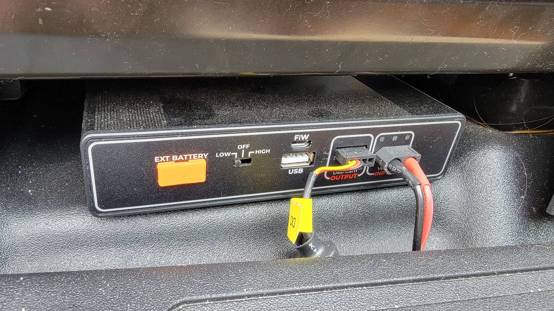

Anyway. I'm looking to run my dashcams 24/7. They'll pick up motion/impact etc and wake and record a minute before detection. What I really want access to is ability to log in anytime and get live view (and therefore, yell/communicate with a perp, etc).
Have a secondary battery, so that's not an issue. And this setup is currently working for me... albeit this: as you've mentioned, after 30 minutes or whatever, the vehicle sleeps. So I have onboard wifi, to make all of the above happen, but that shuts off when the vehicle sleeps.
Sorry, this is getting wordy. I'll leave it at this for now. I need a solution to have the onboard wifi stay on.
Currently - $10 plan with Bell via Ford (shares my current 300gig phone plan)
Probably need to: get Inseego mobile data device. Cons - TERRIBLE data plans. Pro - can have it run on secondary battery 24/7.
Option 2 - 2 simcards (front and rear camera) with mobile plans EACH. Also expensive.
