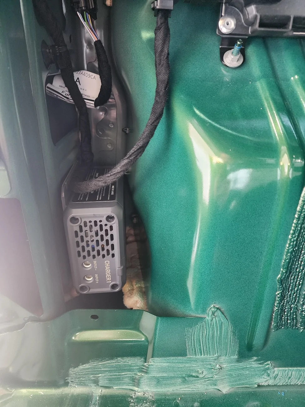

Finally got a break in the rain. Found the perfect spot behind the drivers side cargo area panel. Works like a charm. Put in an Anderson 45 port in the small removable panel. Will attach pics in a bit. Added a headless HAM radio in the glovebix area with the mountains to metal mount. Now to wire up the starling then I think most of the wiring stuff will be done. 😂
I thought about that spot, but it doesn’t meet the airflow requirements (about 7” space around all sides) in the document.
I've had it in and connected to my AC180T for over 2 weeks now no issues what so so ever.

I am most likely going to move it there. How are you dealing with the circuit breaker on/off? Or do you just leave it on all the time? I currently switch it off when not using it. Looks like the Charger2 removes the break, adds a fuse. and might have a better on/off feature? but more power.. more heat..

I just leave it on. But I am only pulling 27v from the car so as not to cause issues with the alternator.
