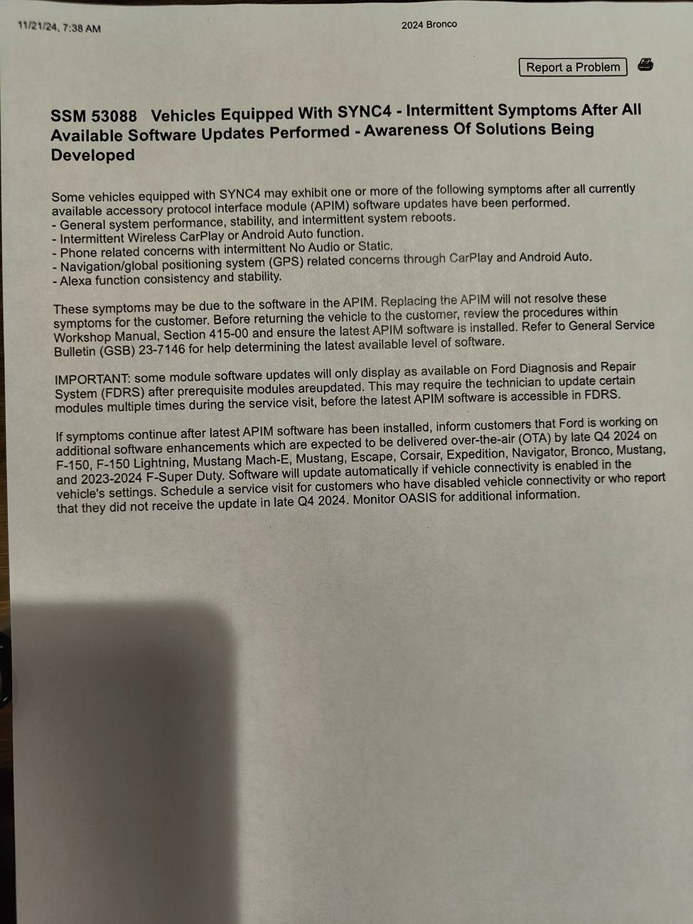

Same issue here with my 2022 base model. Android phone, works great for everything except phone calls; no one can understand me. Issue started after a software update a couple months ago for the car. Issue persist through Android auto and regular Bluetooth.
Wkronfeld
William
Jun 7, 2022
Colorado springs
3x 2021 Bronco sports, 2021 bronco first edition
Got an update from Ford. They are aware of the issue and are working on a fix. No idea on the timeframe, though they claim by the end of Q4 2024. Seems to effect all 21-23 broncos. 24s seem to be unaffected.
