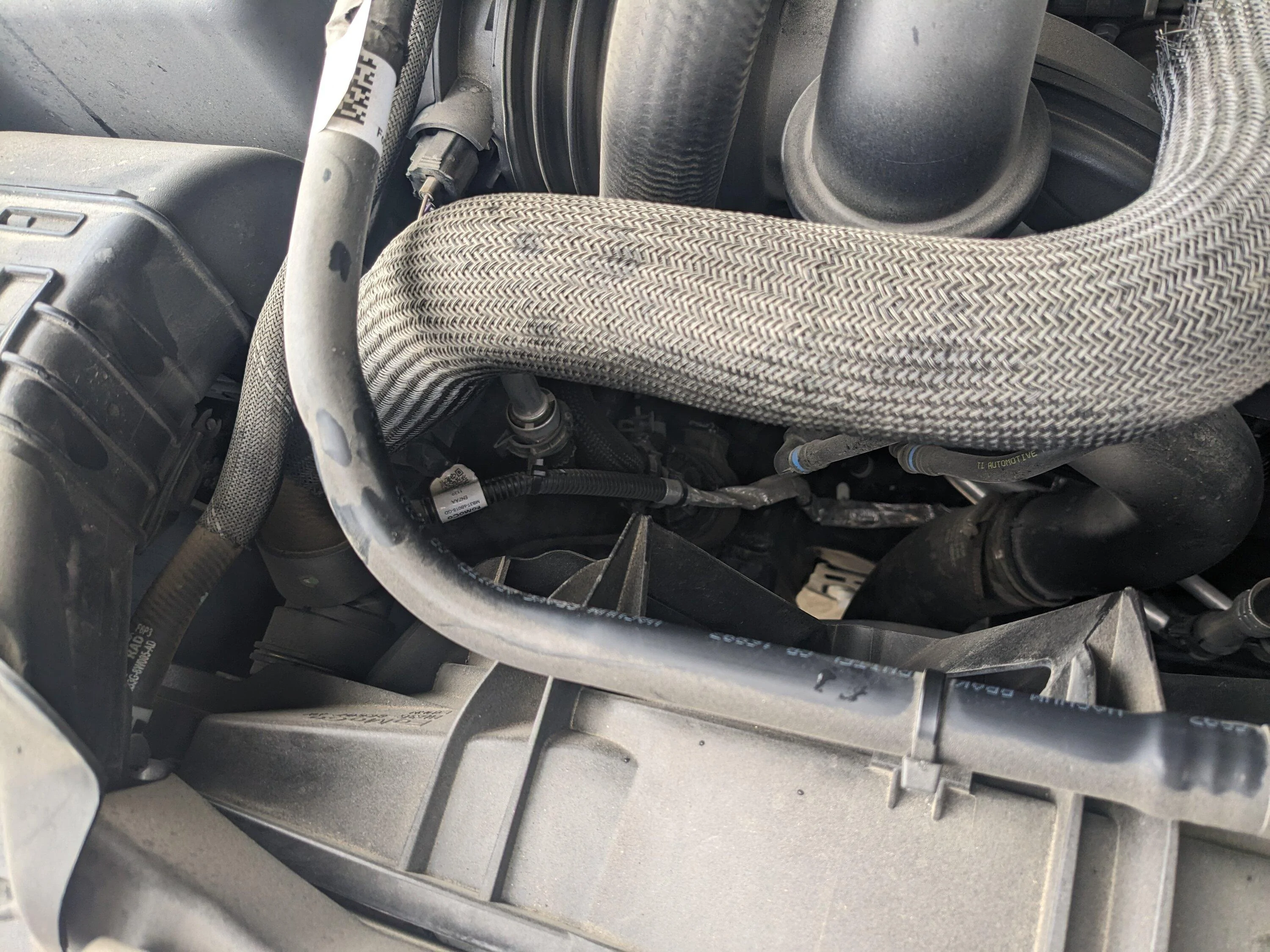

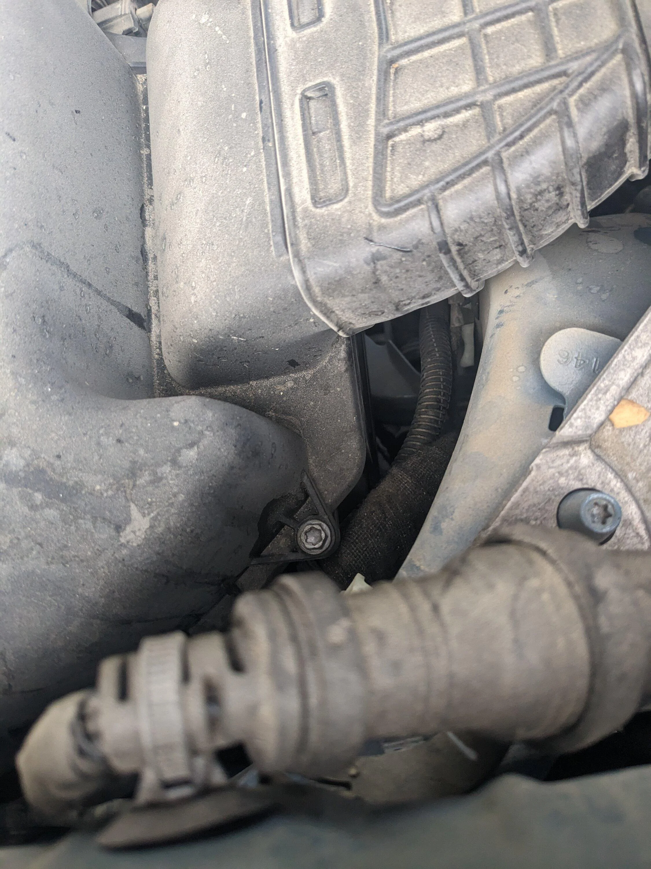

Anyone out there with a 2.3L that can shoot some pics of where the wire is routed?
It's a little hard to get good shots but hopefully these help
Ford Bronco Block Heater Cord PXL_20230104_223040280
Ford Bronco Block Heater Cord PXL_20230104_223115006
Wire goes down just in front of the air box
Ford Bronco Block Heater Cord PXL_20230104_223126921
And picks up on the other side as the one with the white lable that transitions to foil wrapping.

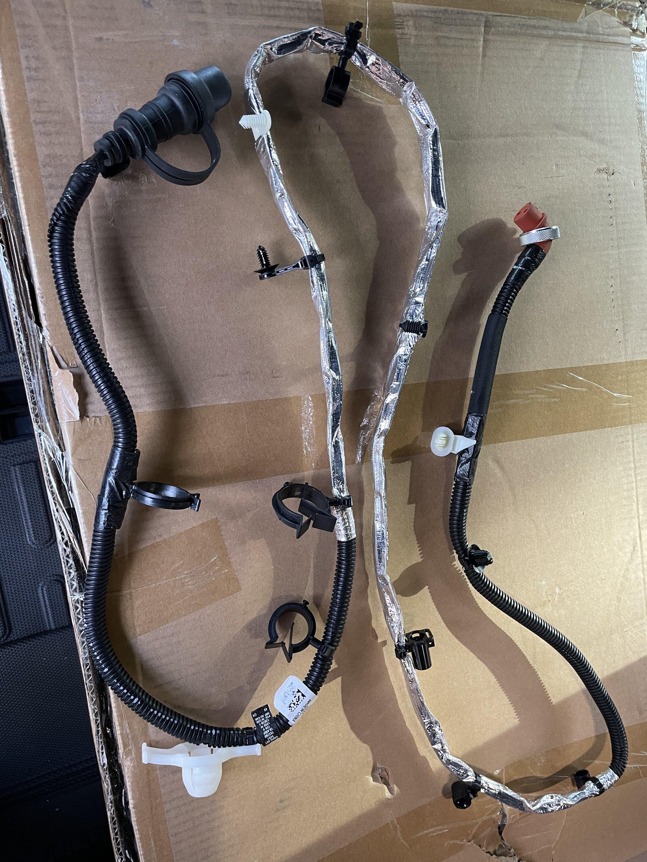

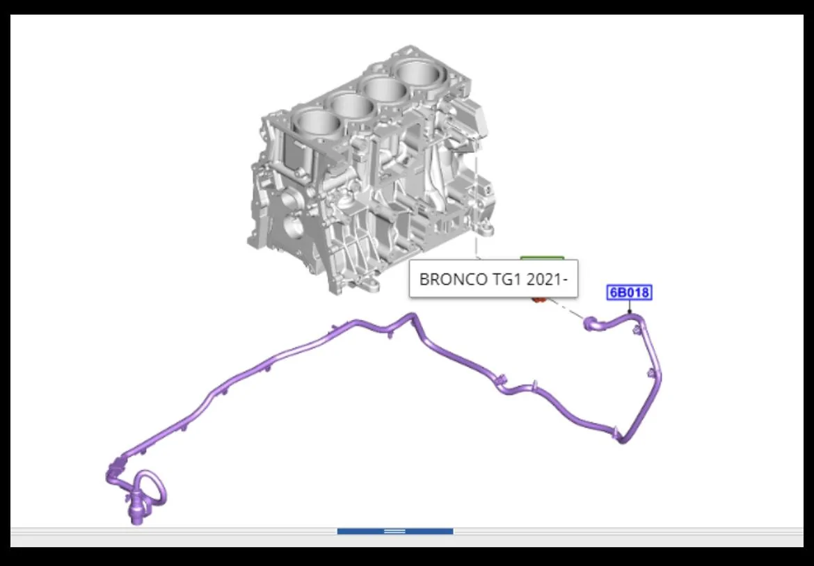

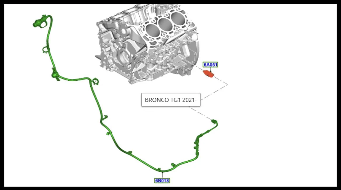

Thanks @BlueOvalBandit - is yours manual as well?
It seems like there are two cord part numbers - depending on if it’s Auto or Manual. They also get routed differently. Which is bizarre to me. I assumed it was 2.7 vs 2.3 - but, I seem to be wrong there. I need to check if the cord ending in A is also compatible with the 2.7/Auto.
Ford Bronco Block Heater Cord B166F021-BB22-4D16-8CE6-8F4EC32255A7
Ford Bronco Block Heater Cord 25DF4928-7CCA-4E46-B20A-7B3F6ADF81B3
Ford Bronco Block Heater Cord 24715B3A-1CBD-4577-97FF-B55D9105231D
I’d prefer to route it like the first image. But, the part number for the 7MT is the one that has all those funky retainers and it’s the one the dealer ordered for me. Which also has your images confirming where it should be routed - from the driver side of motor to the front passenger corner. Seems redundant.

Ok, that’s what I assumed. So, presumably that second image with the blue cord is ONLY representative of the 2.3L with Auto. Also assuming that 2.3L/7MT & 2.7L/Auto are routed like yours.
Can anyone else confirm?
I am currently planning to route it differently - because I want the receptacle on the exterior of the vehicle. I haven’t yet figured out how/where - but, deciphering the cord differences and factory routing was my first step.
I’d be really interested in finding someone with the 2.3L/Auto to chime in…

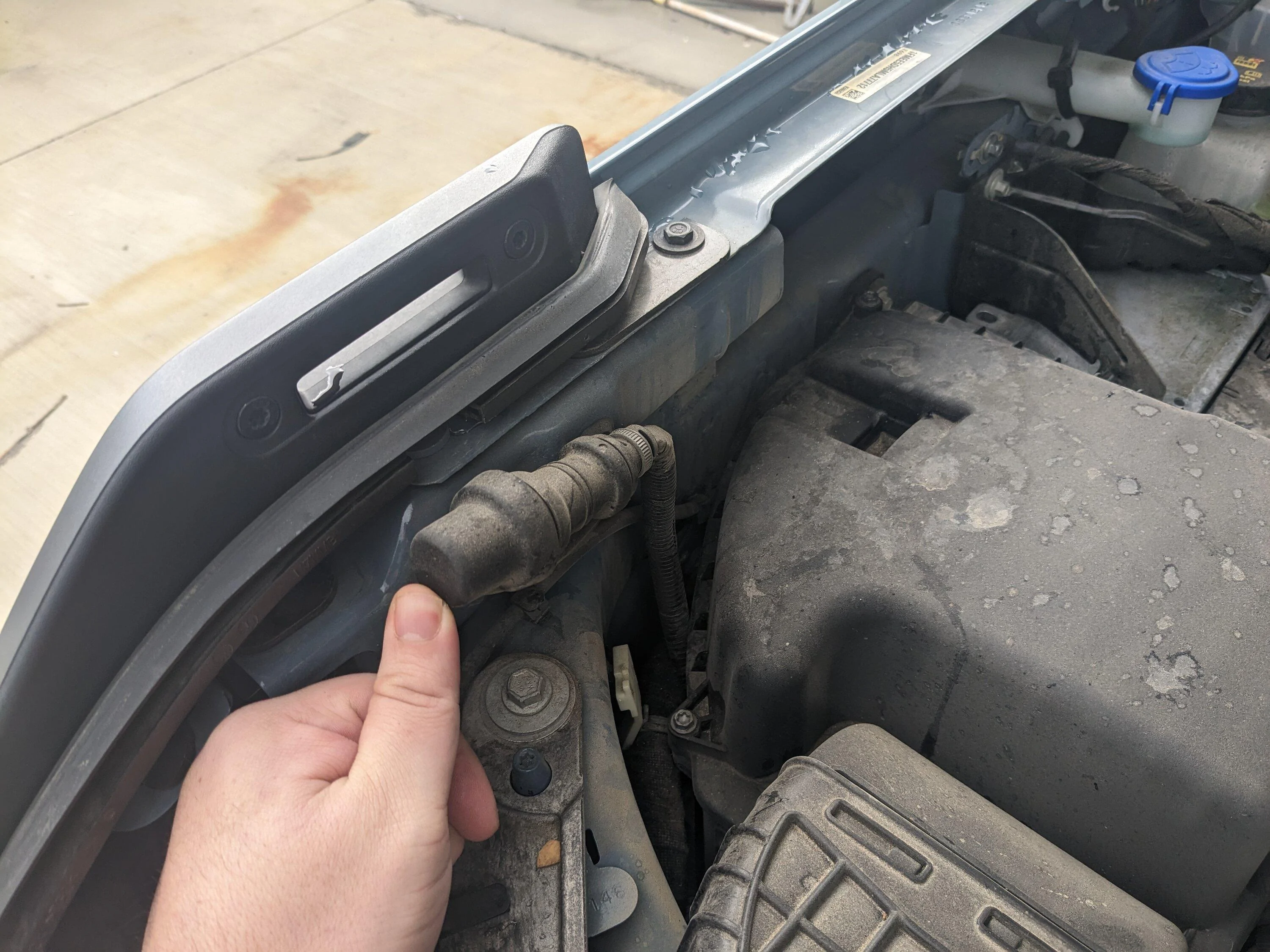

MNBigfoot
Nov 13, 2021
3,967
8,982
MN
I have the 2.7, I unclicked the top 4 connectors ran it out the bottom of the engine bay, though my tow hook (plastic bumper) and zip tied it. 10 minute job, don't need to unlatch the hood now. It should be about a 3 minute job to put it back to stock, as no fasteners were removed.
